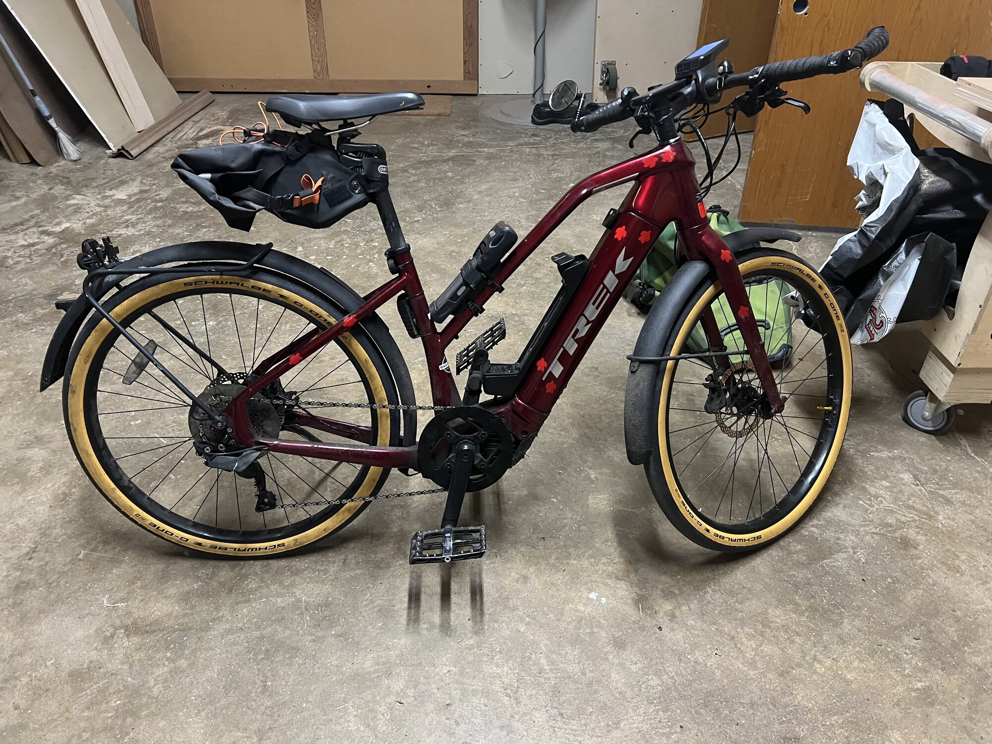

I am doing my 8 I am going to go with 2" tires. you have to make a trip to the dealer to adjust the tire size. though they may need automation to do so I will find out soon. https://www.schwalbetires.com/Schwalbe-G-One-Speed.
Now I had good luck with flat out in my tires. it plugged few flats. after 3000 miles it sealed the tubs so I idd not have to add air either.
looks like there is plenty of range to set the tire size. I am playing with it now. huge improvment over the stock tires in ride and acceleration.
these bar ends. once I started riding 200+ miles a week I needed hand relief. so the bar ends and bars are covered in high end really cushy bar tape. took me a lot of trail and error to get to tape to stay put. its not ideal but it works for my hands. I noticed my black fingers from changing the tires got on the sidfewalls. oops.
ok tire size within a tenth of a mile comparing my garmin and bosch overall distance 81.5" works mearing the tire with my weight 82.5 is what I come up with so no dealer adjustment needed.
