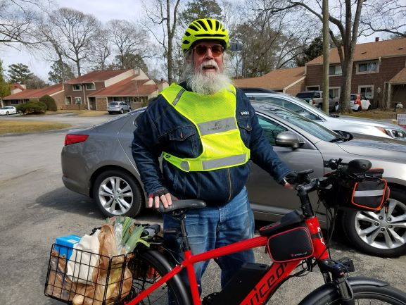

How many pounds of food in your picture?
In my case, I could get away with an ordinary pedal cargo bike. The return ride is straight downhill. I need brakes, not power.
Two baskets full. Veggies, milk, canned goods, cereal, etc. Didn't weigh 'em. If I had to guess, 12-15 pounds per basket.
But if you're asking about weight, you missed my point.
