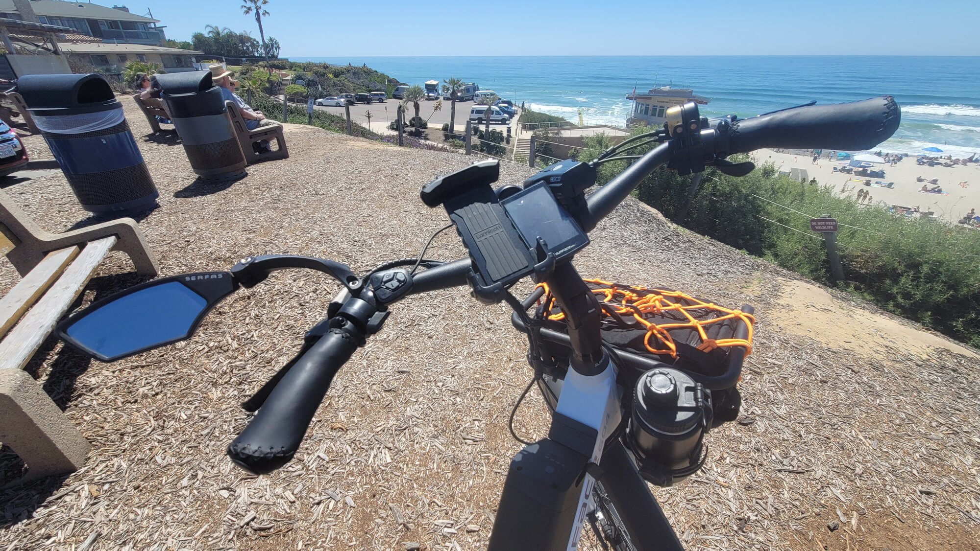

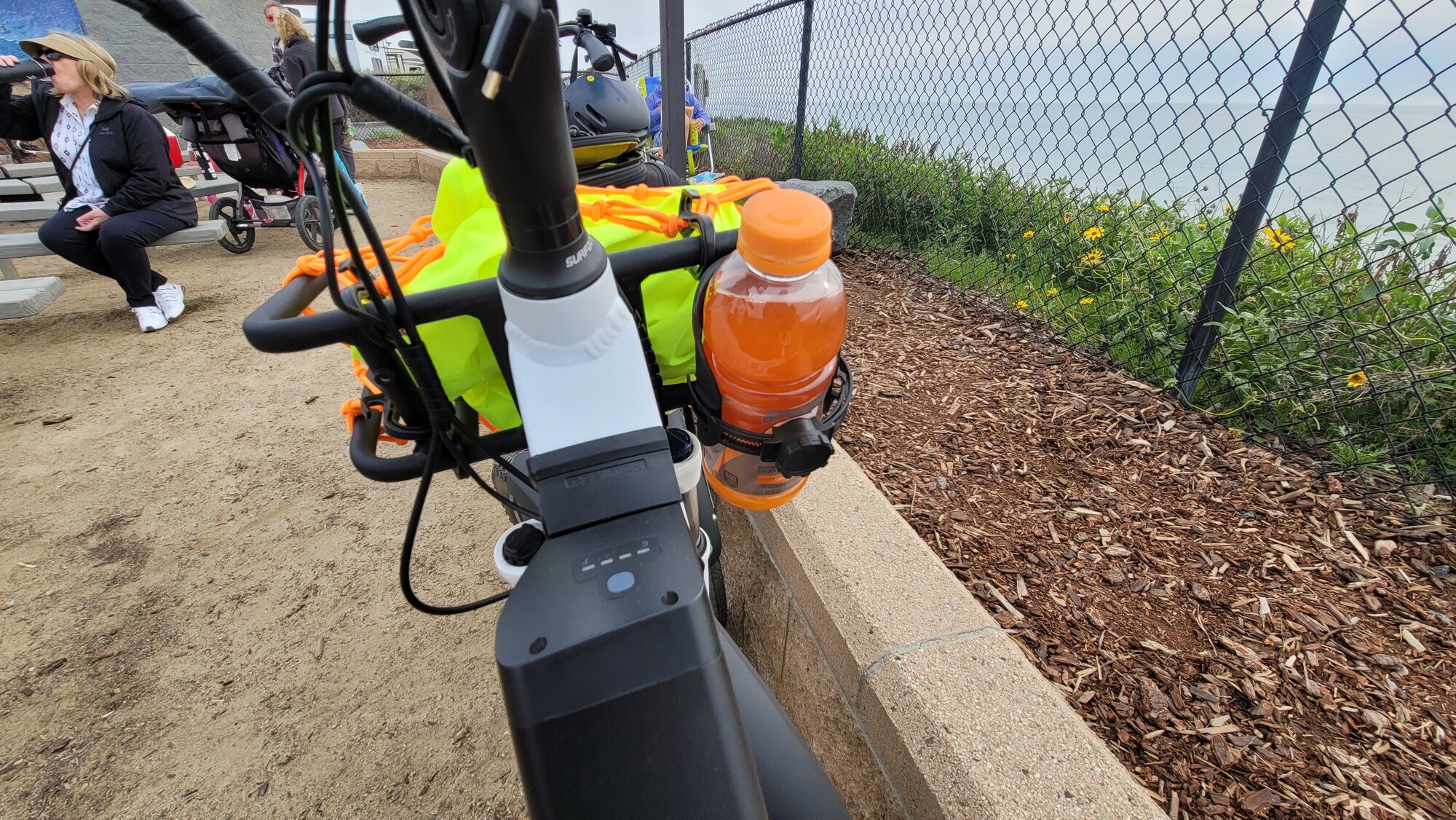

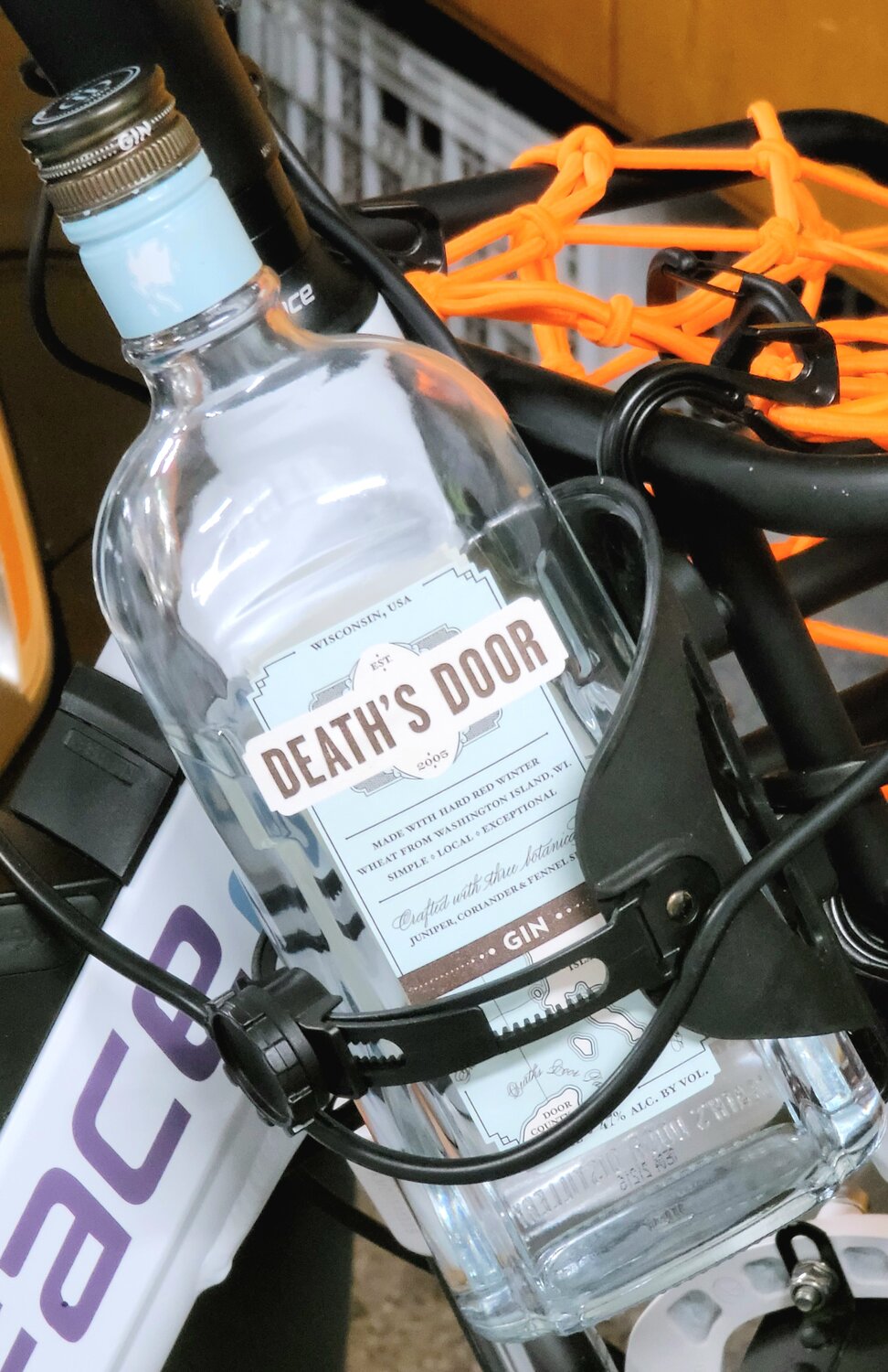

Sturdy, secure, takes any shape container, including a beer/kombucha can, a 28 oz. Gatorade, and a rigid stainless thermos. Regular cages can't take any of these. Mine's still going strong 1.5 years later.

I cinch down more on really bumpy surfaces. Dial in a looser fit to drink on the fly. You control the grip.
Note that standard cages require a flexible bottle wall with the usual notched profile. Rigid containers with no notch (like my stainless thermoses) are no-go.
I cinch down more on bumpy surfaces. Dial in a looser fit to drink on the fly. You control the grip.
Good point on the flexibility
Rigid, straight-walled 16 oz. stainless thermos with sippy cap at bottom right. Rock solid.
Off-the-shelf 20 oz. Gatorade. The 28 oz. also works just fine.
Tempting, but the bottom tab that keeps containers from falling through may not be big or thick enough for something this heavy with a rectangular cross-section.

Thanks for the pix.

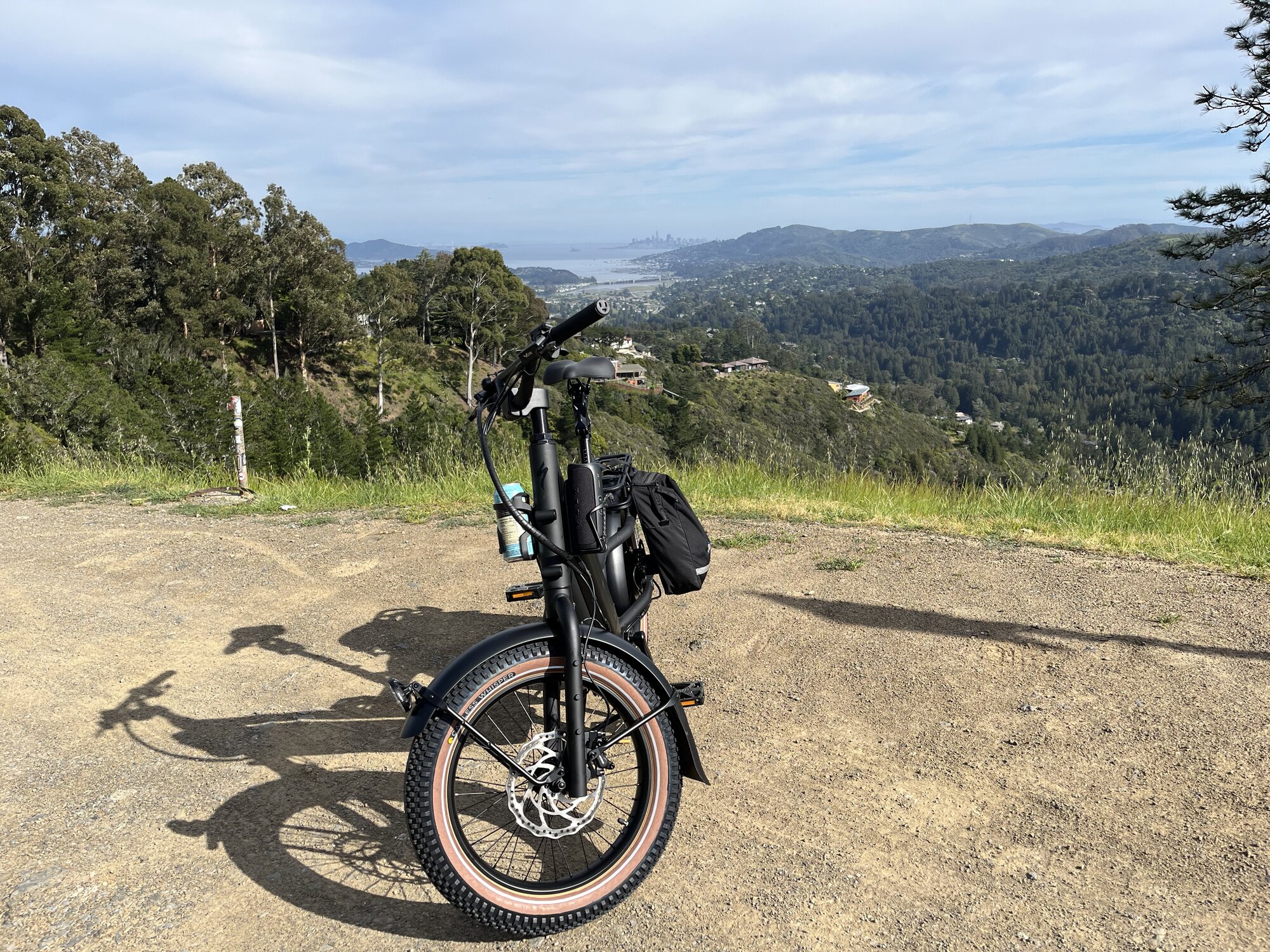

Picked up my Haul today (swapped - in the gumwalls) then took 'er out for a 3+ hour spin around the North Bay area
of San Francisco on a glorious day. (that's SF in the background distance).
Wow! I am SO pleased with this bike. It's just SO ME.Thank you guys for your patience in answering my newbie questions and for giving me good advice on the bike and its components.
(P.S. look at the shadow and you can see that I am riding the Cane Creek Thudbuster elastomer suspension seat - works like a dream. This is the default "medium" elastomer. I bought a spongier elastomer insert as well. I don't think I need it, though..)
