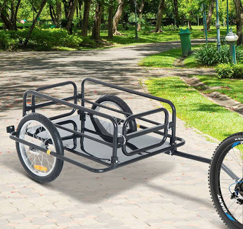

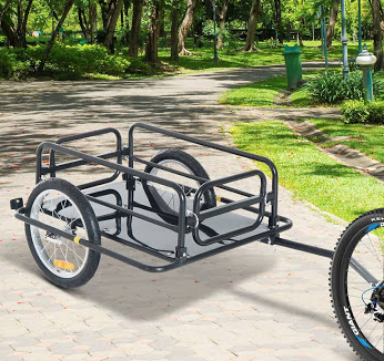

Depending on what you plan to haul, you might want a cargo trailer for your bike ... Screen Shot 2018-07-30 at 12.55.23 PM.png

Depending on what you plan to haul, you might want a cargo trailer for your bike ... View attachment 24084
Yes, I did consider the Burley Nomad. I initially wanted a Trek Super Commuter+ 7. The axle is just 9mm, which I could not believe. It took a lot of research to realize that the Trek Powerfly has a standard 12mm rear axle, that is compatible with Burley Nomad. Trek actually sells the axles, but they are only listed in the store catalog, not online. I notice you attach to the rear axle.
So, the problem with a trailer is the Trek 300 pound weight limit. I suspect some legal liability surrounding a 20mph bikes with a combined weight of 300 pounds. I weigh 210 pounds. The bike is 55 pounds. The trailer is 15 pounds. That only leaves me with 20 pounds of groceries.
But, yes that is best solution for a lighter person.

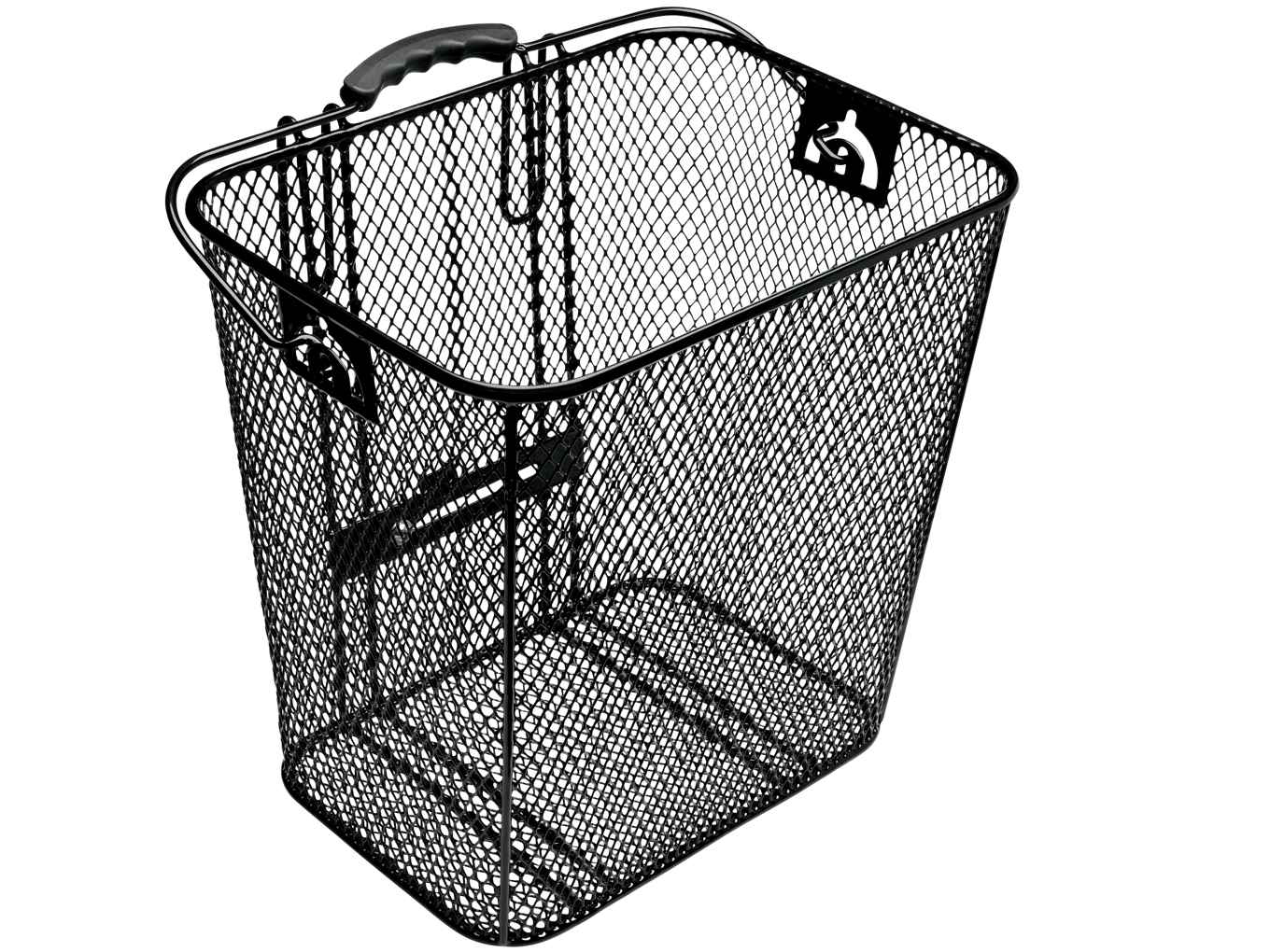

I hope to fit 30 pounds of food into these rack containers, that seem quite small. I would love to hear what you think about the carrying capacity of these baskets and bag.
Bontrager BackRack Disc | Trek Bikes
www.trekbikes.com
Enhance your cycling experience with Bontrager BackRack Disc. Shop now for FREE shipping on orders over $49!
This pannier basket easily attaches any Electra rear rack. is: (12x12x9 in). Unsure whether it attaches to Bontrager Interchange system.
https://www.trekbikes.com/us/en_US/...-rack-pannier-basket/p/12612/?colorCode=black
Electra Steel Mesh Rear Rack Pannier Basket | Trek Bikes
www.trekbikes.com
Enhance your cycling experience with Electra Steel Mesh Rear Rack Pannier Basket.

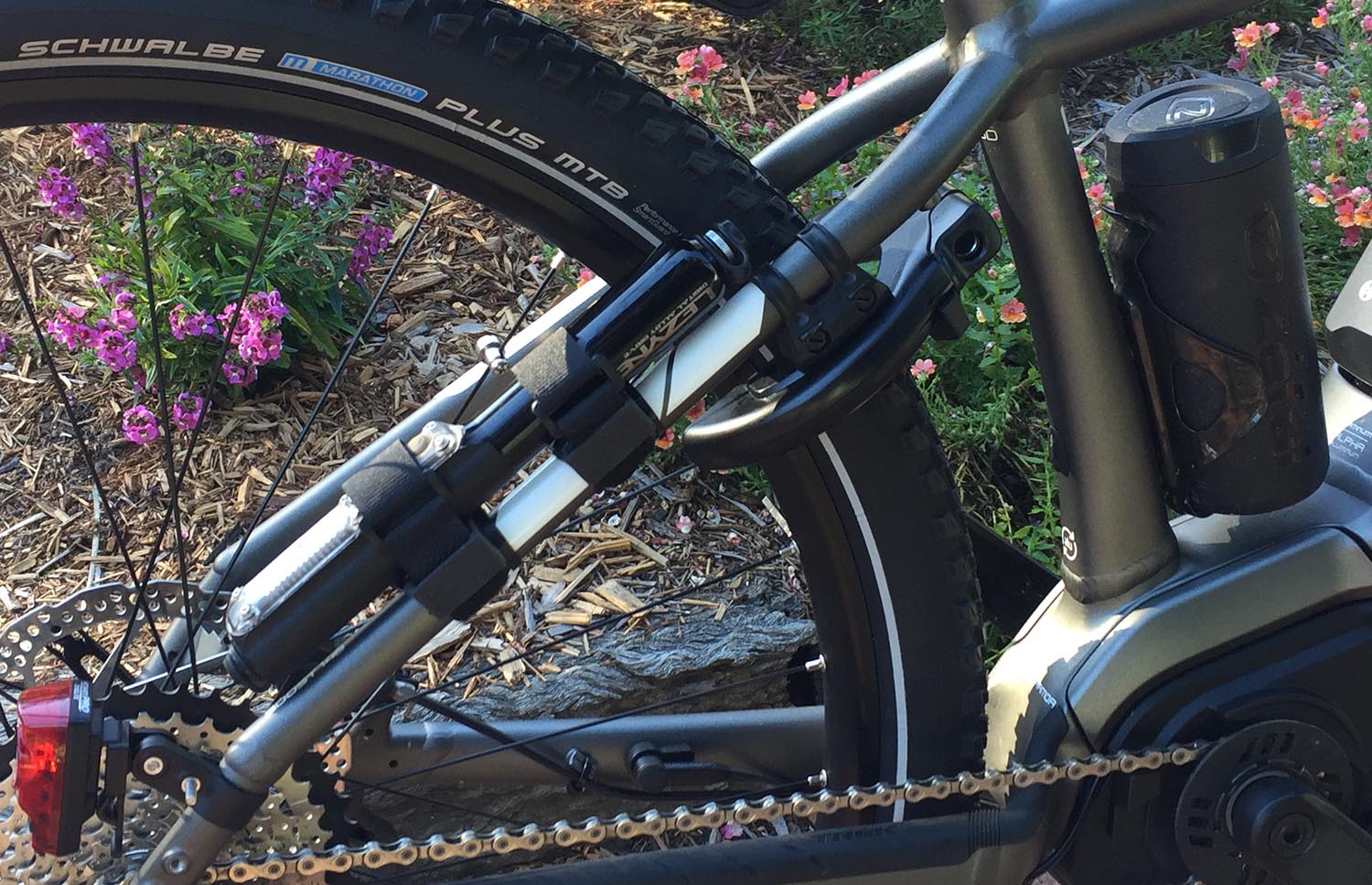

Hello BikeMike,
You have done a remarkable job of researching the Trek Powerfly 5. The best I've ever seen on any bike . There's little I can add, but I'll try.
I own and ride a Trek Powerfly 7 hardtail which is very similar to the 5. I ride my exclusively for enjoyment on hardpacked Rails to Trails and some roads, but no single track 'real mounting biking'...... I absolutely love my Powerfly 7 and would not trade it for anything. It's so much fun, it's solid, very stable and the Bosch CX Performance drive drain will climb a brick wall.
I swapped out the knobbies for Schwalbe Marthon Plus MTB 'Flatless'. I have had no problems. I really like them. I installed a Kinet Seatpost
and would not be without it https://cirruscycles.com. If I have any grips about my Powerfly 7 is the speed limitation of 20mph, but I knew that going in. I also have and ride a Trek XM700+ commuter, again which I love. That's my 'go fast' bike. It's a Class 3 28 mph. Combined I have 3200 miles on both bikes in the last year and I have had zero problems...none.
Lastly Trek service via my LBS is fantastic. I've told this story a bunch of times, but when my TreK Powerfly 7 arrived the handlebar controller
had been damaged in shipment. My LBS contacted Trek, the Controller was backordered. Rather then me have to wait around for the controller to arrive, Trek shipped another Powerfly 7 from Wisconsin to CT and I was riding in four days....Now who does that ? I hope this was helpful.
John from CT

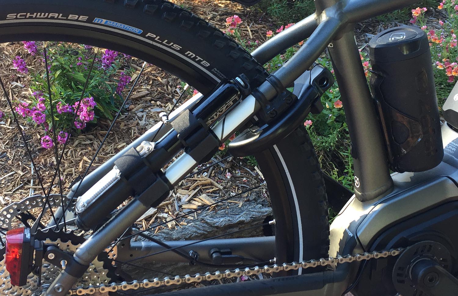

Hello BikeMike,

Here are some get-me-out-of-trouble modifications and additions that I have made to my Powerfly 5 - together with my musings:
  • Tyres: I've treated the Powerfly to a pair of Schwalbe Marathon Plus MTB (57-622) tyres with Slime-filled tubes. About ten days ago I punctured on my regular rail trail ride and, in attempting to remove the Bontragers, learned the true meaning of "impossible". After a taxi ride back home and a settling cup of rooibos tea, it took more than twenty minutes to relieve the wheel of its accursed cling-fast rubber friend - this being accomplished with some serious assistance from a Park Tool PTS-1 Tire Seater and a pair of Lezyne Chromoly Saber Levers.
  • Pump: Lezyne Digital Alloy Drive attached to the seat stay with Zefal DooDads.
  • Tool Bottle: Zefal Z Box tool bottle (for tube & puncture kit) secured in an Arundel Sideloader bottle cage.
To keep me safe when I venture onto roads:
To keep the bike safe (especially at home in the shed):
... David

Mike ...
Here are some get-me-out-of-trouble modifications and additions that I have made to my Powerfly 5 - together with my musings.
... David

I heard back from the Trek store. They think a trailer will work, because the 300 pound weight limit has some leeway, being a mountain bike. They claim the bike will have more wear, tear and maintenance.
They did not recommend making brake upgrades.
The main thing that bothers me is the disabled walk mode. Getting across six lanes at a busy intersection is stressful, when you have to push 100+ pounds across the street. I dare not ride the bike with an attached trailer, because I lose my pedestrian right of way privileges.
So, is this a car replacement? I do not know why I am reluctant make a strong assertion. Probably. Certainly more likely, than unlikely.
The bike and trailer will satisfy my weekly food shopping needs. So, I guess the trailer will satisfy my cargo needs.

  10. Interchange rack Baskets

  14. Burley 12mm Axle ( https://burley.com/product/thru-axle/ )
  15. Burley Nomad
