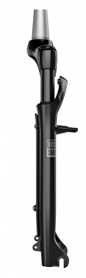

On this topic of the suspension forks: I wonder if there are any fork experts in the house that can throw out some suggestions as to the lightest/best e-bike rated air fork for urban (bad roads) riding? The 7 stocks the Suntour Mobie I believe and I'm not sure if that is an air or coil fork. And I'm betting it isn't the lightest out there. My Haibike and R&M have the Suntour Aion but that fork looks burlier/heavier than necessary for a carbon city commuter.
Edit: answering my own questions: the Rock Shox Paragon gold looks to fit the bill. Minimal branding and matches bike, air, small amount of travel for trekking/city riding and e-bike rated:

Unfortunately, the RockShox won't work on the Allant 9.9. Here's why:
  1. Allant+ 9.9 has a 15mm thru-axle but the RockShox paragon uses 9mm QR.
  2. The paragon was not built for high speed E-bikes. Sure, it works on E-bikes but it was built for acoustic hybrid bikes. High speed E-bikes need a mono or dual channel air spring/chamber.
    The stanchions on an E-bike specific fork are burlier as you alluded. Paragon would look out of place and change the aesthetics of the bike completely on Allant+. It could have worked on the older Dual sport models or XM700+ models.
  3. Travel on the RockShox paragon is 65mm, where as the Allant+ may take 80mm travel fork (looks like it) or even 100mm if it is suspension corrected.

Thanks Ravi. I wonder if it is also not possible to switch to the Shockstop stem. I'm not for sure but it looks like Trek used a proprietary stem that acts as a cable router for the carbon version. It is adjustable. On the aluminum bikes, the cables are routed internally through the frame. This is what I pieced together from the short Trek video and their website.

The lowest version of the Allant+ comes stock with the Suntour Mobie fork. The bikes are suspension corrected so I'm assuming you could add that Suntour fork to any of the Allants. But I was looking for the best and lightest fork available to match a carbon frame bike. I'm not even sure if the Mobie is an air fork. The picture that Ravi posted is not of the Allant+. Somehow Trek put this picture on their website with the Allant+ pictures. Unless there is a belt drive version in the works that Trek hasn't posted yet. They might have been trying to illustrate the rail technology and ability to run two batteries.
I don't see any other RockShox options for a 15mm thru axle e-bike?:
Once you know the exact travel in mm for a replacement fork, it would make your job easier.
There are quite a few:
Here is one with 80mm travel, 110mm boost thru-axle. They also make the 100mm version.
If you want the very best, you could certainly look at the FOX series. If you can accept a previous year model, you would be able to find an excellent fork at an excellent price like this:
Another one. FOX Factory 32 with kashima coating but can only accept tires upto 2.3"
Once you know the exact travel in mm for a replacement fork, it would make your job easier...
I think minimal travel is necessary for an urban commuter. 80 or 100mm I would think be sufficient. I set my Haibike and R&M such that they are quite firm and measured using the silicone ring shows I'm using less than 2/3rds of the available travel.
