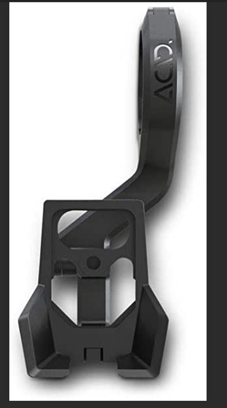

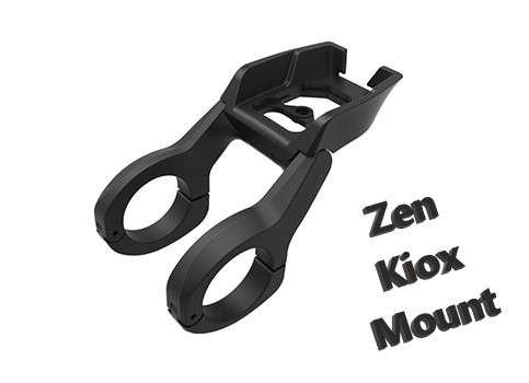

There are multiple KIOX mounts available. Every OEM has their own holders for KIOX. @Over50 has the CUBE one and Trek has their own.
We have a custom KIOX mount that secures the display in just like the NYON:
