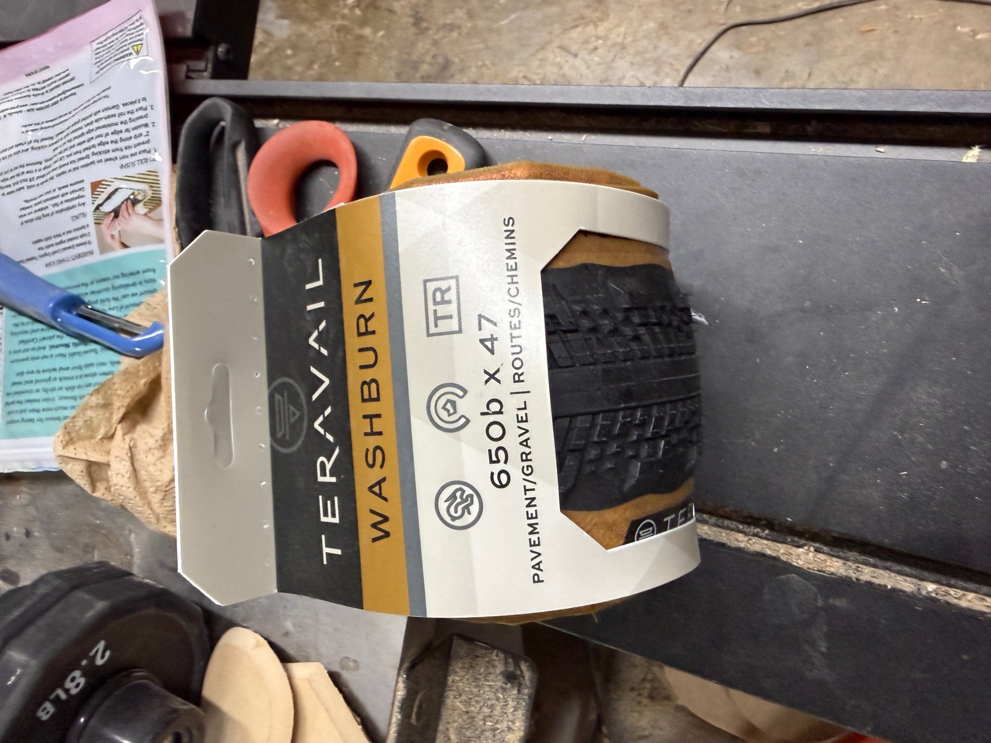

this is the tire I will use this winter. I use the slick most fo the time, but its traction sucks on slick wet/cold roads. you can run it at lower psi so it feels a lot better than the stock tires and its a lot faster too.
