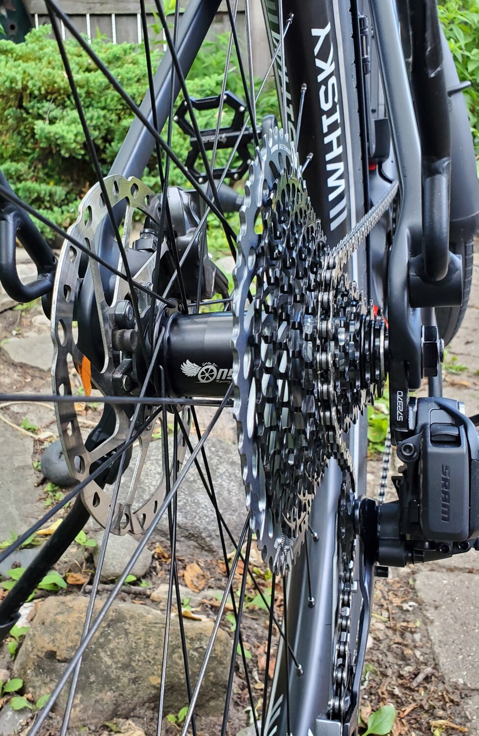

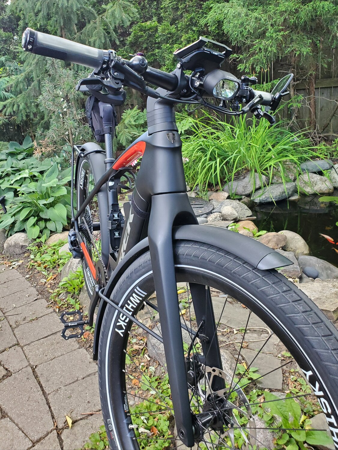

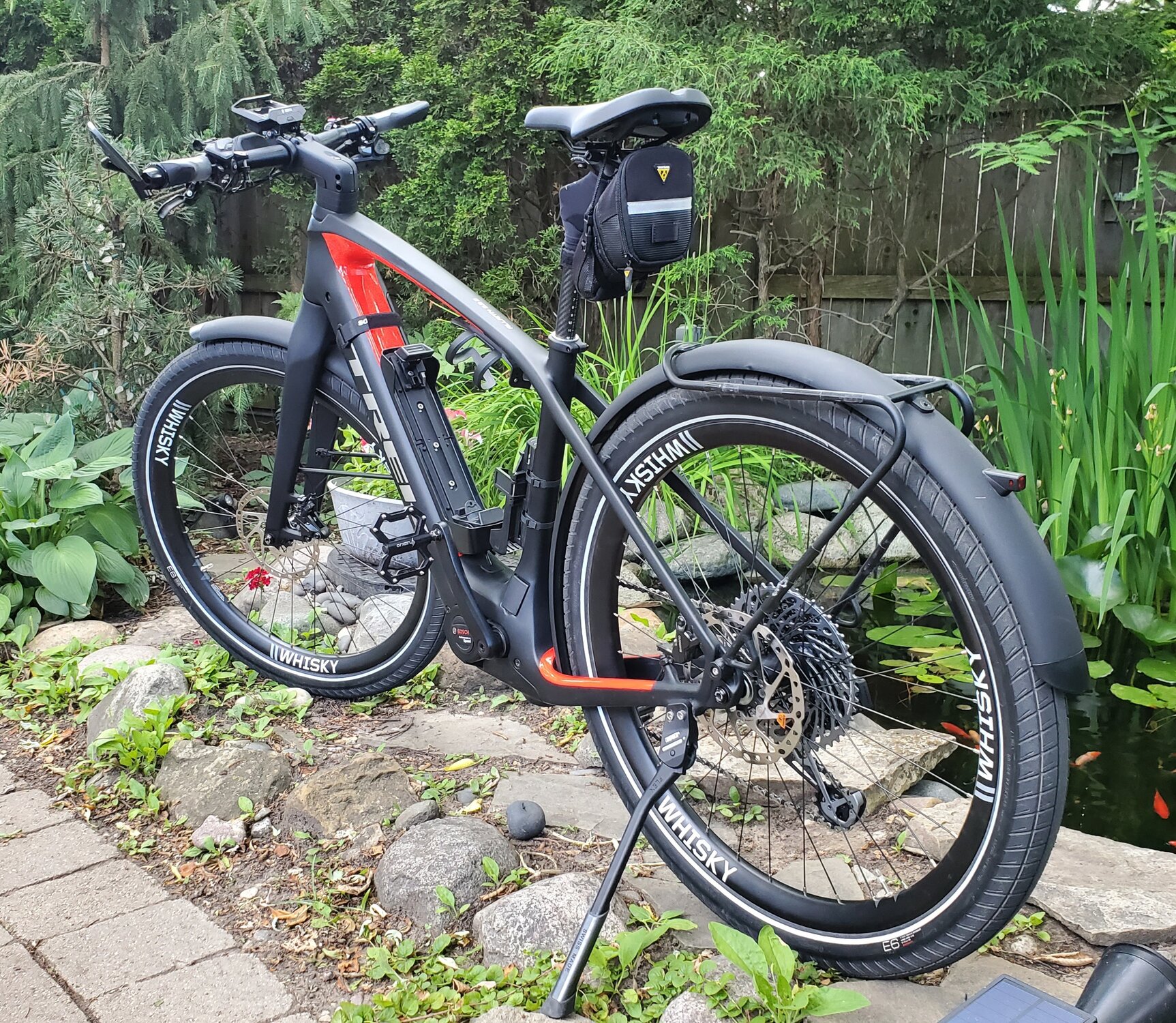

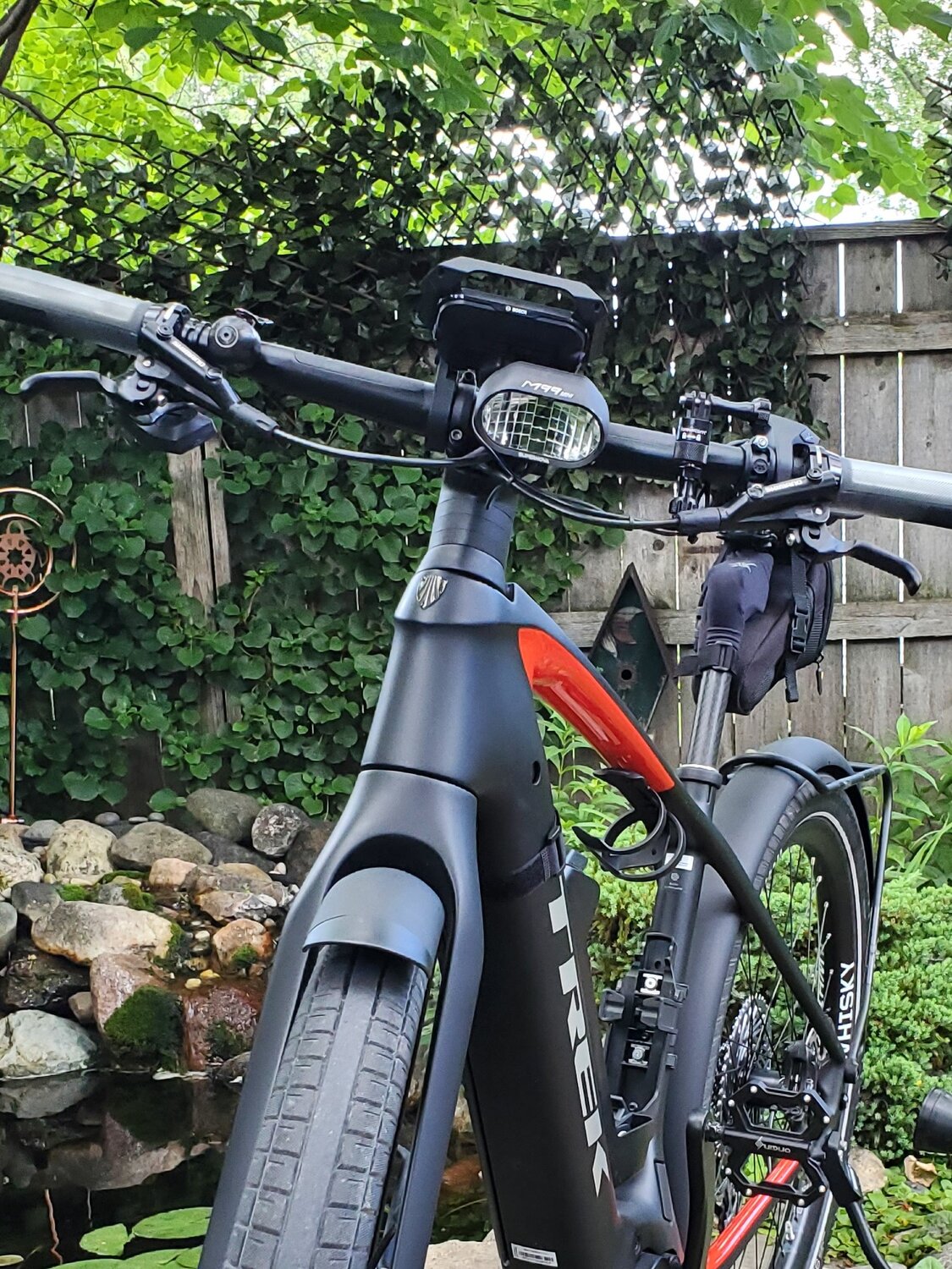

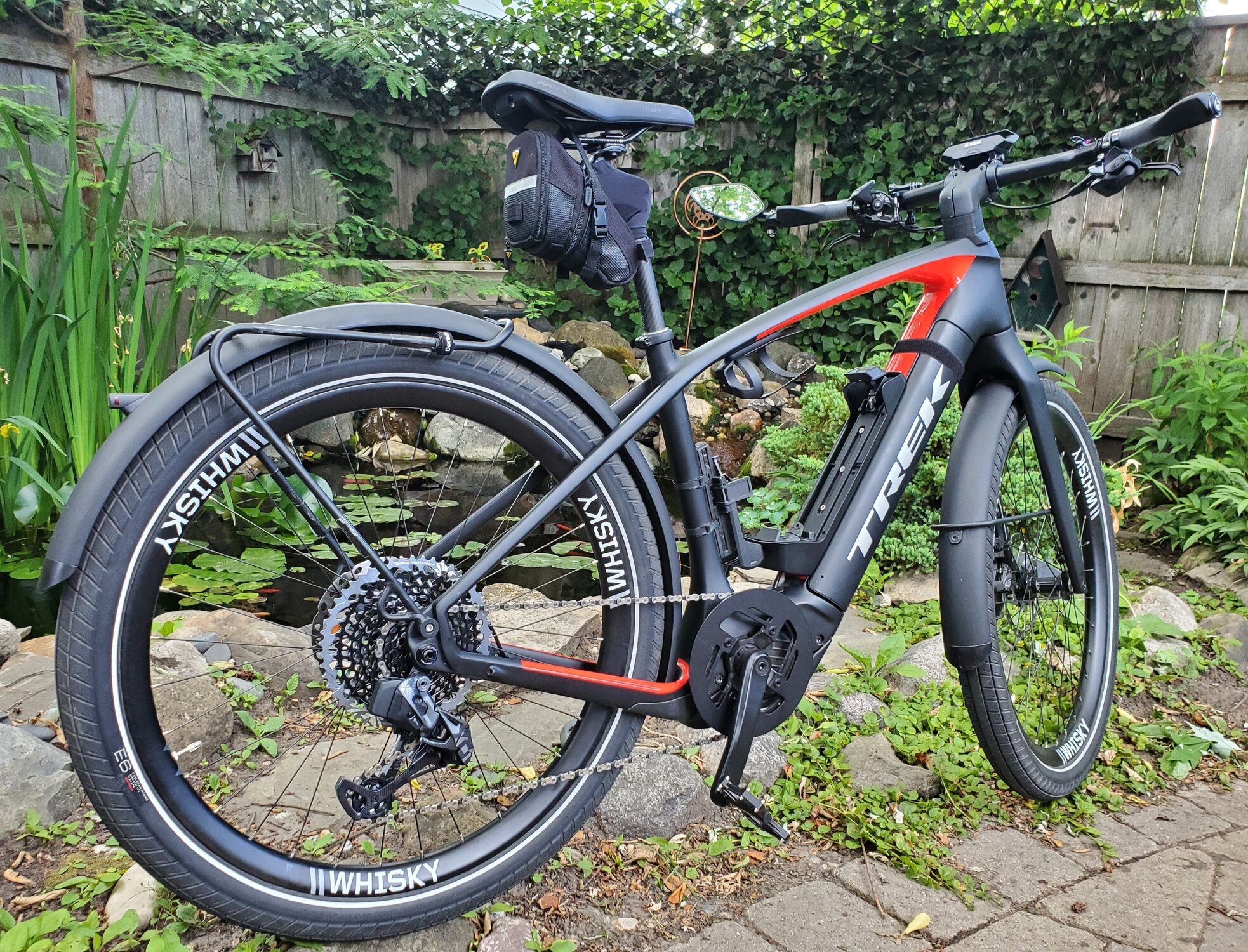

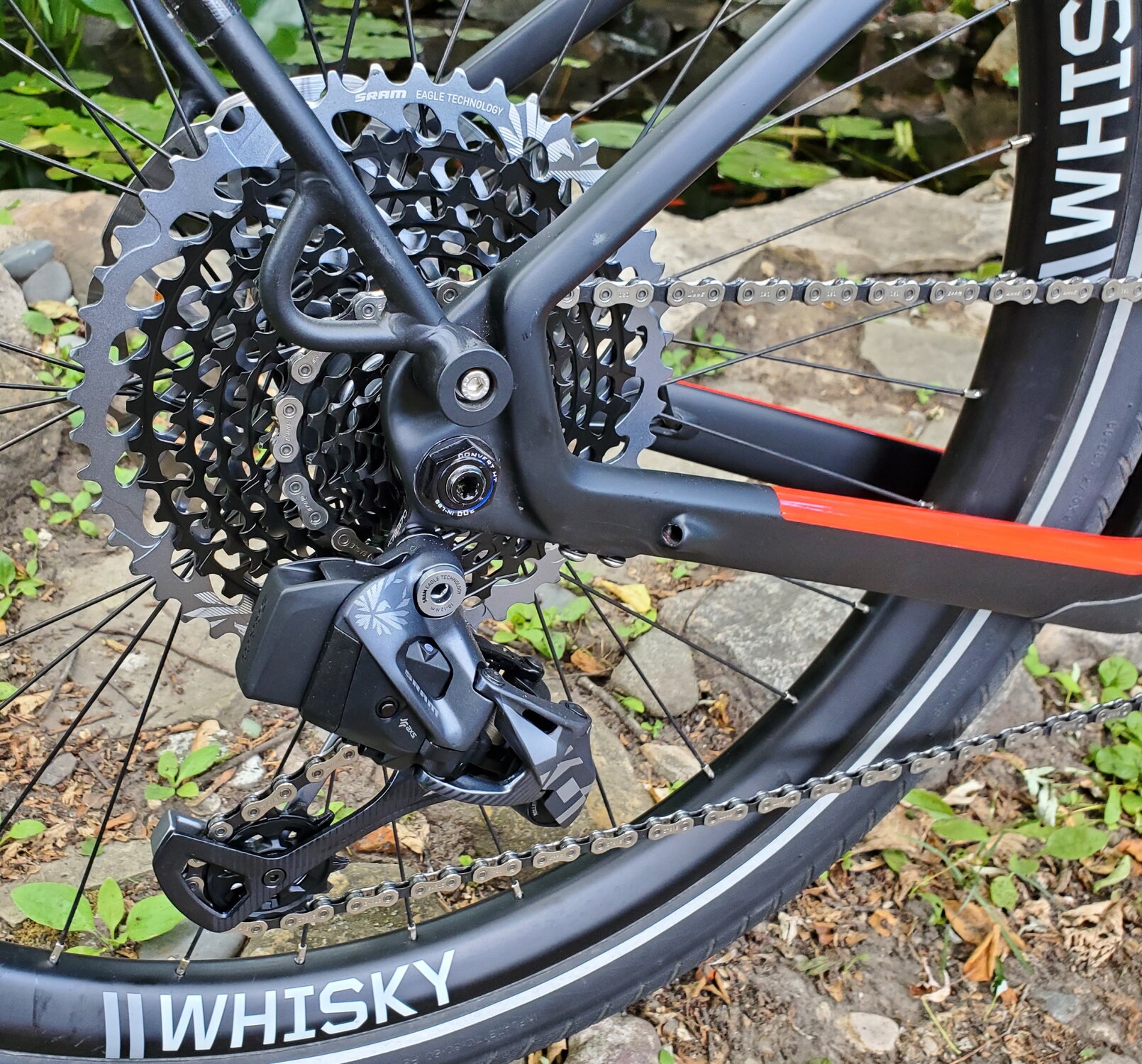

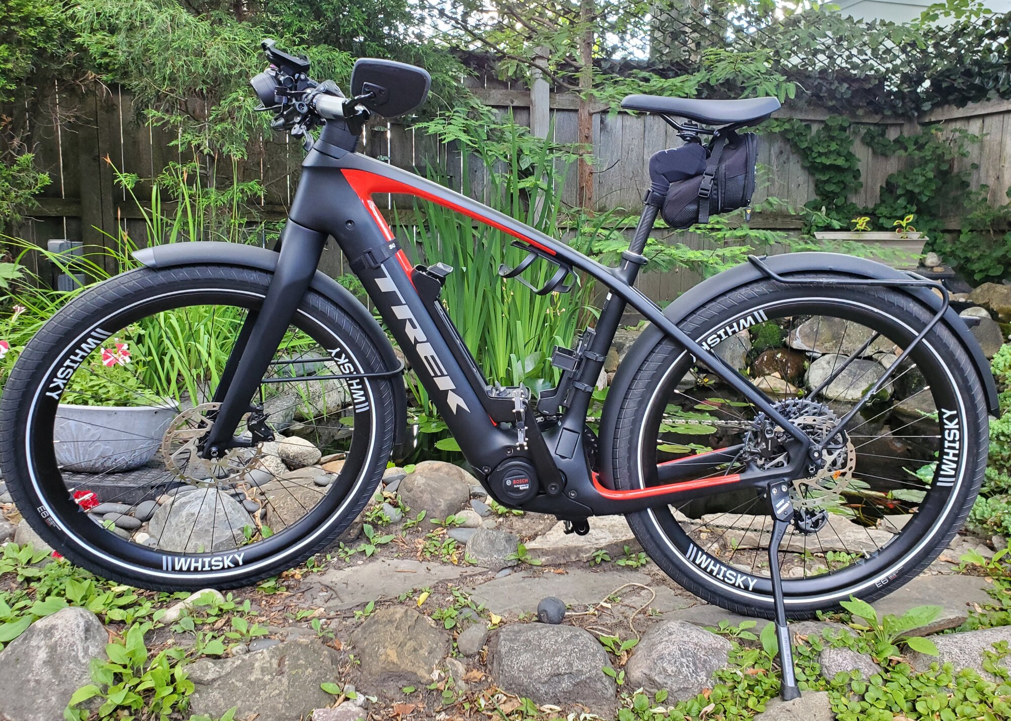

Big sigh of relief. Finally the bike is back home. New electronic SRAM setup and Onyx hub. I did a 5 mile test ride and plan a couple of 20-30 mile rides in the coming days. The new hub is silent which allows me to listen for other noises. Next most prominent is the electric noise of the Bosch motor and an electric/whir noise when shifting. Apart from the electric motors, it was all silence for the 5 short miles.
A few observations on only 5 miles:
  • I like how the SRAM setup has left a very clean cockpit area - fewer cables
  • On downshift, it sounded like a mechanical derailleur. On upshift I only heard the slight whir of the electric motor
  • The AXS App: when attempting to set the multi-shift, the App warns the user that if multi-shift is used on an e-bike, it will void the SRAM warranty (not the exact wording). Based on that warning, I decided to not set the multi-shift. I'll be curious to hear what other owners of the system think/did
  • The hub was silent at all times
Not aware of that, sure am curious if/how/when I'd know otherwise if the LBS was not informative and it was supposed to be my responsibility to know how they configured it, etc., no?
...Not aware of that, sure am curious if/how/when I'd know otherwise if the LBS was not informative and it was supposed to be my responsibility to know how they configured it, etc., no?
If you have/downloaded the SRAM app, there are a few settings you can manipulate/set (after pairing your phone to the derailleur). It looked to me that multi-shift was off by default. If you haven't changed it via the app then I'm betting your's is off as well.

Bike was really smooth on these two rides. 30 miles was easily achieved (stop in the middle at a coffee shop) with no discomfort. I did not fully charge the 625 WH battery and returned home with approx 45 miles estimated remaining in Eco. Most of my ride was in Eco.
I'm at about 750 miles and time for an update - a couple of hundred miles since the hub was replaced. I haven't had any further issues and its been a true pleasure-ride. I do believe more strongly that Eco mode on the Bosch Performance Line motors is too strong. I posted with some other bikes that I've owned that I wished for a lighter version of Eco - maybe 35%. That was back in the commuting days. Now that all of my riding has been fitness-around town rather than commuting, I notice it more. I can do a 25 mile ride almost all in Eco and it just doesn't feel like much work. If I ever get back to commuting I'll appreciate the speed and power this bike has. On the Riese and Muller with the Gen 2 motor and a Rohloff hub, I would sometimes rely on Sport mode when commuting back home - particularly if I had headwinds. I have never relied on or used Turbo mode much on any of my Bosch bikes. On the Allant, if I've been in Sport mode its been by accident. I've never used Turbo. I'd guestimate I'm 90% Eco for those 750 miles and 10% Tour. I've had the bike past the cutoff - around 29-30 mph using Tour on a flat.
