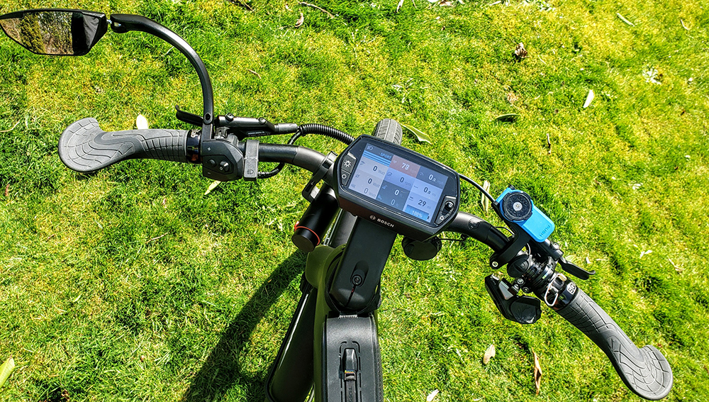

Quick question on a safety topic. On my road bike I have the Garmin Varia light/radar paired up with my Edge 520 to alert me to traffic behind me. I'm considering adding a mount for my 520 and the Varia on my Allant but would a mirror serve me just as well? Thoughts? Having the 520 on my Allant seems like overkill - especially since I'm using the Cobi.bike app for all my navigation/tracking.
I upgraded my grips to the SQ Labs 702 medium size with the Selle Italia mirror. It looks cool on the bike and a quick glance down is all that is needed to see what is behind. In town and generally I am just in the habit of giving the mirror a glance every 30-60 seconds. For me it is just right to maintain situational awareness. Here is a view of my cockpit.
I'm probably going to regret asking this but what is that head unit that you have on there??! And what's the blue thing on the right?
My display is a Bosch Nyon. The blue thing is a quad lock phone mount.

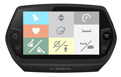

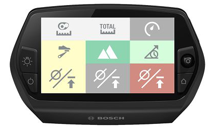

I have been using Nyons on my bikes for the past two years and would have nothing else. Unfortunately they are neither sold nor supported in North America. Bosch is coming out with an updated version this summer and rumor has it it will be available in NA. Function wise, they are far more complete than the Kiox, have a large, easy to read at a glance screen, custom ride and fitness screens, custom ride modes, decent navigation, maps and routing with GPS, okay phone integration, great data gathering with auto upload to the Bosch cloud via wifi, with an online, detailed record of each ride starting on day one of installation. Plus I prefer using a dedicated unit rather than taking up phone bandwidth.
Here are my custom screens
FireShot Pro Screen Capture #084 - 'Bosch eBike Connect' - www_ebike-connect_com_ebikeconnect_...jpg
FireShot Pro Screen Capture #085 - 'Bosch eBike Connect' - www_ebike-connect_com_ebikeconnect_...jpg
Congrats for SQ lab upgrade. Most members (99%) don't have a clue about this German brand on ebr forum.
I've been using the SQ lab for 12months for their 702 grips and saddle. Defintely the absolute best.
Far superior to the much hyped but totally features lacking Ergons.
I would also add a right side mirror . It can help sometimes and is better to have it and complete the look.
You can get this mirro in either a left or a right side version. The arm is not quite as long as the one on the Selle Italia mirror but it still works quite well.
Th absolute best left hand mirror you can get is the Busch & Muller 701, more robustly built than any other and a nice large surface. It will only work with grips that do have their clamp on the outside with a removable plug for the bar, like an ergon grip.
