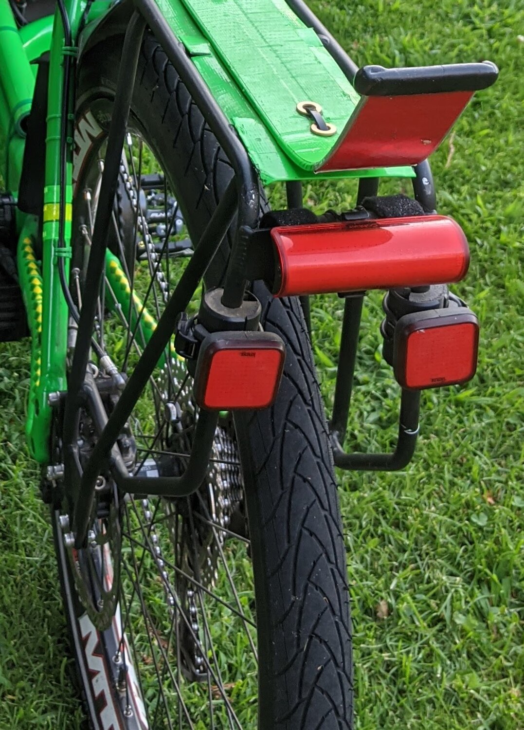

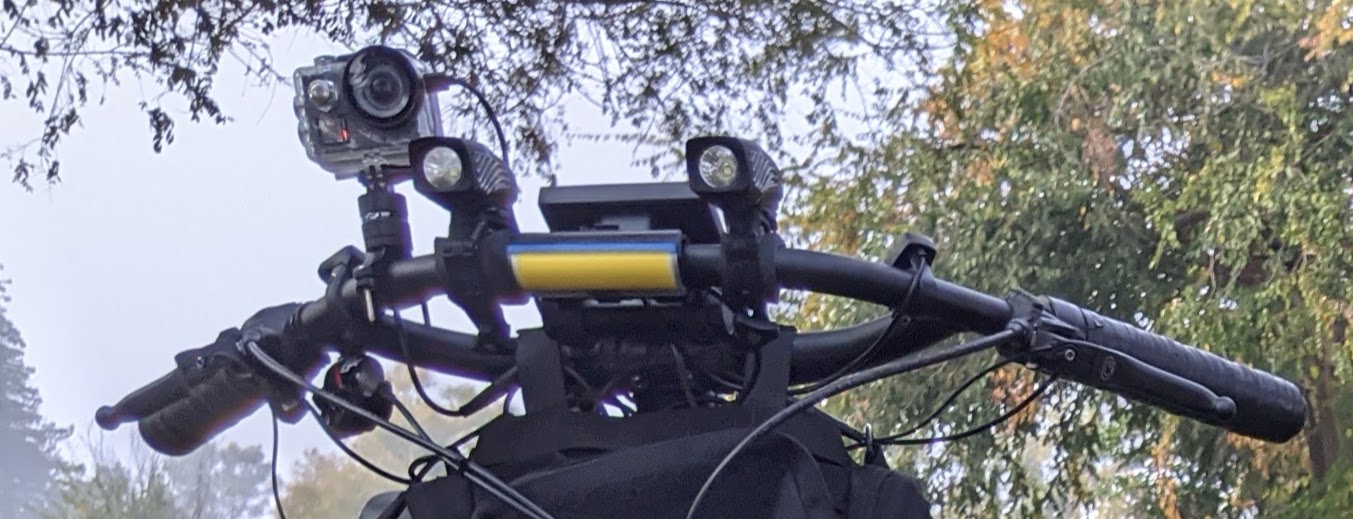

I use a Knog Big Cobber front, set on eyesaver (shuts off the top 1/3 of the light) and eco blink, which is a short, sharp, intense blink so bright it not only works in daytime, it works at night without getting washed out by an adjacent steady light, which is very unusual. With daily use I only need to charge once weekly. Even with the top 1/3 of the arc shut off, I still tape over it to keep any residual from coming back at me.ANY GOOD RECOMENDATIONS FOR front strobe??
According to Knog, its 470 lumens. But remember that what we are really looking at is a wide, broad swath of light, and its only an instantaneous blink. The normal light transmits over 330 degrees so it a BIG blink. The 'eyesaver' turns that into a 220-degree swath. It blinks onto the pavement below so you are quite noticeable.Very nice setup! How strong (# of lumens) has this wide strap in front of bike??
Impressive! I use TailGator as an addition.. mostly for breaking light, and I like it's beacon with tail braking light at night as well.. Because is not strong enough I'm using in conjunction with NiteRider Omega 300.. It's fine this way. I did not want to spend a lot money ... All together it looks like still ~ $160 for all 3 lights (two mentioned) and one that I suppose to receive tomorrow - Cygolite DashPro 600 for strobe, and addition to my 1100, and build in 200 lumens.. should be all right. My steady 1100 has 6 modes (super low, low, mid, high, turbo, strobe - but way to fast strobe, way to powerful - dangerous actually as it may totally blind people ahead of me - I bought it few years ago as for non-biking light, yet figure out having my Tesoro would make interesting 'usage' for it - very similar to this one: https://www.walmart.com/ip/ThruNite...owered-by-4-AA-Batteries-Cool-White/685299054 .. I alter mid with high mode as run in night...the rear version that I also use is 270. I use that one without the eyesaver which gives the full 330-degree swath of blink. the two Knog Blinders on the right and left are my steady lights. I run those at 50% power (which if sull power with the center of the light not illuminated).

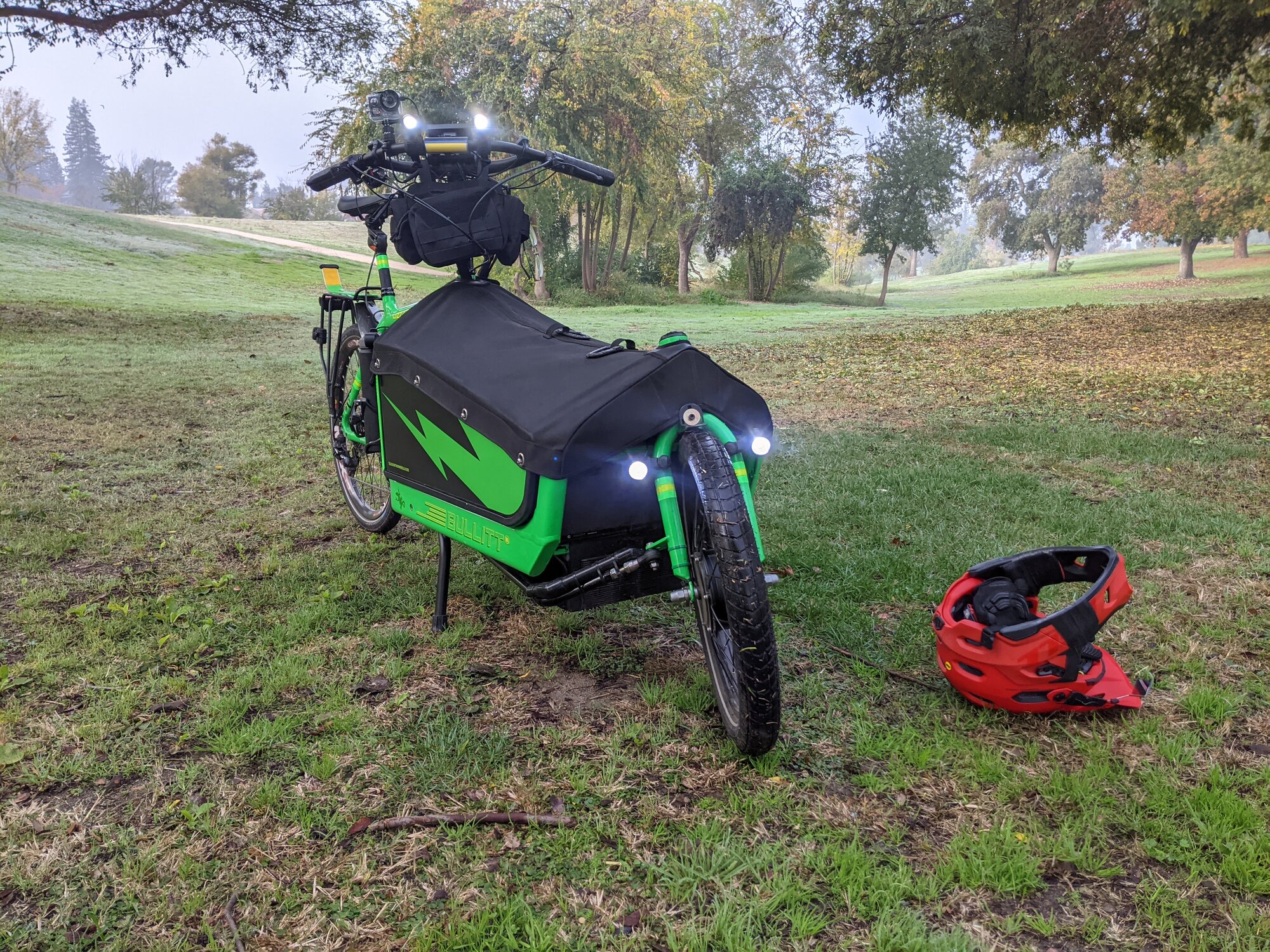

Quite a MACHINE!I add my own cutoffs on hi-lumen lights if I think they are needed. In the case of the up-to-3200 lumen Fisher Fab light its a piece of steel affixed to the light housing with Lexel. Extends forward and, thanks to the angle of focus on the light, forms a physical beam cutoff at whatever height and distance I decide via housing focus. I decided today I'm going to move my second unit onto my Bullitt, and the blinkie down to a center-fork raised mount I have.
Another benefit of my using multiple lights is I do not need high lumen numbers for a broad beam. I get broad illumination from the spread-out focus of multiple beams coupled to lower light levels. This also means I recharge less frequently - my standard is that Friday is recharge day.
My present setup on my Bullitt: Two 750 lumen Niteriders up on the bars, with a Knog Big Cobber providing the blink in between. Two 1500 lm lights down on the fork. All of the solids are kept at their lowest settings. The Niteriders are one click outboard on their bases and focused in close. Set to I think 200 lm each so a high, wide, close pattern. The two fork lights are low and focused further out. These have a beam pattern that is extremely narrow. They too are set to their lowest setting, and their 2x18650 (each) battery packs last for weeks like this.
The resulting light pattern is that of an elongated pear. Lots of light to the front and sides up close, a narrow spear on the ground straight out further past the wider portion for the fork lights. There's no way you can get a pattern like that with a single light. The only reason I am looking to replace my Niteriders with the Fisher Fab House is they are getting old and losing their battery life.

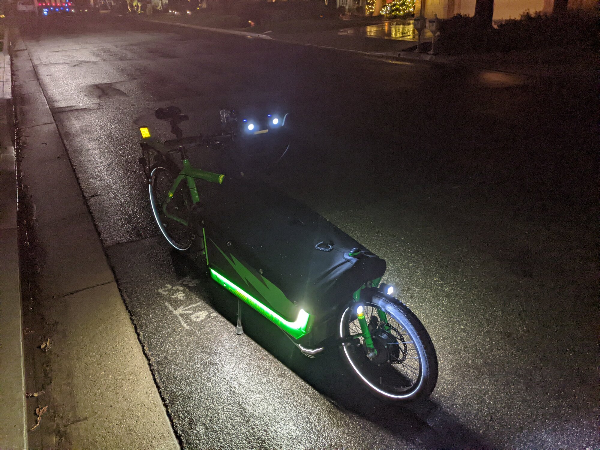

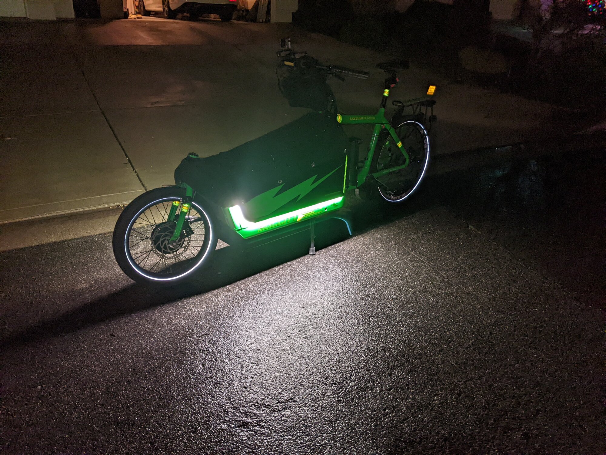

And there's more to visibility than forward or rearward lighting. It cannot be overemphasized that the apparent blinding-bright nature of these LED strips is an artifact of the camera and not reflected in reality. It was super easy to do, super cheap and brightly illuminates the frame of the bike and the ground underneath me, giving me what appears to be a sort of halo when viewed from an automobile as I travel down the street at night.

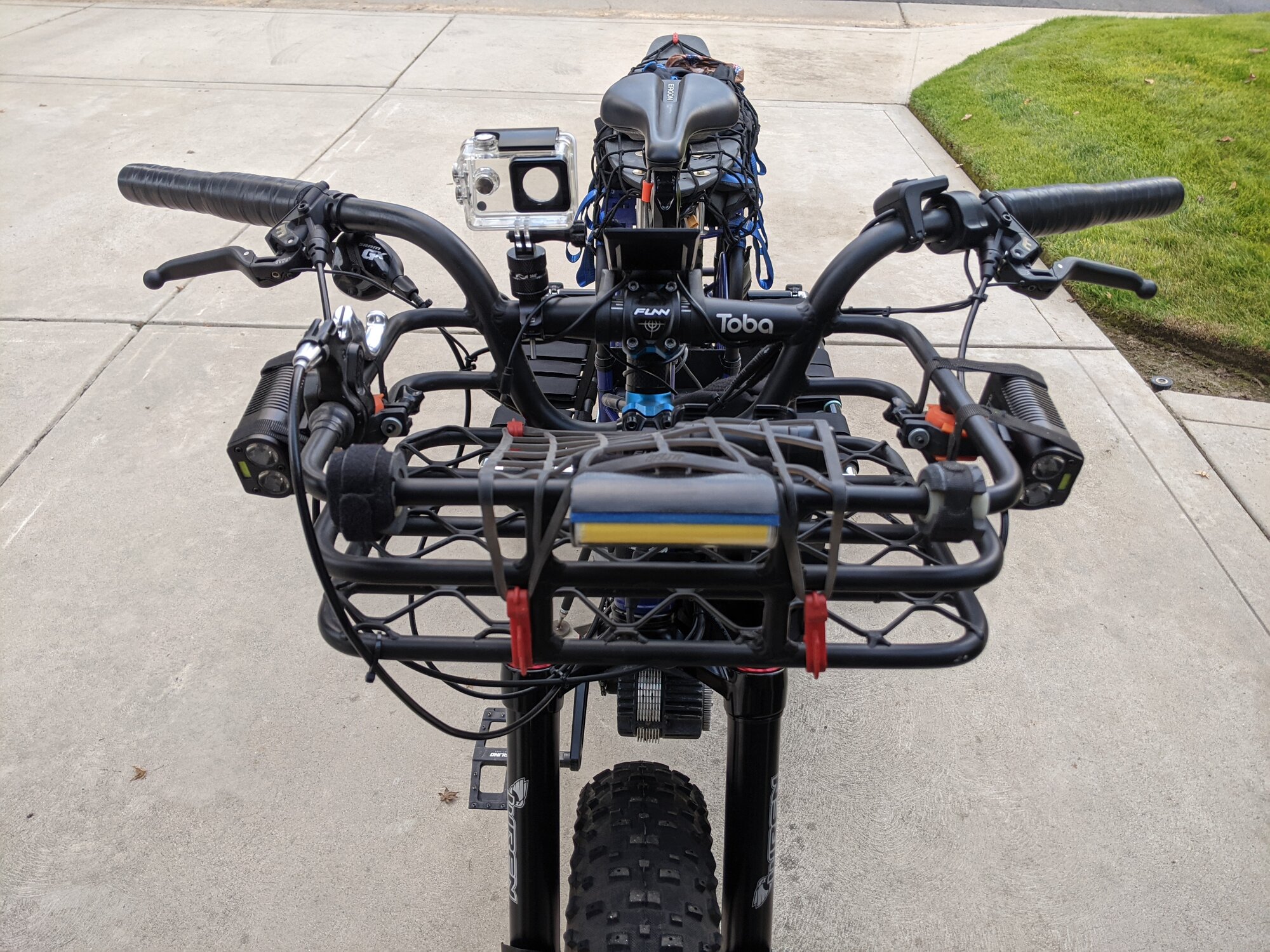

I ended up with: https://www.amazon.com/dp/B07F7S2KK1?psc=1&ref=ppx_yo2ov_dt_b_product_details .. in conjunction with TailGator (mostly for beacon/braking purpose indicators)... It is not as stupid as initially may seem to have more than 1 front and rear lights on bike as some of you am sure noticed conditions very a lot (time and weather) - typically also meaning you are ending up with backup if needed as often you use one of them - also more lights on bike contribute for longevity of their batteries as oppose to only having one that under any conditions you'd end up constantly using it - hence more charges/discharges.. Most stupid is riding without light or mirror.. I say it is super dangerous and making others vulnerable as well.I only ride in the daytime, so I bright flashing light is important. So far, I haven't come across anything flashing rear light that's brighter than the Cygolite Hotshot 250 or 350.

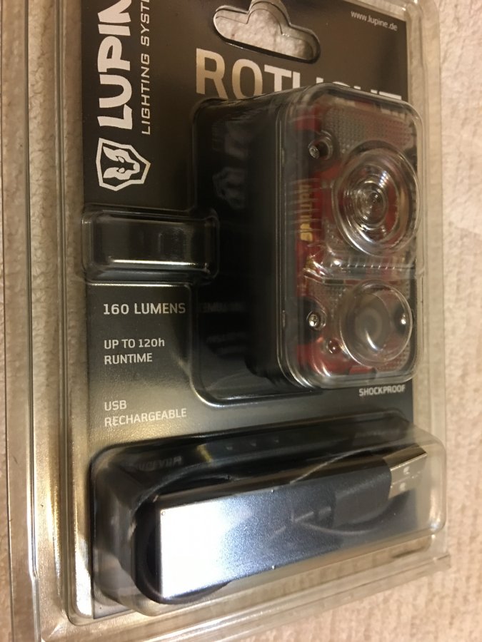

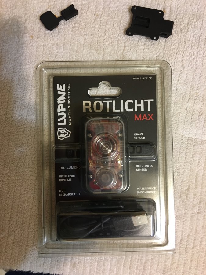

I'd say 160 lumens is good for cloudy days at most, or nights at bit dimmed setups.. Nice piece of equipment but not bright enough. Sure, in the night seems super bright, plus from close distance as well.. Try 2 blocks away in the full sunny day, and it is nearly non-visible... I'd be cautious.Lupine Rotlicht max.- what sets it aside is it’s brightness, very sturdy build , braking sensor and Very powerfull and bright red light( 4modes).
And is Made in, if it matters...
It’s 150$ , a Stromer is 5-7k , it is a good investment for everyone’s safety.
