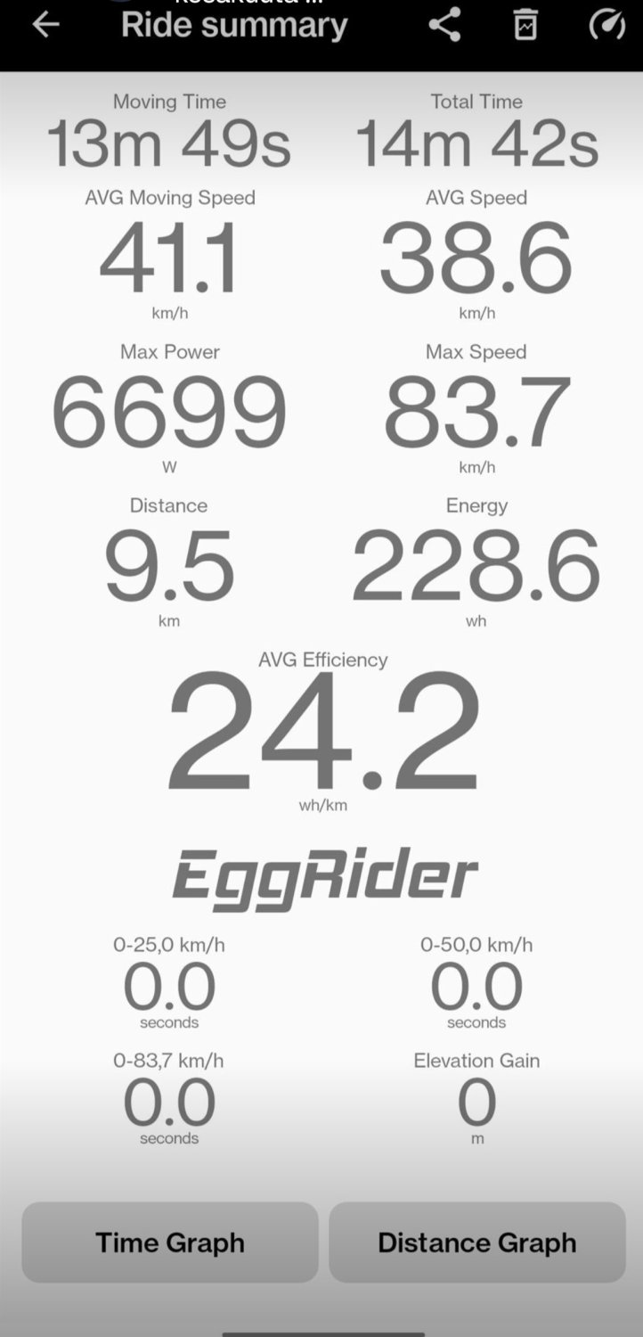

Fun motor for when i dont feel like messing with bbs HD

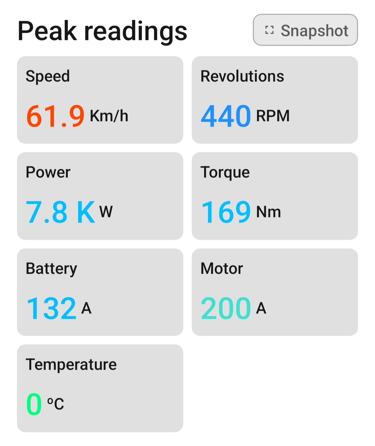

Current figures for my modified G062. Awesome to have this performance in stealthy package 😄

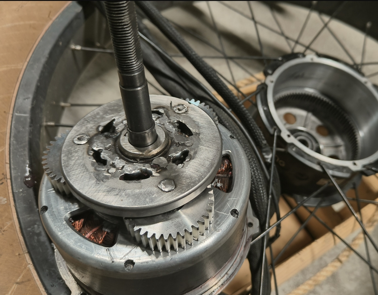

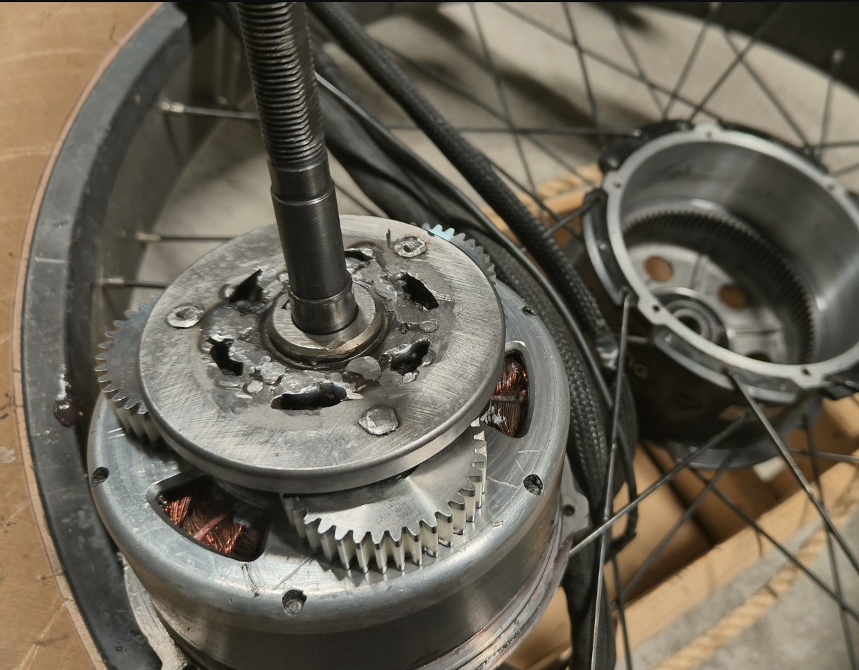

I cracked open the RM G063 1000 DC 5.5 recently and did a surgery on it!
