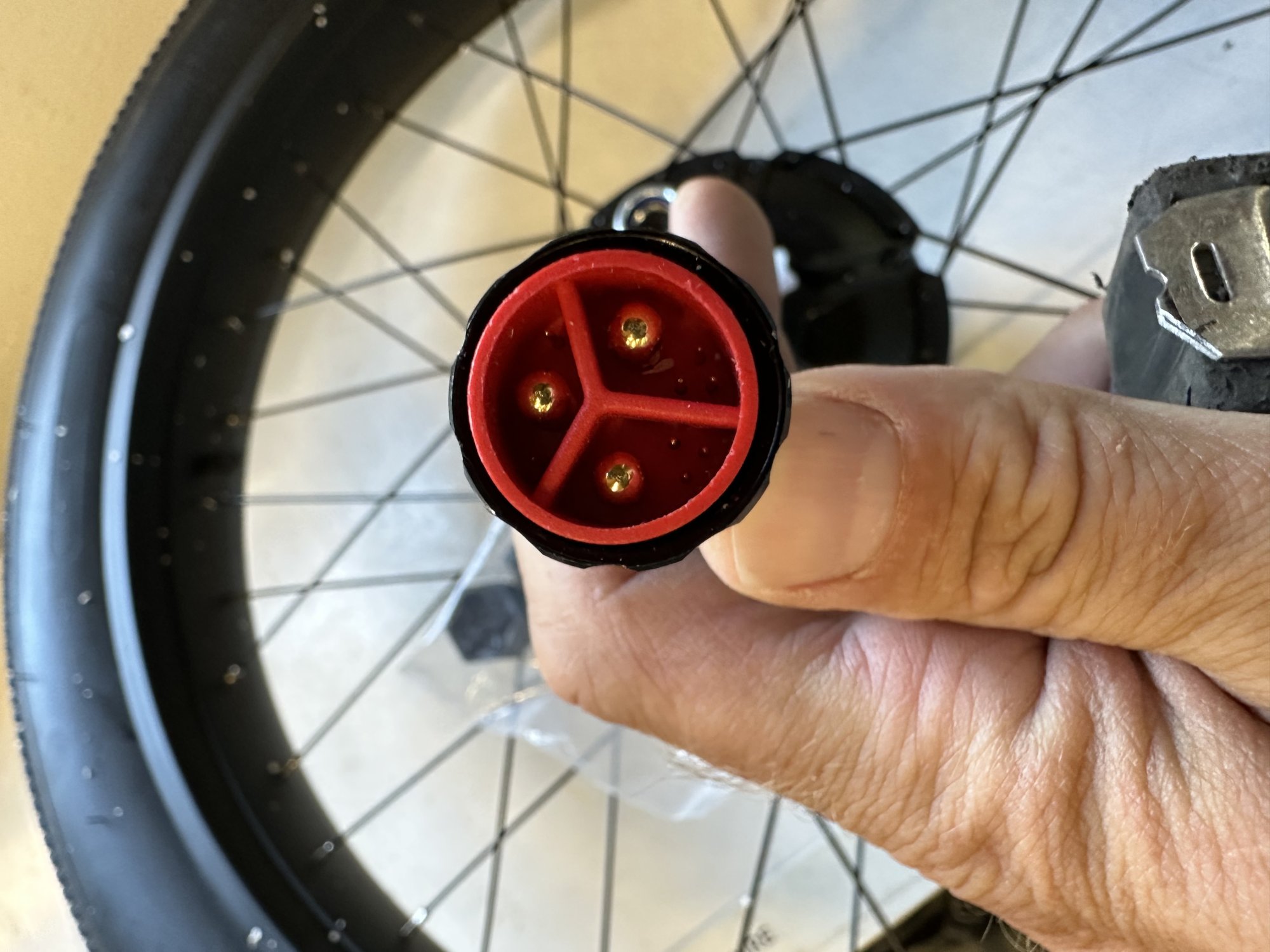

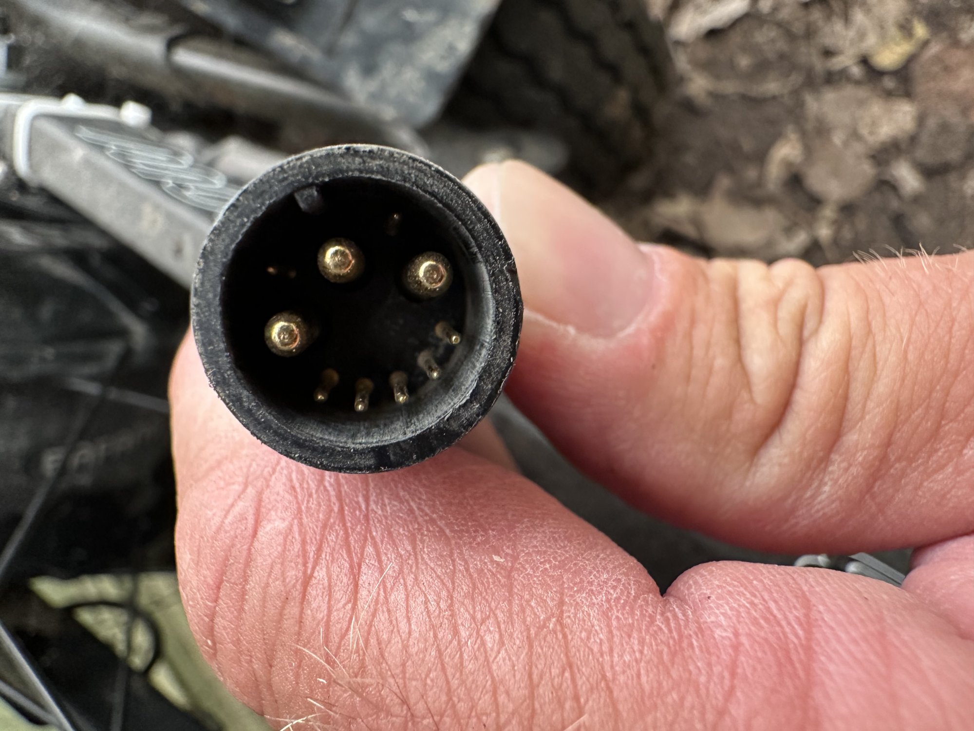

Good afternoon everyone. I am new here and looking for advice. So I did a thing where I bought a bike from china through a group buy in my local town. Order was like 60 bikes. Fast forward 3 years and I have a broken motor. I ordered through the assembly factory a new motor as a “replacement” well I get the motor and it looks the same except a different connector. I am going from a silver plug to red. Silver plug has 10 pins in it and red has 11. Factory just ghosted me when I sent them pictures of the discrepancies and am left hanging with a new motor rim and tire for my bike which won’t work.
Long story short I am wondering if anyone here know if the new motor /plug will have the same harness and a simple plug change will work or is there a different route you would suggest. I am new to this e-bike stuff and would have rather had a shop fix for me but buying direct never seems to work out. I have attached a few pictures of the different plugs. Old plug has 10 pins new plug has 11 (not sure if they are all in use or not)
Thanks in advance as I am dead in the water wondering what to do. A new controller? But then how do I know it will work with other electronics.

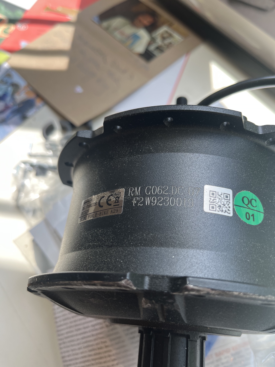

Oh, one other thing… The G062 classification is kind of a family of motors, not specific enough to actually order a part. You need to know exactly what Bafang motor you’re replacing, and the details are usually stamped into the metal casing of the motor. Like below:

The Bafangs just have the three big phase wires and five for the halls, pos, neg and three halls.
Some have an extra for temp or speed.
You really need an adaptor, dont know of such a part.
Most controllers will work with just the three big ones connected in any combination, but it will be less smooth.

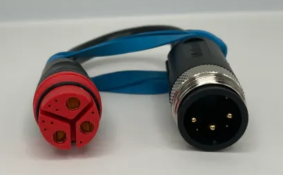

the red one is called an L1121 connector , the silver one is L1019 -
you want an adapter cable that is L1019 MALE to L1121 FEMALE , and you can connect the new motor to the existing controller, it should work fine
(Allows for a controller that uses the L1019 connector to be connected to a motor that uses the L1121 connector)
