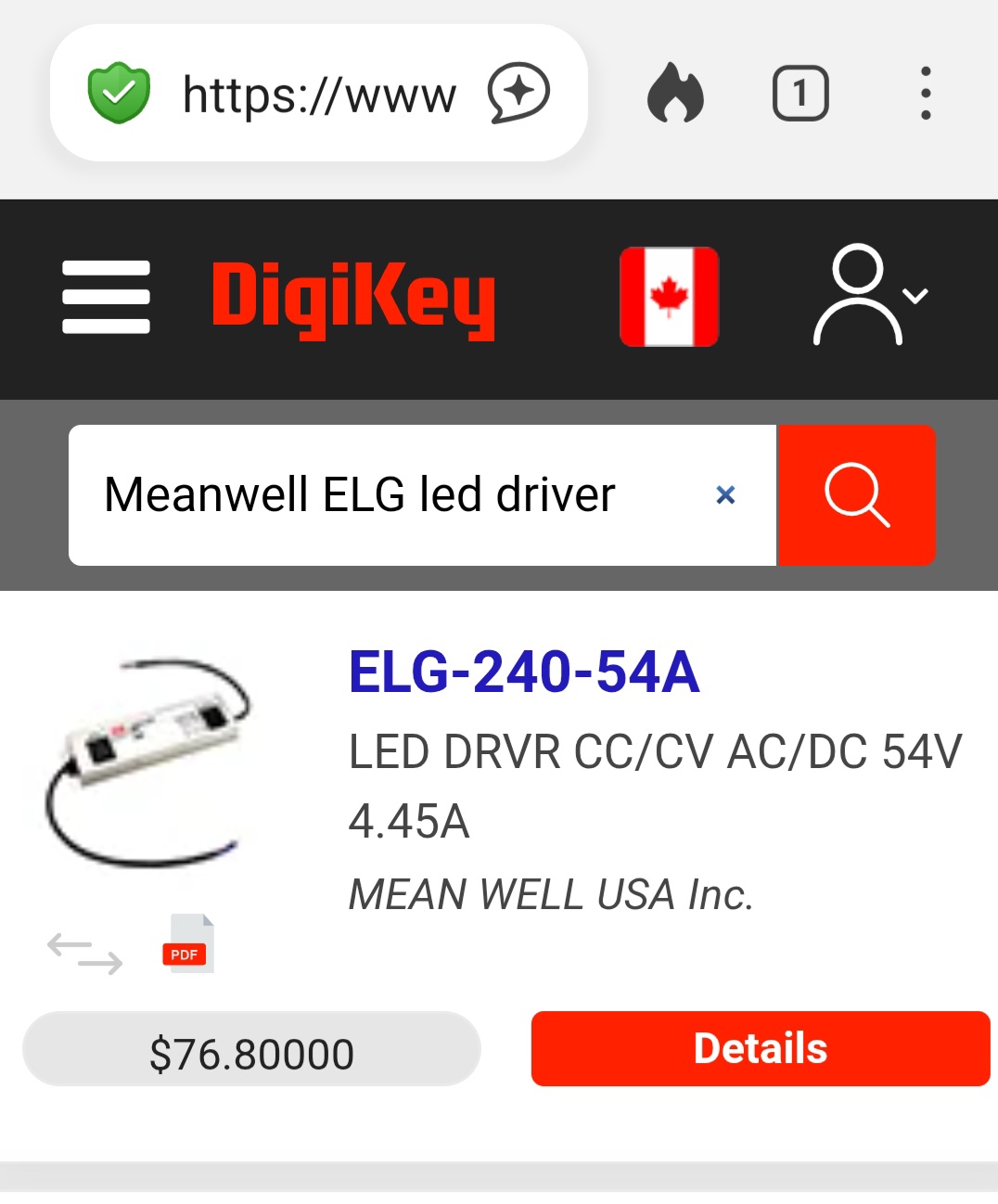

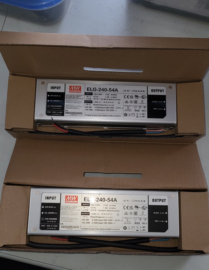

I bought a Grin Satiator equivalent for $77 CAD
PCeBiker
No-Hands No-Pedaling No-Credentials
Canada

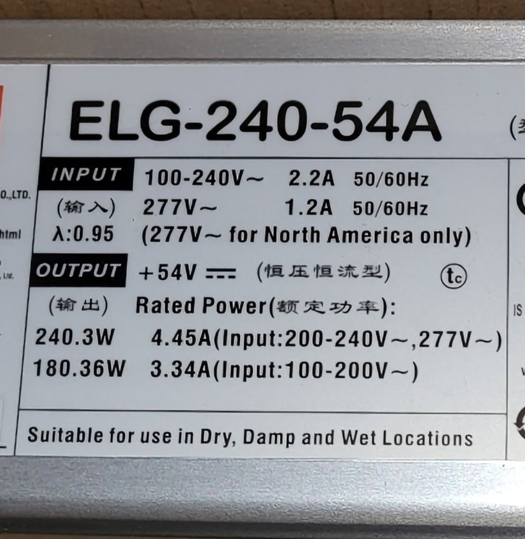

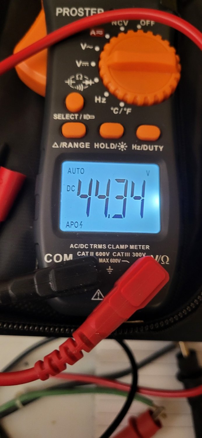

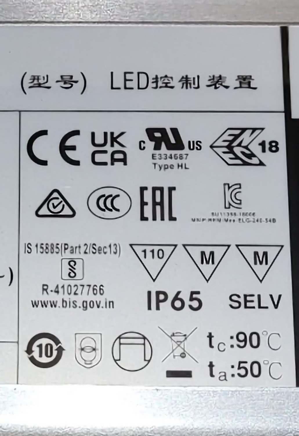

It's a Mean Well 240 Watt 4.45 amp 54 Volt LED driver with adjustable voltage and current output.
I need to set the levels manually.
They are not programmable.
(YAY !!)
It turns out that it only has a 3.34 amp output with a standard 120 VAC North American outlet.
I could wire it into my 240 VAC circuits for my stove or clothes dryer to get the full 4.45 amps, but I'm not going to bother.
I think I'm going to install one on my downtube in front of my new BBS02B mid-drive motor?
I'll use it as a bash gaurd to protect my motor.
A Mean Well LED driver is damn near bomb-proof.
It's only rated IP65, but I can seal the potentiometer ports to bring it up to IP67, they I can submerge my ebike in a meter of water for half an hour, while still charging the battery.
Just need a waterproof plug. 😁

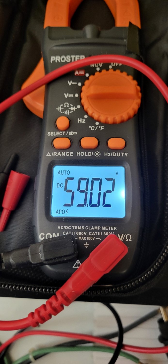

I powered up my "Battery Charger" to check the voltage, and it goes all the way to 59 Volts, so it can charge a 52 Volt battery as well,..
And it goes down to 44.34 Volts.

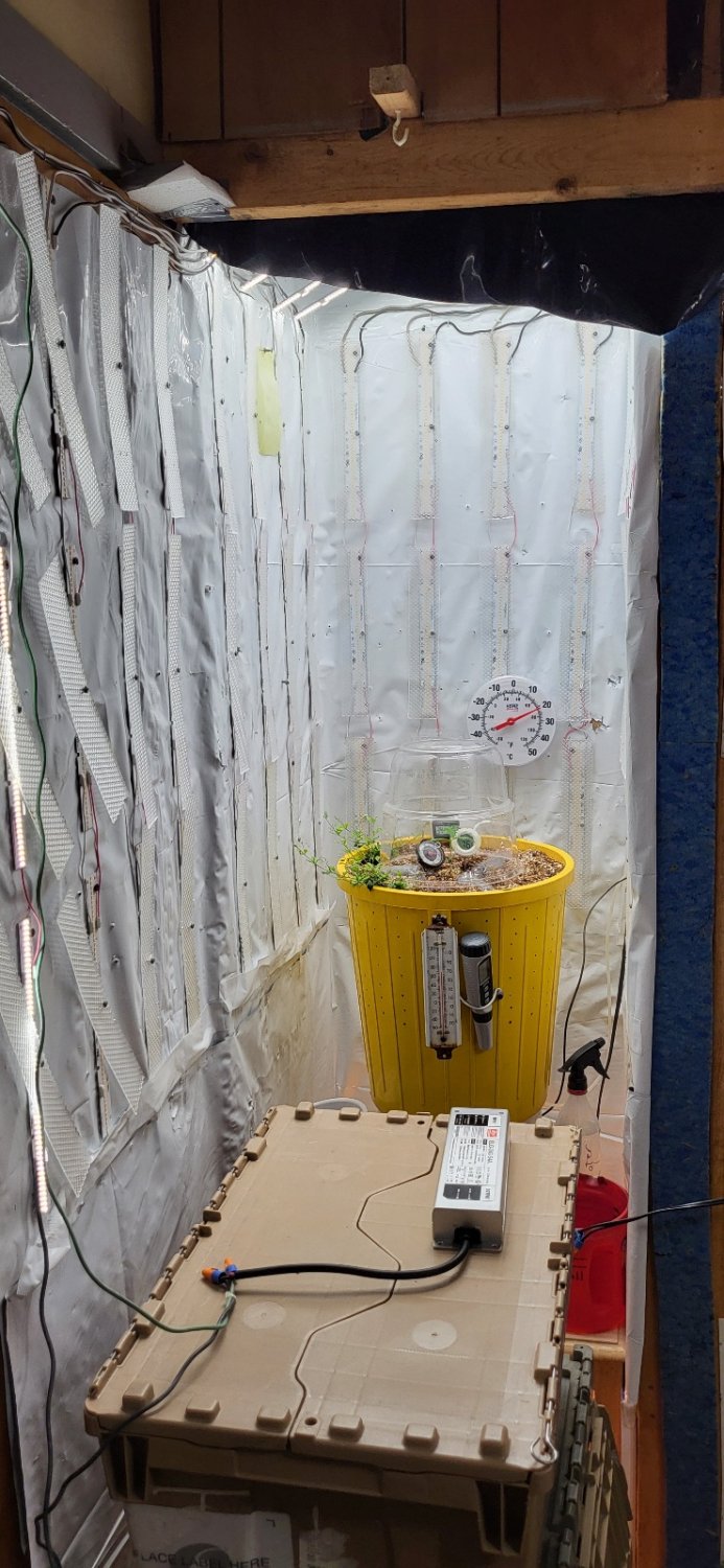

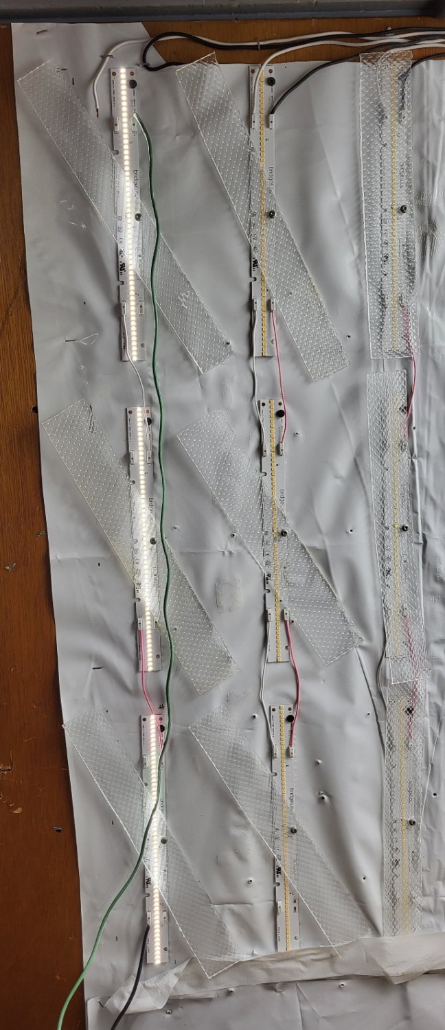

I decided to use it to power my LED lights.
The lights operate at ~19 Volts so I should be able to hook up three in series to match the voltage of my Mean Well driver.
My closet is all wired for 20 volt with three vertical strips perfectly set up to easily change to a series connection with simple rewiring.
It took me over 2½ hours to finally convert the three strips on the left to a series connection, with Every Possible wrong combination imaginable.
(I smoked some Vado for breakfast. 😁)
I ended up with a short circuit about half a dozen times, and I applied 60 Volts to my 20 Volt strips about a dozen times.
I'm glad to know that my new lighting system is now idiot proof, cuz nuthin blowed up.🧨 😁
Maybe in the spring I can idiot proof it as a battery charger the same way? 💥 🤯

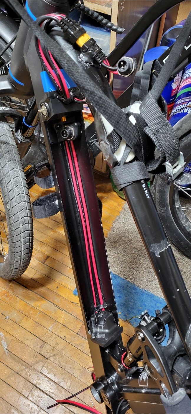

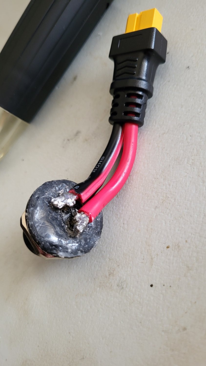

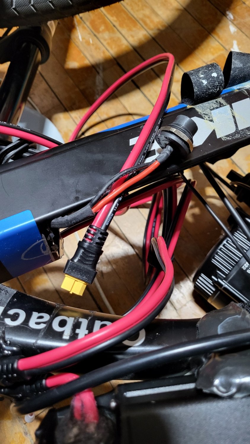

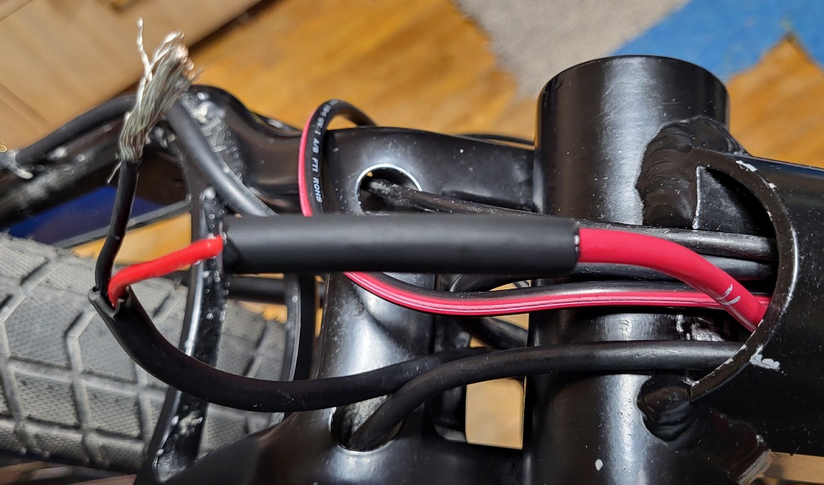

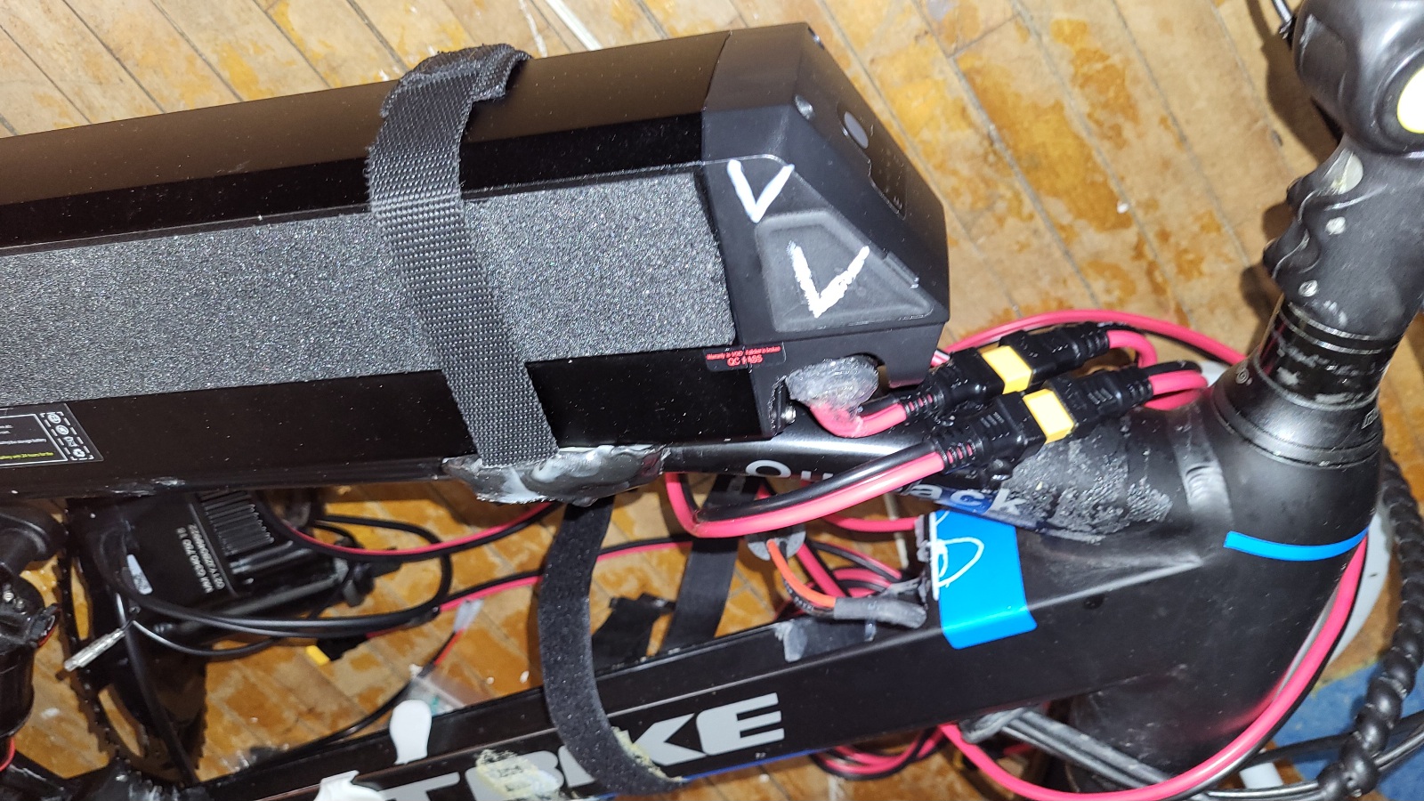

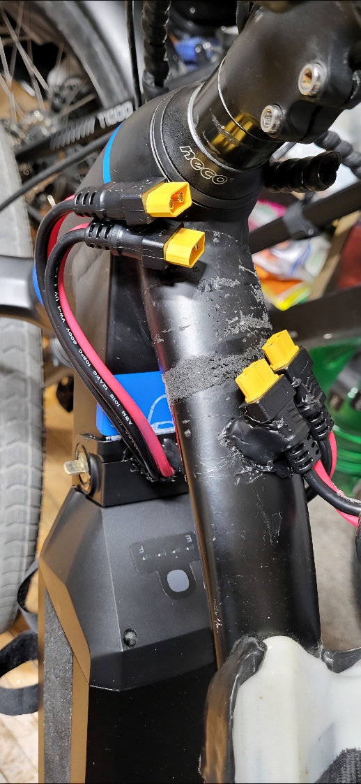

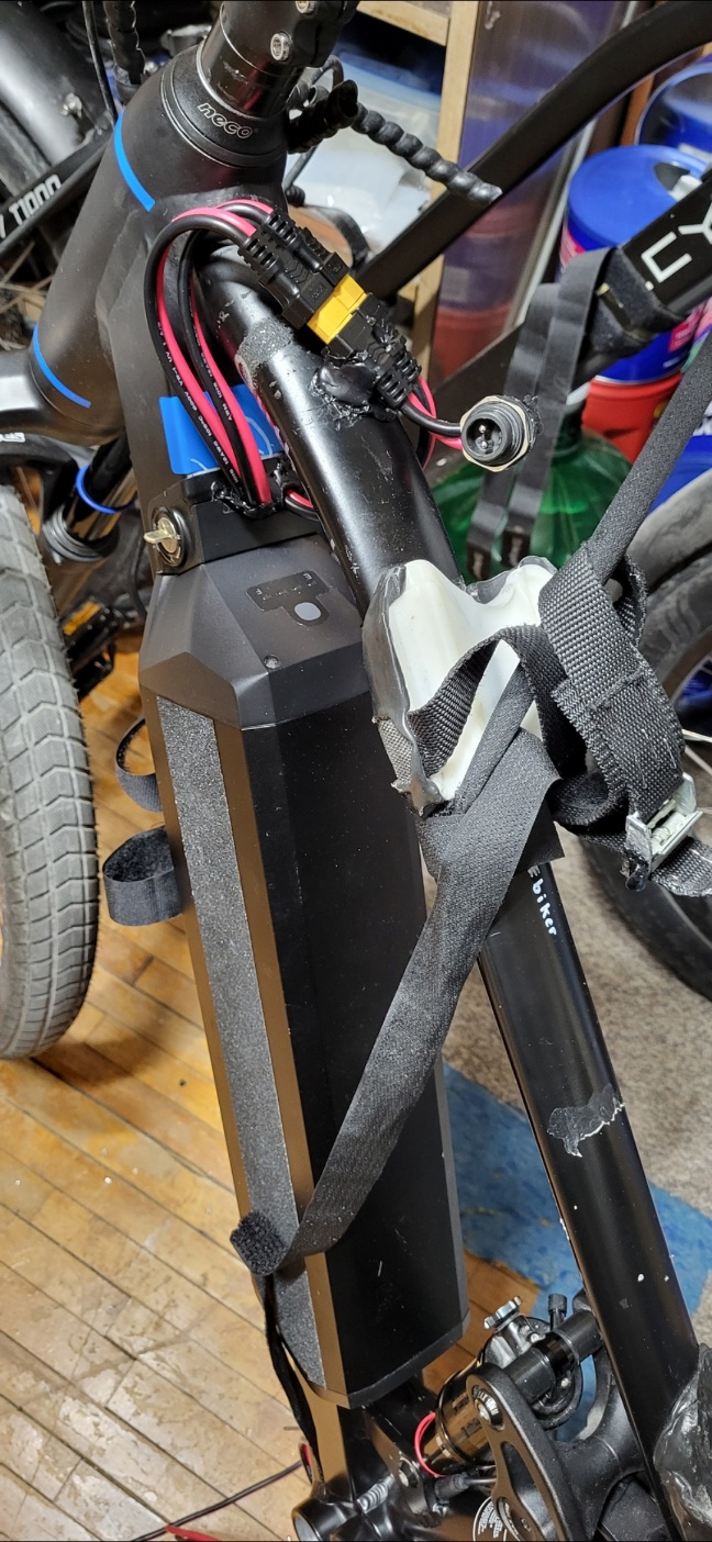

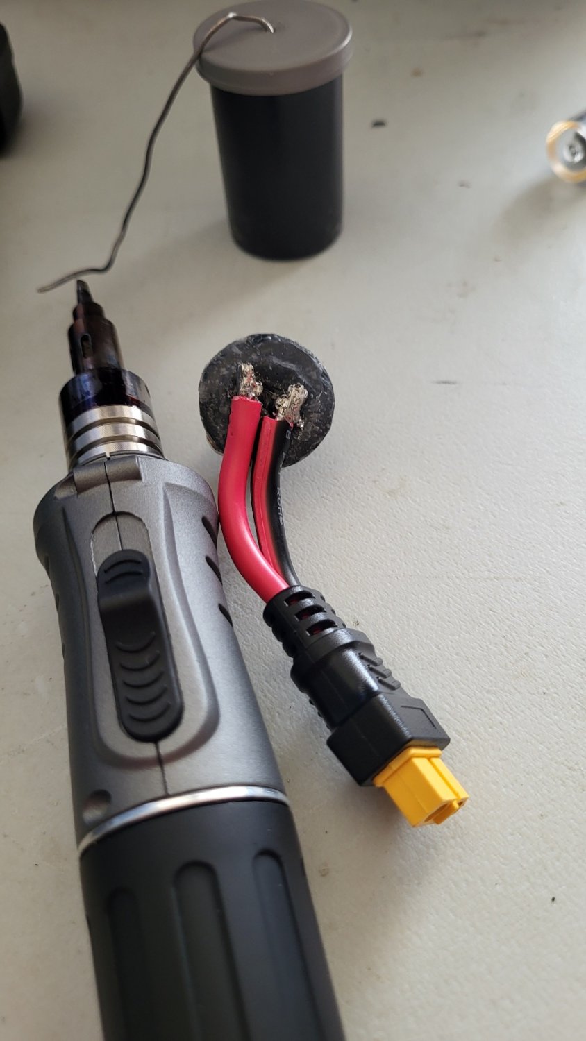

I upgraded the battery wires from 14 gauge to 12 gauge but the new wire is as Fat AF!! 😁

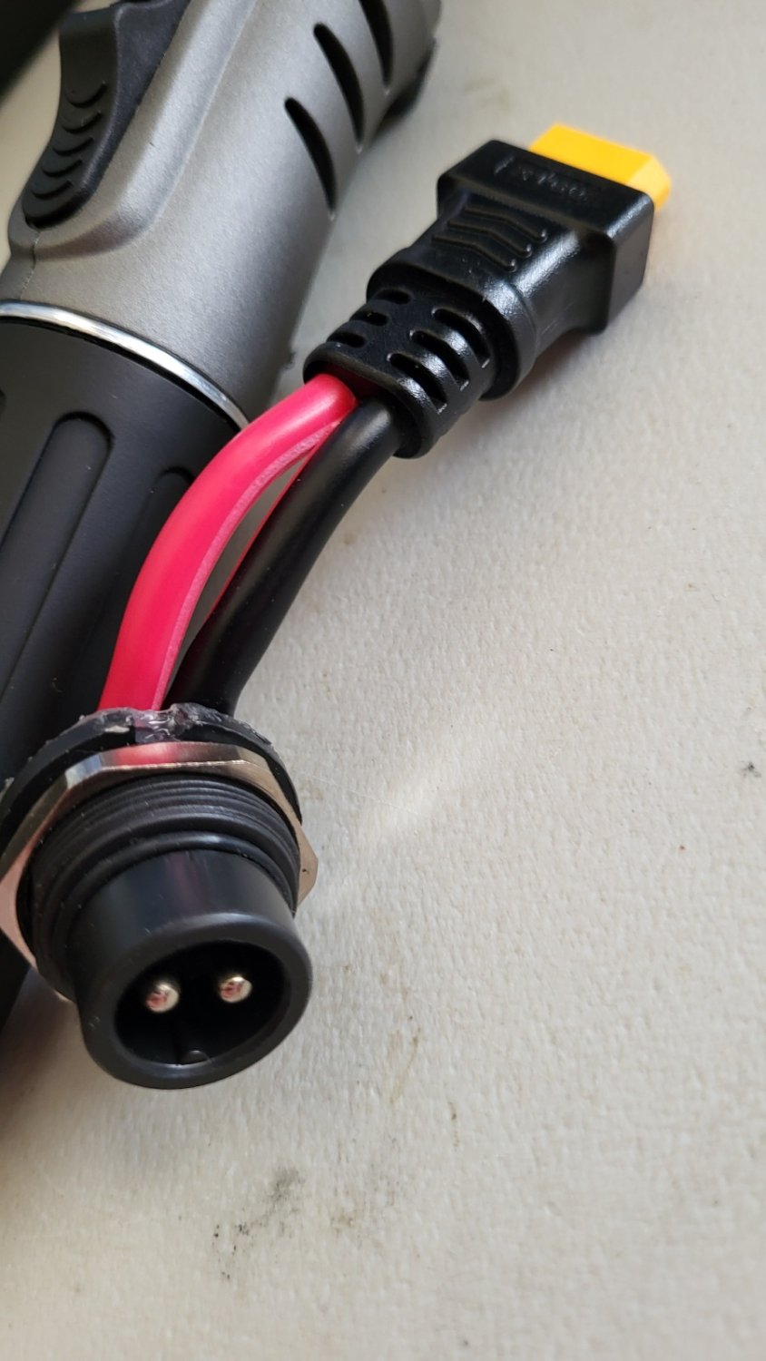

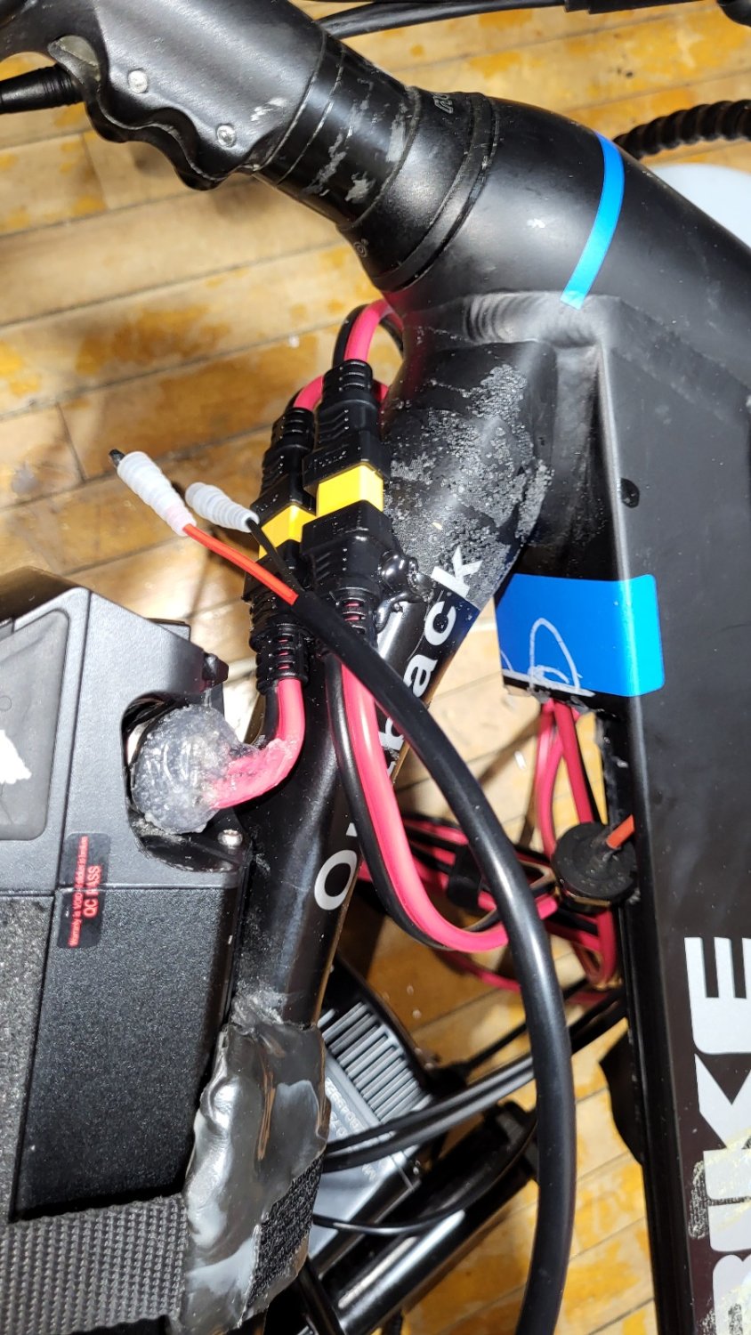

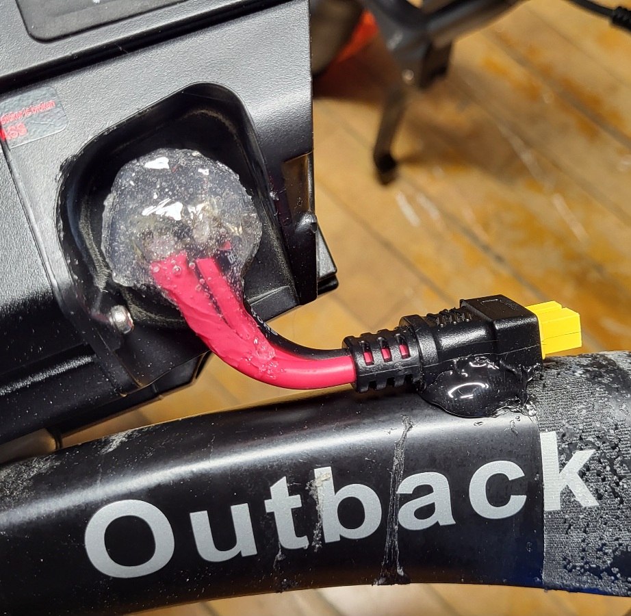

I wanted to get both battery outputs and both motors switchable from the top tube, and I managed to maintain the original connectivity of the Reention battery connectors by resoldering an old butchered up connector,..
I couldn't figure out why I couldn't get it soldered, then realized that I was using the shitty solder.
So I threw it away and used the right stuff and got it half-assed connected.
(It only looks like a cold solder joint because of the shitty solder that's mixed in.)

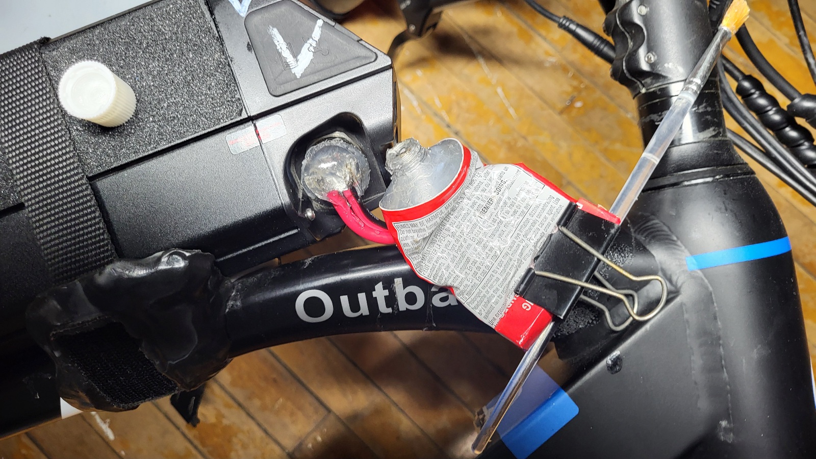

I glued the XT socket to the top tube with black hot glue (removeable with some effort) at the right twist angle to allow the socket to flex enough to disconnect from the battery.
Then I applied more Shoe Goo to seal and stabilize the socket in place.
The battery wires were live, and shoe goo doesn't conduct electricity, but the Aluminum Shoe Goo tube does a fine job of shorting out the terminals. 😁
I didn't see that coming.
I guess I shudda?? 😁

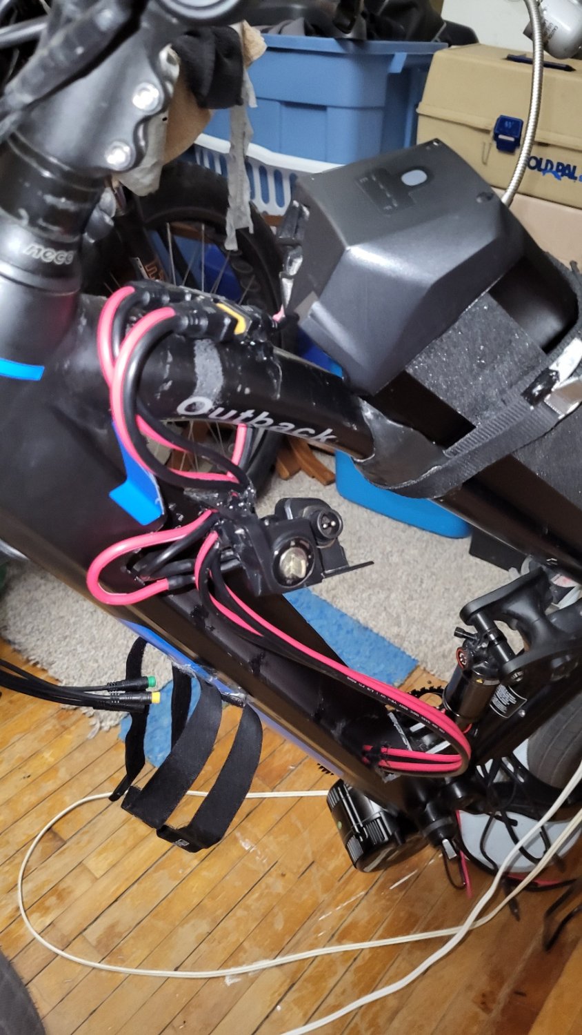

I intend to wrap the top tube with velcro or neoprene or at least color the red wires black so it doesn't look so bad.
The over-molded XT 60 cables are Fricken Huge!! 😁
I am sure @PedalUma could tell you how to hide those wires.
I used a lot of @PedalUma 's tricks to try and keep things as neat as possible.

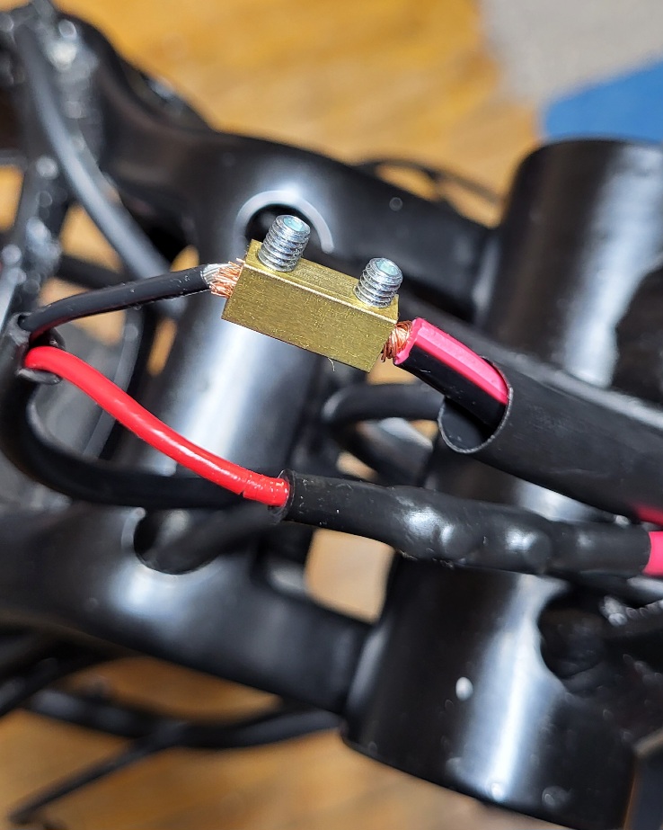

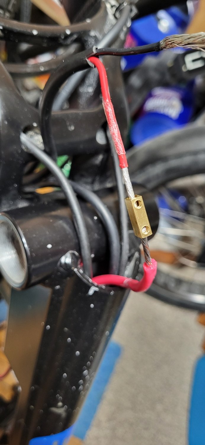

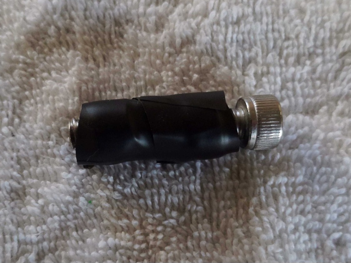

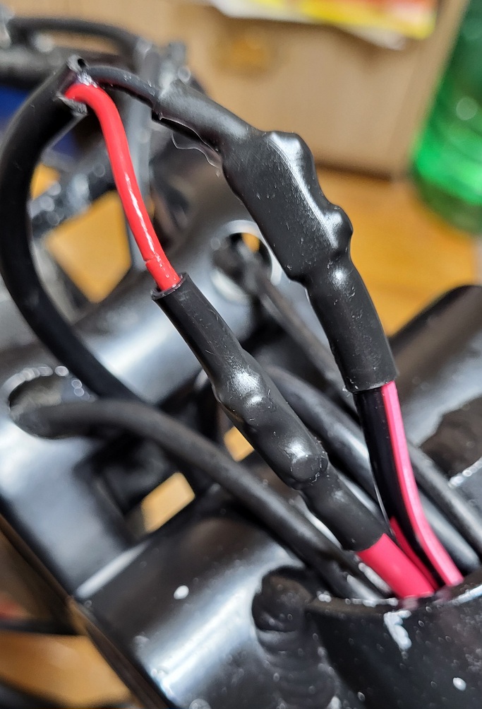

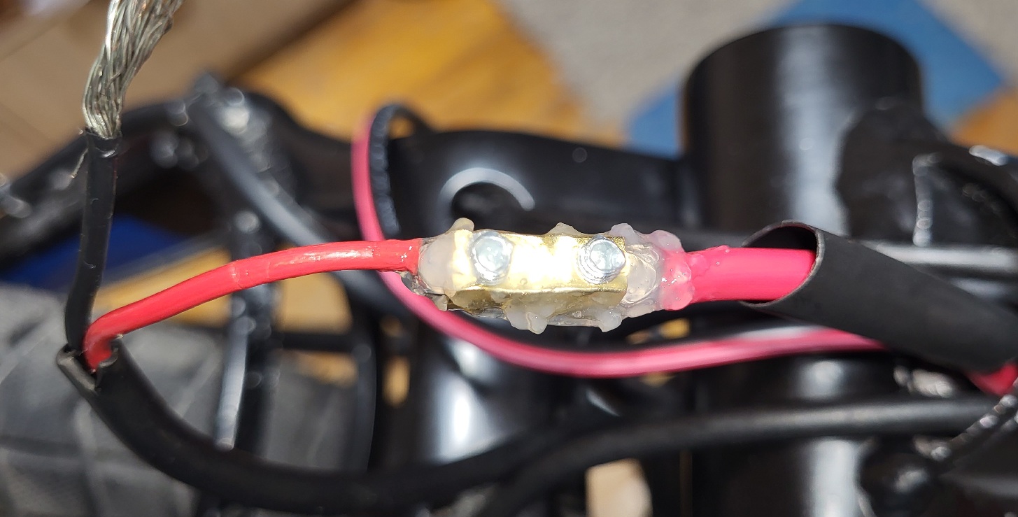

I want to keep my battery wire connections small and removeable without soldering, and I came up with this,..

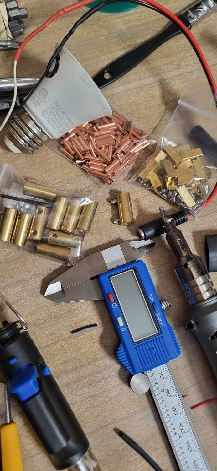

It's a 10 amp brass butt connector, but I can only get the ends of each wire under a single screw.
I've got a bunch of round 60 amp butt connectors, but they're Honkin' Huge too,..
So I ordered a bunch of 20 amp square butt connectors so I can stuff both wires completely through the connector and get two screws on both wires and both wires squeezed together.
That aughta do it. 😁
The square 20 amp butt connectors should be small enough to fit the 4:1 shrink tube over it with enough shrinkage available to seal up around the 12 gauge wire.
The 4:1 shrink tube is double walled with glue, but the glue doesn't stick if I coat everything with Dielectric Silicone Grease first.
The tube shrinks around the grease, squeezing it out, then seals it with the grease inside.
I can cut the shrink tube off without cutting into the wires to disconnect everything.

Actually, I didn't install the 12 gauge wire for power, I did it for efficiency.
I didn't realize that the connectors were so Fricken huge by looking at the pictures.

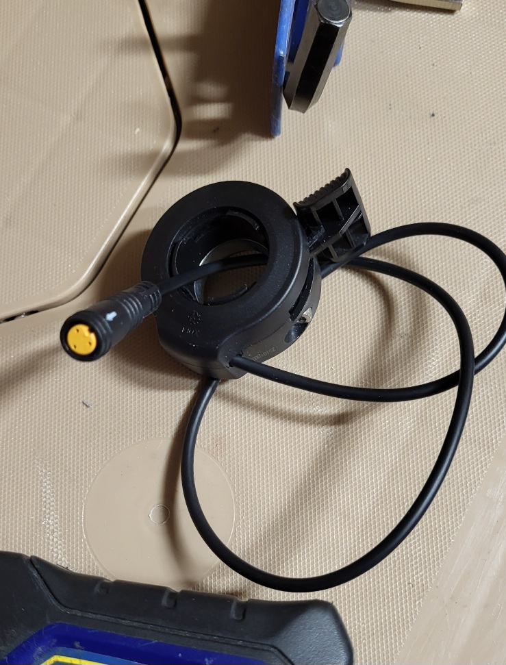

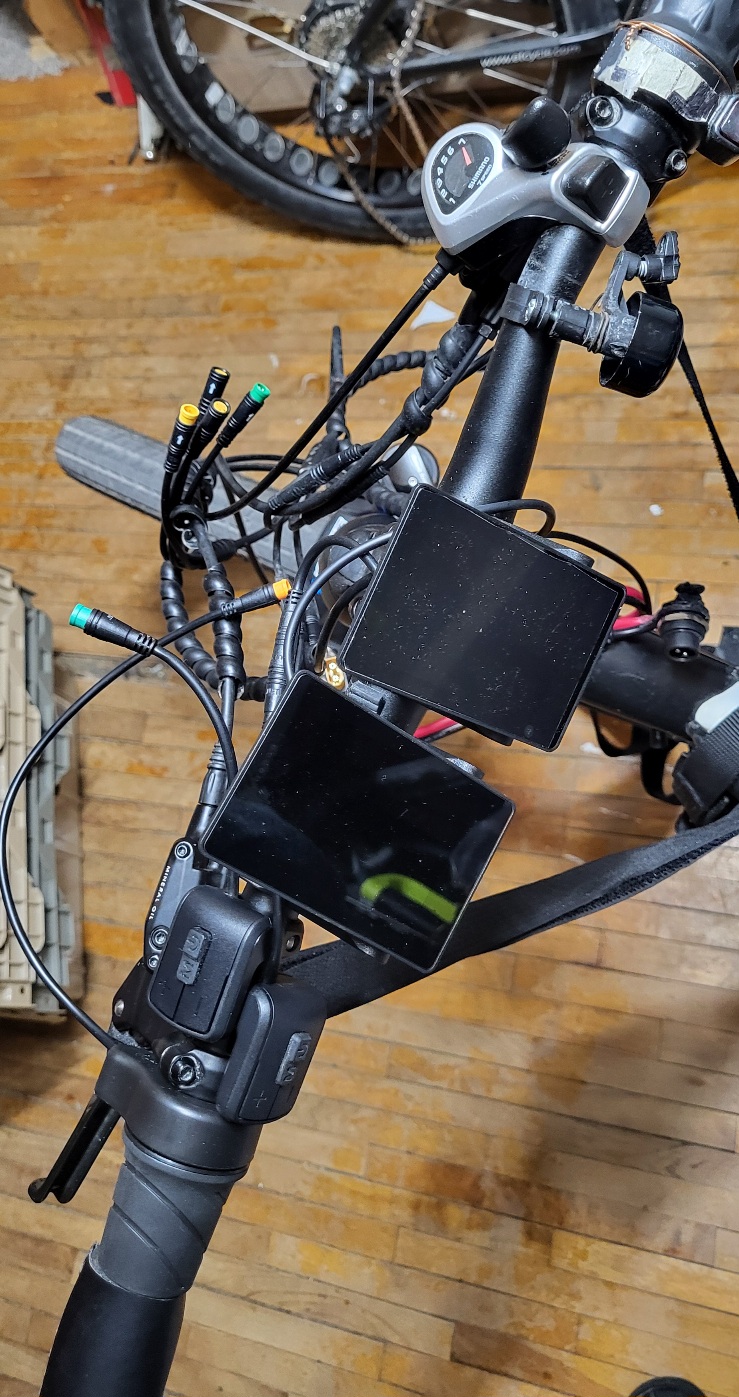

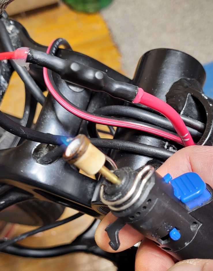

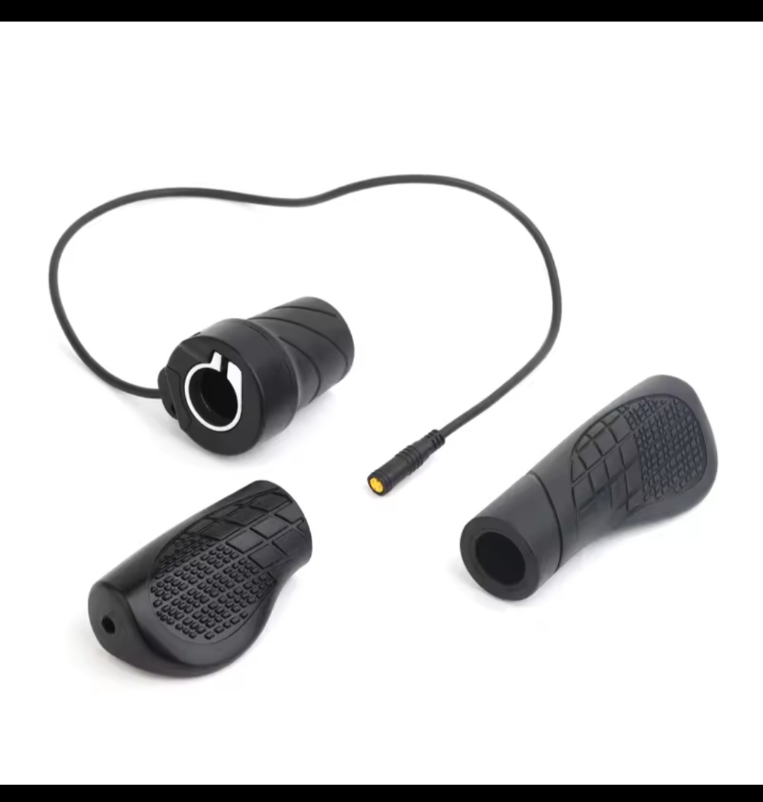

I've been working on mounting the display, button panel, and throttle for my Mid-drive motor.
I cut 1½" off the end of my left-hand grip to make room for the left hand twist throttle.
Then I noticed that it's got a male instead of a female connector.
Then I remembered that my left-hand throttle is for a hub drive not a mid-drive.
The throttle that came with the kit has a female connector,..
So I had to buy more stuff. 😁
My 20 amp butt connectors arrived and they worked great !!
I coated the connector with dielectric grease then heat shrunk it to seal it.
The grease stops the glue from sticking so I can cut it off easily to disconnect the wires, but it's still waterproof.

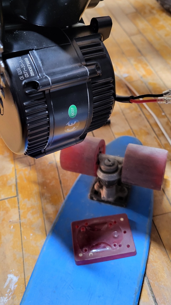

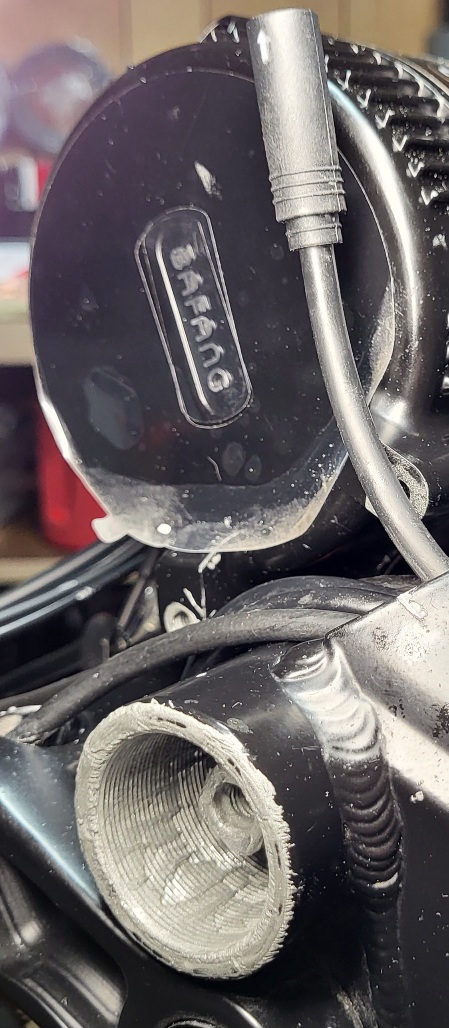

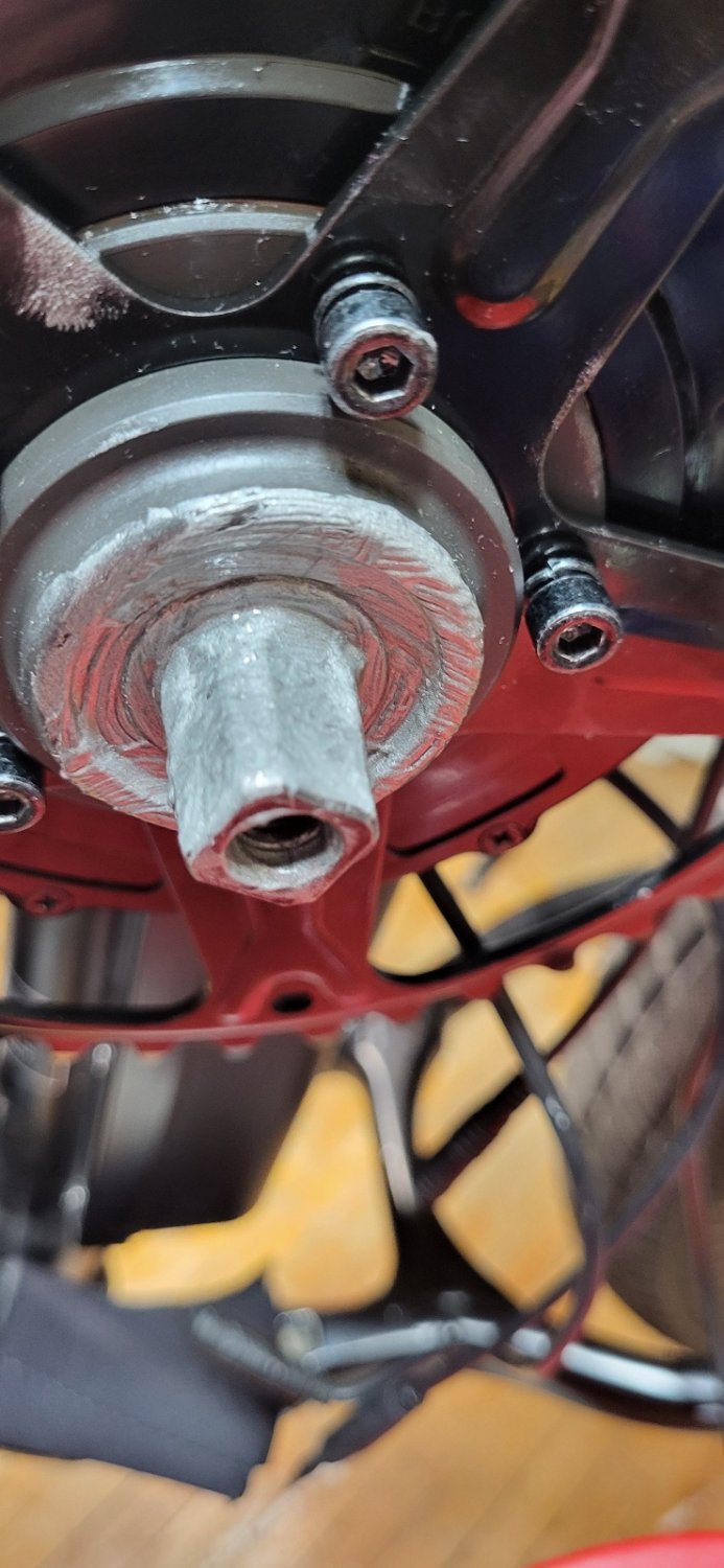

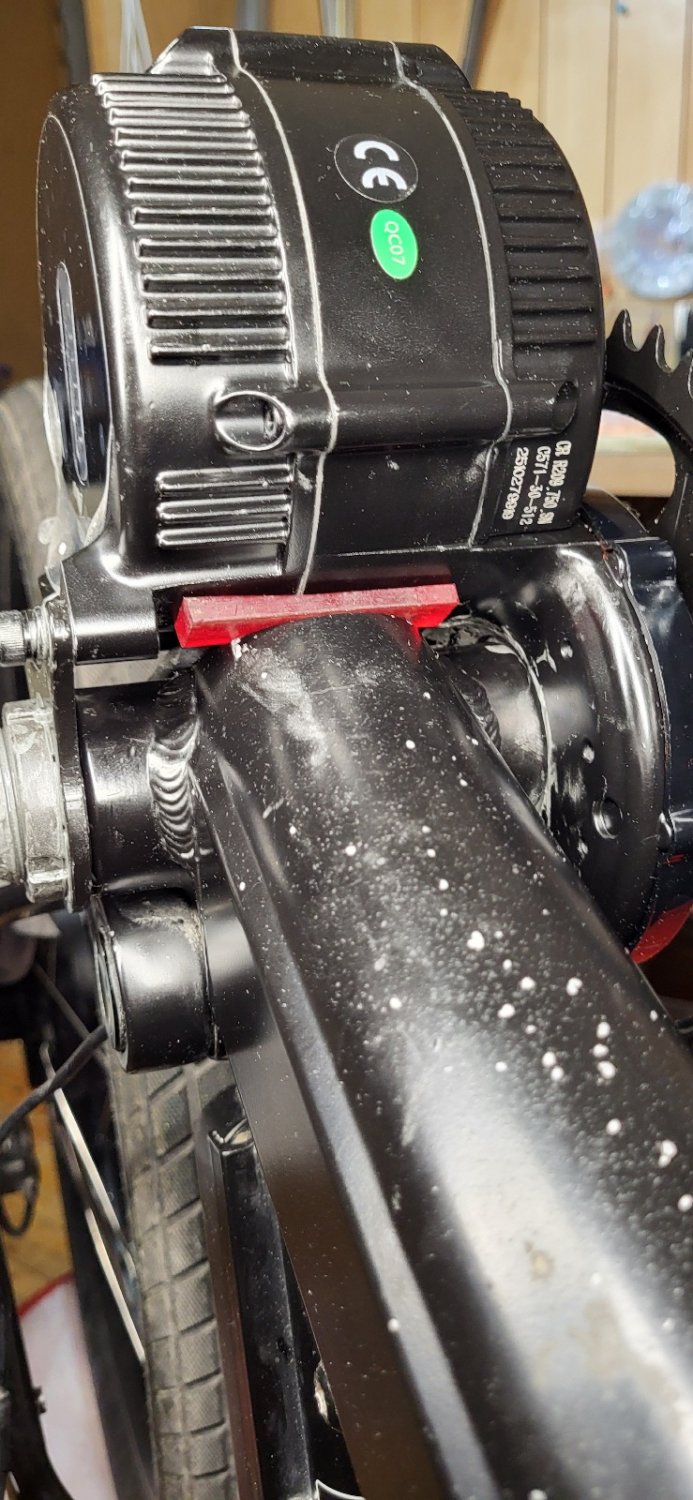

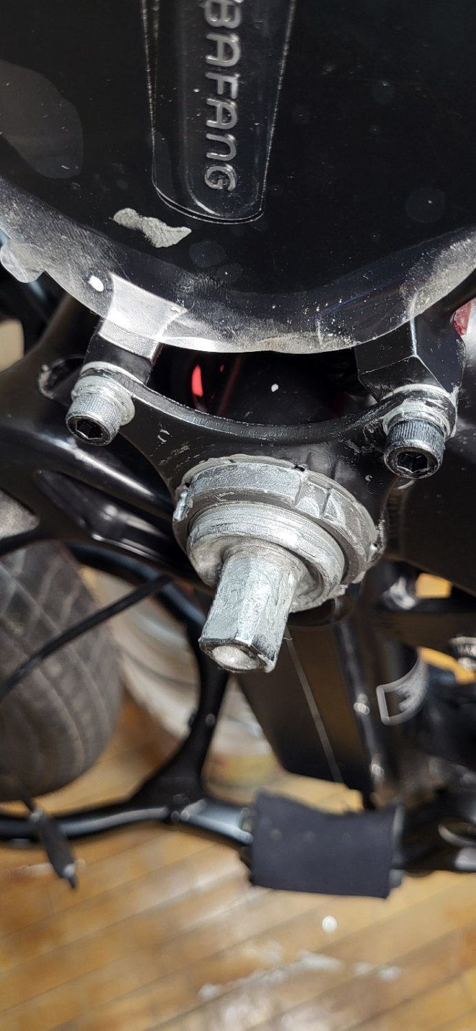

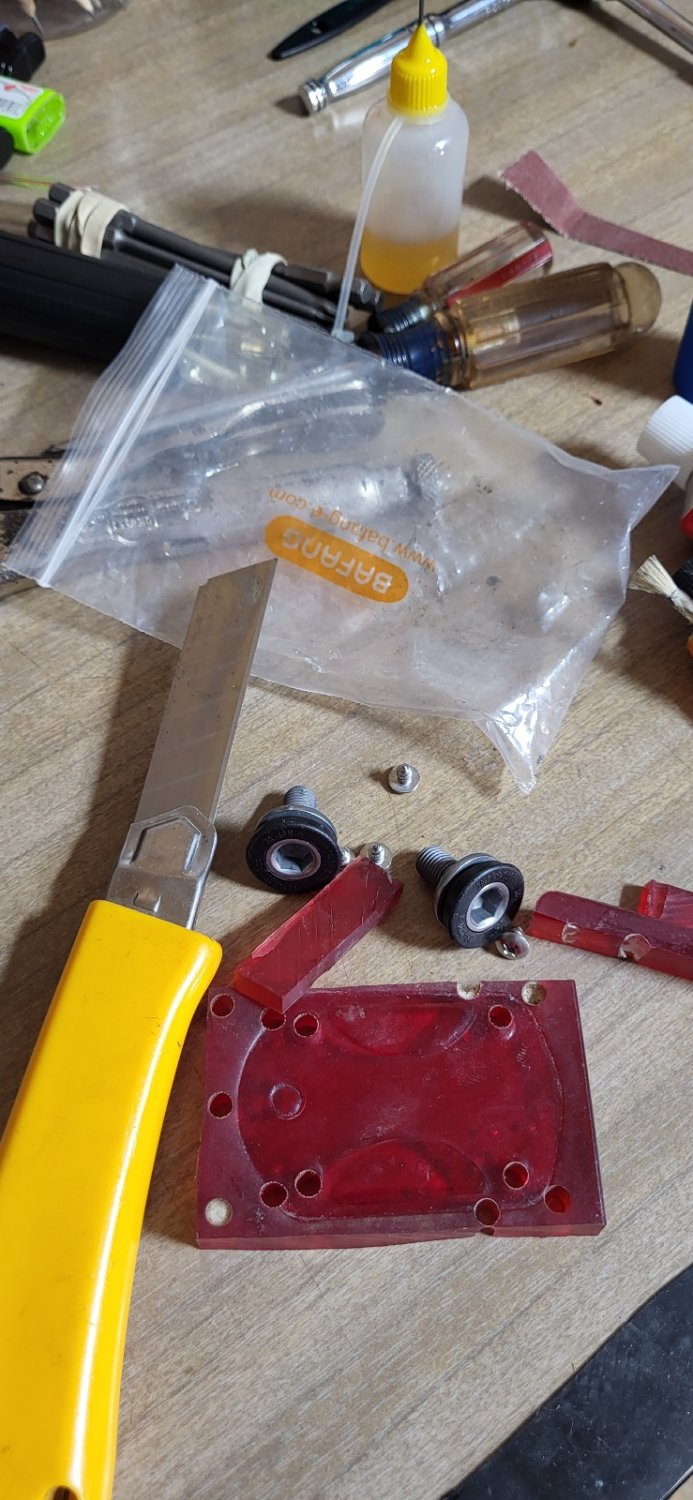

I saw these pictures from @PedalUma and I got the idea, but it won't work for my BBS02B,..
So I made a urethane bumper, and for good luck I used a shock absorber that was on my 🛹 that I bought off a neighbor in 1978.
I don’t have that 🛹 anymore but I still have the shock absorbers, and the Fancy Cutting Edge C5000 Urethane Wheels with Sealed Bearings are still around somewhere too?
I've just gotta tack it in with some glue, then preload the compression with a pry-bar under the motor when I torque down the lock ring and torque washer.
In honor of @m@Robertson and @Gionnirocket and his riding partner @il Munduato I coated Everything with Copious amounts of Anti-Seize,..
I Lathered it on Real Good.
Q-tip full in the threads too.
That Aughta Do It !!! 😁

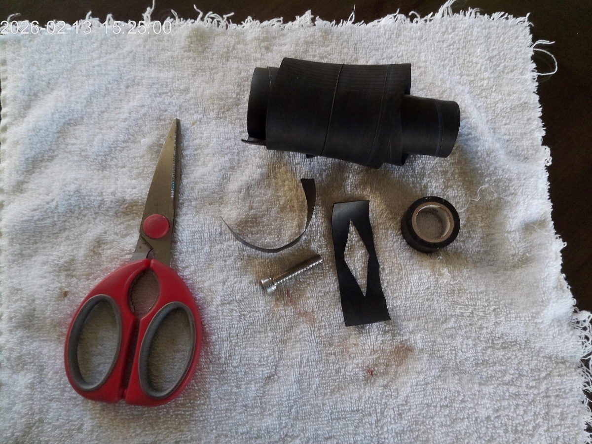

A solid piece is a much better mount bumper... I used a sliver of sprinkler funny 🤣 pipe and the round shape hugged the bike frame.
I put anti-seize on my scuba equipment... but for some reason it didn't help when I went lake diving? 🤔
I had lots of things to choose from including innertube but the urethane skateboard truck spacer seemed like it has the right durometer for the job.
I can cut an inner tube with my fingernail.
It's got a durometer of about 4 😁

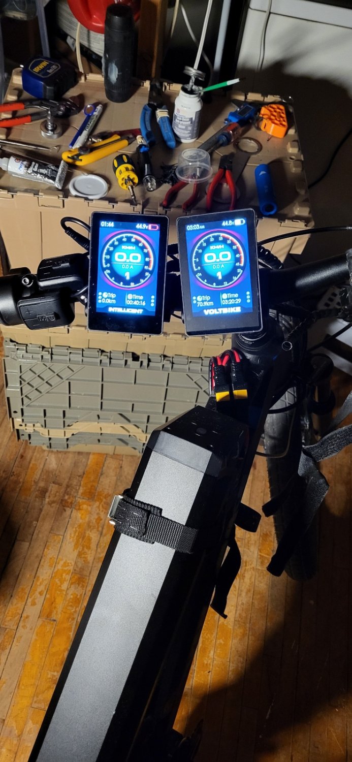

It's Alive !!!
Interestingly, the Voltbike hub motor is reading 44.8 Volts at ~¾ charge, while the new mid-drive is reading 44.9 Volts, and it in the Red.
I put that s*it on Everything !! 😁
Yeah that's what I did... Looked around the house for something hard but with a little give. The urethane spacer is much better than layered inner tube. And no electrical tape is a plus as well.
