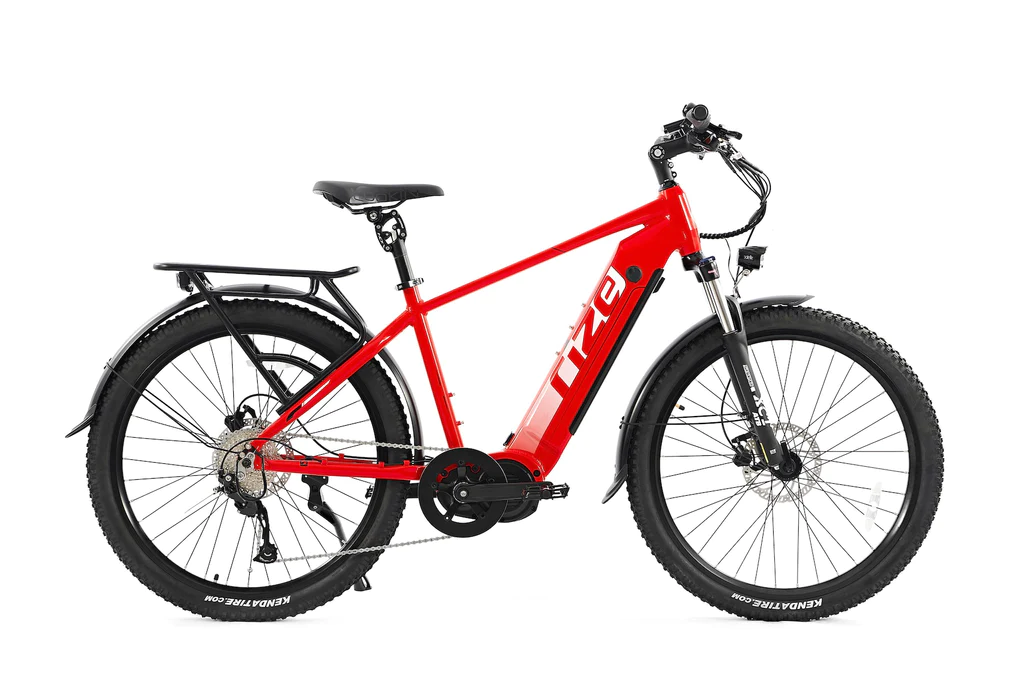

I ask this, as I have a similar Ultra powered bike, a Rize RX Pro, which is in a similar price range (if not even less money), and that bike has 1500 miles on the original chain with no real sign of wear. I was planning on updating the drive train as it wore after hearing about all of the issues some where claiming, but now find myself wondering when that will need to be done.....

The Rize RX is also a killer bike but will cost $3800 with dual batteries! $3500usd will be very hard to top for a dual battery Ultra powered bike.
All great insights!
The Rize RX is an attractive bike for sure, albeit currently sold out.
Per their website, if spec'd with the second battery and 4 inch fat tires, it would be just shy of $4,000 USD plus any applicable sales tax and shipping.
(I do like that the Rize RX has an integrated gear shift sensor, which the Etek Hunter does not have from the factory.)

The Rize is also running a 52v battery pack vs the 48v Etek
