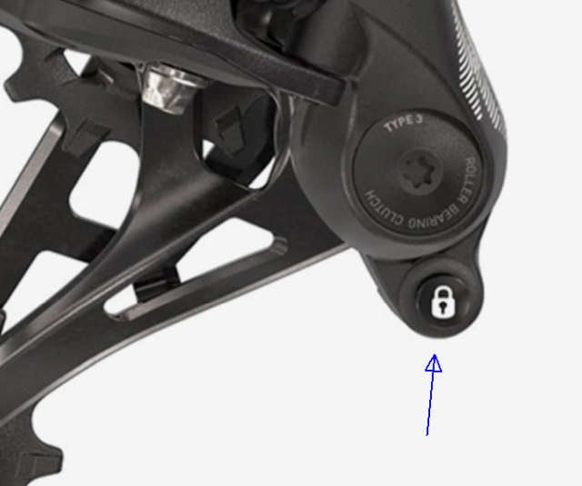

Thirdly, a gentleman here claims he cannot lock the derailleur cage on his SRAM Horizon NX derailleur. I was wondering what was that button for?

The button highlighted is to lock the cage out of the way to take the wheel off. SRAM call it cage lock.
At first I assumed it was a button to turn the clutch on and off but it's simply to hold the cage out of the way. Therefore I understand why anyone else would assume that it operated like the on/off switch on Shimano's rear derailleurs with a clutch.
The SRAM NX Horizon clutch is always locked on. It can not be locked off. It has what SRAM call it's type 3 clutch. You can find out online why SRAM say they moved to the type 3 clutch and conjecture as to why they had to. If it works then great and who should care why. SRAM is a great company. I have had lots of their products from complete SRAM MTB drivetrains to dropper posts and suspension forks.

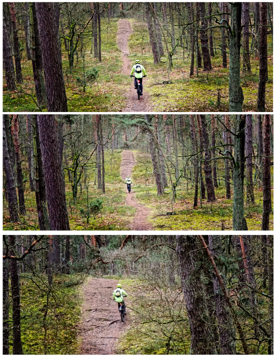

A type of trail I recently rode on Vado SL.

Lovely Photos. I'm impressed that your bike handles this terrain well. I'd use my cross country MTB but I'm super cautious.
Would Specialized view this terrain as being appropriate for the Vado SL? I am not sure of their opinion. It seems OK, their sales & marketing for the bike matches what I see in your photos but perhaps the gradients are too steep or there are too many exposed tree roots to dodge? Specialized have buried the intended use of the Vado SL in Appendix A of the owners manual. It says the Vado SL is designed for Condition 2. Bikes designed for condition 1, plus smooth gravel roads and improved trails with moderate grades where the tires do not lose ground contact. The intended use is paved roads, gravel, or dirt roads that are in good condition and bike paths.
My chain drop happened on the Trans Pennine Way in the North of England, which is designed and maintained to more than meet Specialised Condition 2 intended use. But chain drops happen, that's not my concern other than it should be minimised due to inconvenience. What is my concern is that the version of Vado SL I received traps the chain between the frame and the chainring. The chain can not be removed without unbolting the chain ring from its spider. This is more than a minor inconvenience, It's a major inconvenience and potentially very dangerous for the rider when it happens. Perhaps my original reply should have made this issue clearer.
