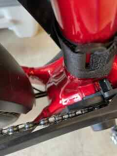

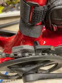

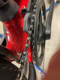

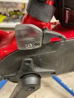

I have a 2023 Turbo Vado 4.0 since beginning of September. I’ve had the chain drop three times all while going uphill at a significant incline (max wattage input by motor and me). I played with some adjustments after the second time but got another chain drop the other day, so…. I decided to make my own chain keeper out of plexiglass taking advantage of the existing bracket on the Vado for the chain guard. Here are some pictures

Getting Creative. That's Great! The bend, like cross chaining is too much. Looks like an 11-sp chain. Better off going with a slightly smaller narrow/wide chainring. Large ones will drop more easily. Smaller will not drop but are slower on the top end, and they climb better. Narrow/Wide grabs the chain better, look for four hole, 110BCD on eBay, $27. Next, a nine-speed cassette of gears can offer the same over all range with a wider, stronger chain. These are on that big South American River site for $30. A KMC 9-sp eChain is another $32. I am loving the Box 3 9 Prime 9-sp 11-50 group sets.

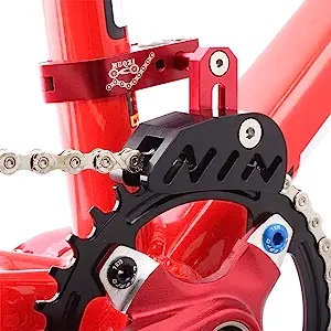

I ended up converting my temporary fix above for my 2023 Turbo Vado 4.0 to a more permanent solution. Since then, no chain drops, but I can tell the keeper is doing its job as there is a little wear on the nylon guide. By the way, the inspiration for this fix is based on the chain keeper that Specialized used its 12-speed mountain bikes (my Levo SL), so it is not an unusual solution.
I purchased the following from Amazon (comes in red $28 or black $18):
Bike Chain Guide MTB Bike Protector Road Bicycle Mountain Cycle Chain Guide Tensioner with Hollowed Design for Single Disc Sprocket, Front Dial Smooth Driving(Red)​
You will notice I had to replace the red aluminum vertical piece of metal with a longer piece of aluminum which I had to drill holes.
