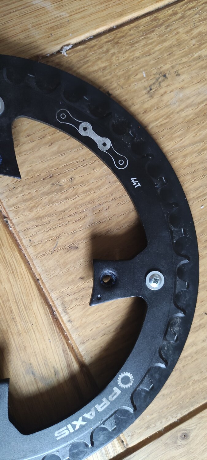

The Vado's chainring guard is made of plastic and screws into special holes in the Praxis Chainring.
That is the special solution of Praxis used not only for Vado SL but also on the bigger Specialized e-bikes such as Vado or Como. The Praxis spider holes are threaded, so it is possible to fasten the chainring only using the hex wrench from the outside. The reason is a very tight clearance between the chainring and the frame/motor, making it difficult to use any nut from the inside. The bashguard is connected by small screws from inside of the chainring, so installing the bashguard is done with the chainring off the bike.

Stefan, You strike me as a person that knows the trick of placing the chain on the chainring in accordance with the maker's specification. It's more obvious with narrow-wide chainrings. But I found that the design of the Praxis wave tooth pattern allows one to incorrectly place the chain, which is presumable why Praxis print the guide in white. In my experience, both the Praxis and narrow-wide chainrings allow the Vado to be moved in reverse without dropping the chain.
Or put another way, it's worth checking how one's chain is placed on the chainring. If only to discount this as a potential problem, particularly if you have a wave pattern Praxis Chain Ring.
Hmm... When you place the chain on the chainring, just look at the chainring and chain from the top. It soon becomes obvious what the correct pattern is. The diagram on the inner side of the chainring makes the operation a no-brainer but the experience comes fast. (Looking at these two items from the top was a brilliant idea of a German Forum member @TS25 who seems to have lost his interest a long time ago but he was the person to give the best advice to me!)

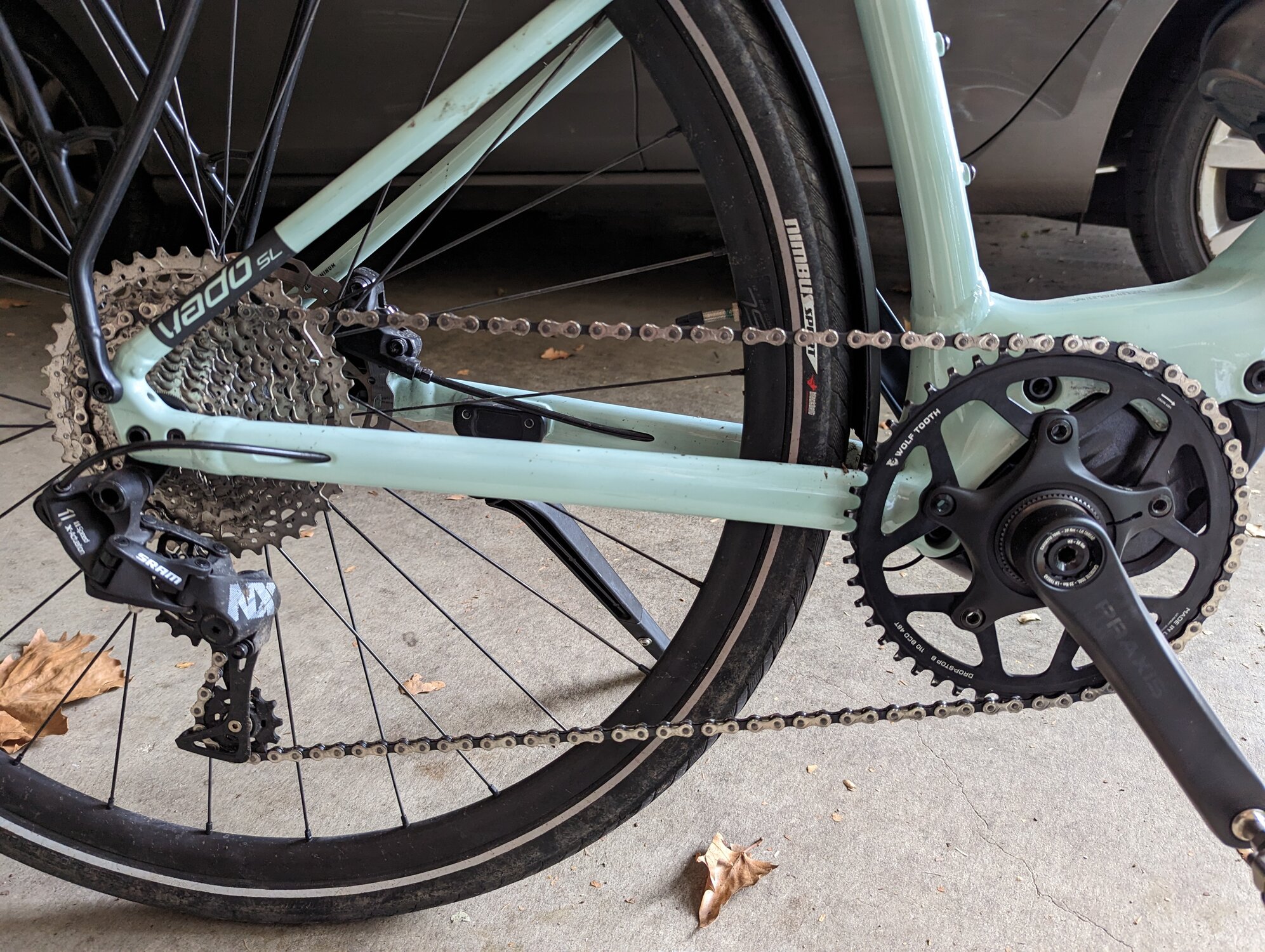

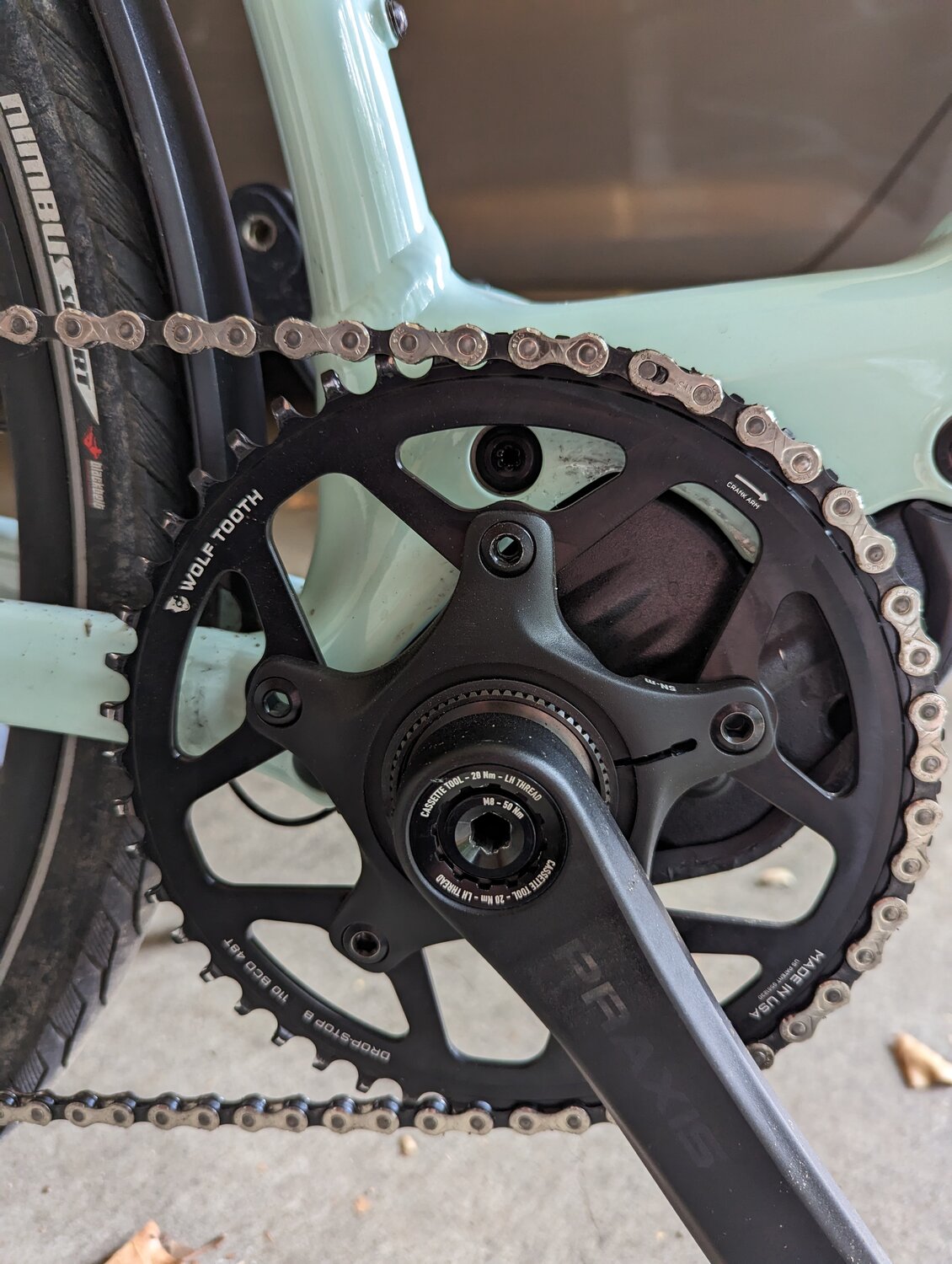

Thought I'd tell you about my experience with random and then permanent dropped chain and it jamming between the chainring and bike when shifting into the largest cog in the rear cluster of my Turbo Vado SL 4.0 EQ.
My Specialized dealer finally fixed the problem by changing the chainring under warranty - the bike is still less than a year old. I now have a Wolf Tooth Drop Stop and it seems to have finally fixed the problem. Gear changing has never been smoother too.

Yes, the derailleur cage can easily be moved by hand at any time. It has a button to hold the derailleur out of the way to aid wheel removal. But there's no on/off button or a way to adjust the tension on the derailleur, which when compared to my experience of Shimano's XT the SRAM Horizon NX has very weak tension. i.e. the SRAM Horizon NX clutch doesn't resist chain slap enough to work with the Praxis front chainring and in light offroad/pathway riding the bike is susceptible to the chain coming off the front chain ring. This would be a mild inconvenience if it wasn't for the fact that the chain gets stuck between the frame and the chainring. In the old days of front derailleurs, you would adjust the limit screws so the chain could not get trapped in this way. It's up to Specialized to specify the appropriate drive chain components for the intended use of a bike. Specialized, like many mass-market manufacturers, chose to mix and match drivetrain components from different suppliers. Specialized take a risk when it does as there is a risk that tolerances need to be higher than that designed into the individual components. Other bike manufacturers stick to a complete drivetrain from a single supplier (historically SRAM, Shimano, Campagnolo but there are others.).
I suspect that it's a relatively rare occasion when it happens, maybe after somebody has had the bike for a while and it's put down to poor maintenance or owner ignorance.
I had this happen twice during the break-in period. Both times when either going into the lowest (easiest) gear or going from the lowest to the next gear. My dealer did an adjustment and changed the chain as well at no cost to me. It hasn't happened since but I am careful not to go into the lowest gear unless I'm within a couple of miles of my home. And you are correct that it would just be an inconvenience except that the chain gets really stuck between the frame and the chainring, and it took about 20 minutes each time to get it out. Not even shure how I got it out. And there is no chain guard. Apparently the Creo Sl had enough of this problem that they made a chain guard that works on the Creo Sl but not on the Vado Sl. This is what Specialized Rider Care said when I asked if the one for the Creo SL worked on the Vado SL: "The Turbo team has confirmed this chain guide unfortunately will not fit on the Vado SL. The bolt hole this attaches to is too deep." On the Creo the bolt hole is on the motor housing. One would think it would be possible to find a longer bolt to get this to work on the Vado Sl.
