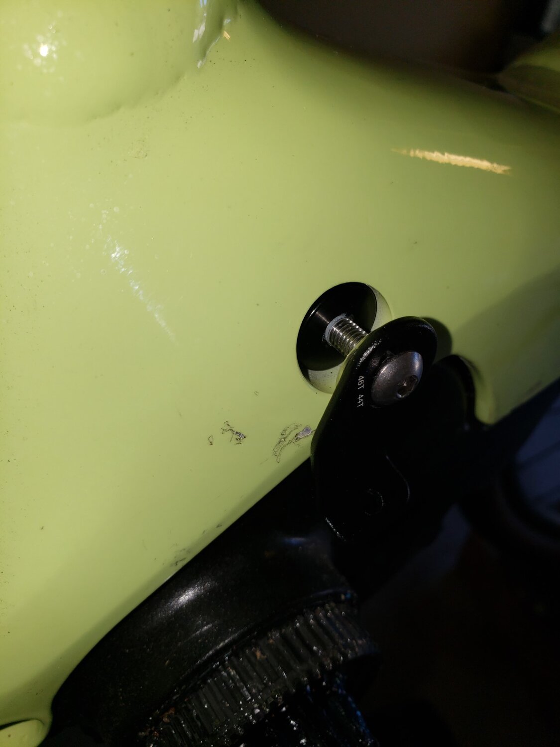

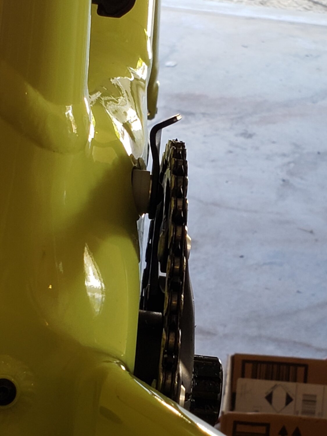

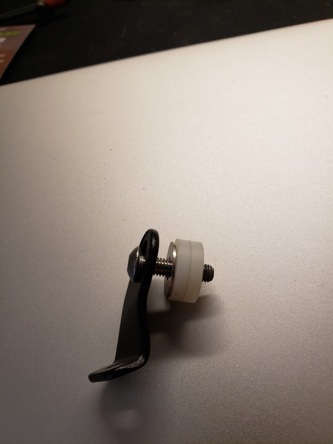

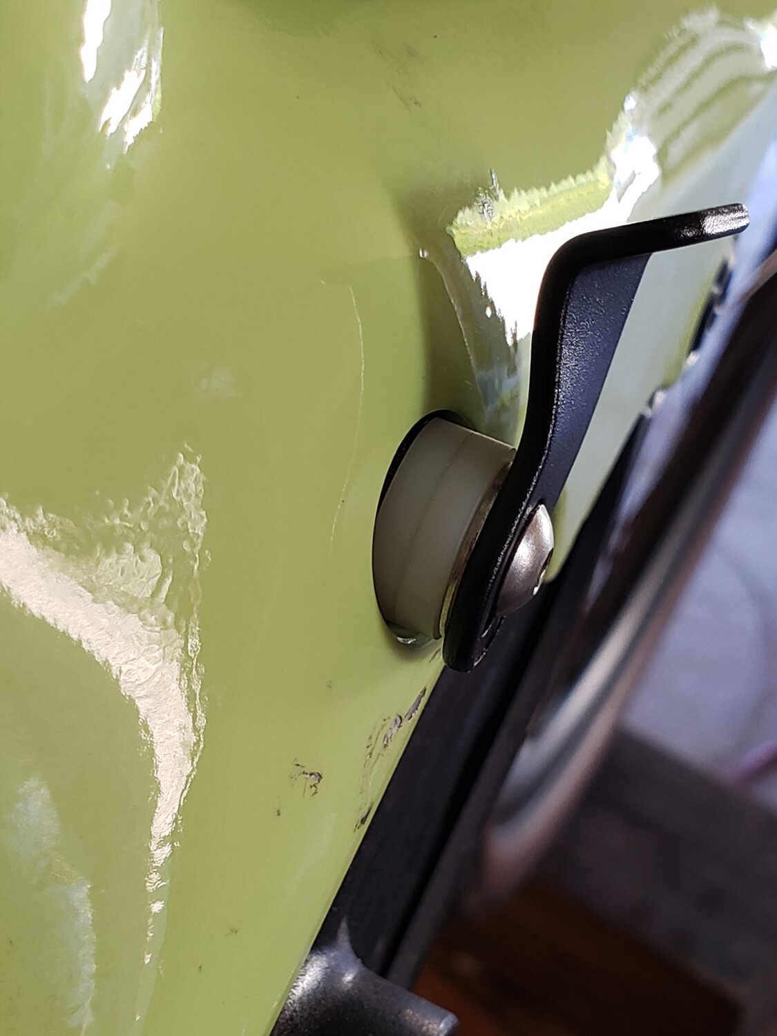

I installed the Creo SL Chain Guide today on my Vado SL. The Vado SL's motor mounting bolt hole is recessed too deep for the chain guide to simply bolt on as the guide is larger than the hole and the frame doesn't have a flat surface either. I had two nylon spacers laying around and they were a perfect fit for making a standoff to mount the bracket. The space between the chainring backside and the guide is maybe 2mm at best which should stop a dropped chain from lodging down between the frame and the chainring. I might tweak the top of the guide down a tad for a closer fit but I'm going to wait a bit to see if that's necessary.

Just to be clear. The bolt you used is one that came with the guide, one you removed from the motor, or a longer one you found?
I just used the supplied fasteners. The chainguide comes with a new motor bolt that has a threaded ID and the screw that comes with it to mount the chainguide. The screw still had about 6mm of engagement with the spacers. I used blue thread locker.
