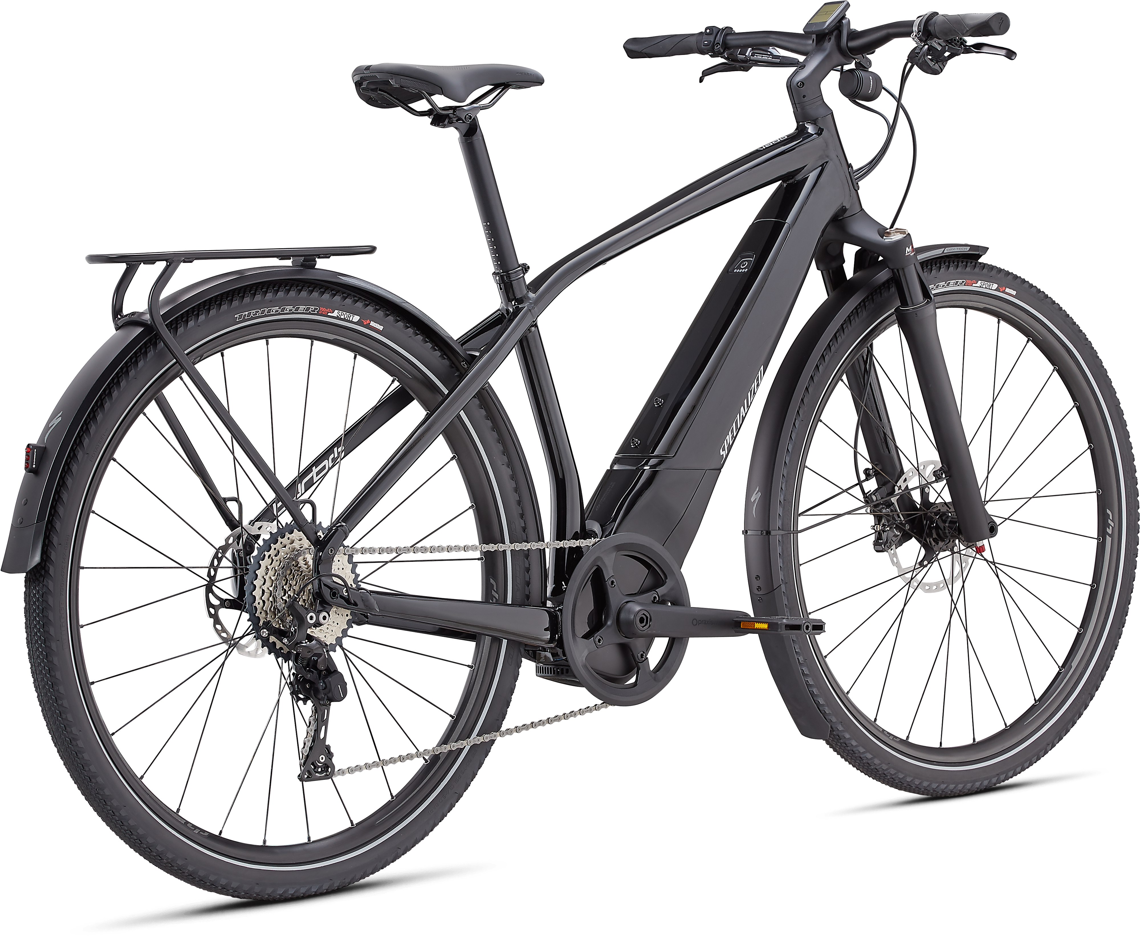

On my 2022 Vado 5.0, it happened again. (3rd time in 2500 miles/4 months+)
I upshift and downshift quite frequently, depending on terrain, speed, and cadence.
Much like almost having a seamless CVT transmission, but in reality an 11-speed setup as OEM.
I changed the cassette at about 1800-2000 miles, and the chain also.
I have used an ultrasonic cleaner and hot wax exclusively and never really have any problems.
However, today was the 3rd time in the last few months (both 'old' and 'new' cassette/chain) that while downshifting the chain just comes off the chainring and gets jammed up behind it. I lock down the derailleur and put it back and I'm good to go.
Is this expected behavior or am I doing something wrong or is there an adjustment needed?
I really have no problems with the shifting otherwise.
Do you already have a narrow-wide chainring?
It's not obvious in the picture.

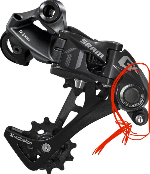

Additionally, either I'm blind or? I don't see a 'clutch lever', as I had on my previous Vado. (2021 previous, 2022 now)
Does a SRAM GX rear derailleur have a clutch?​
If so, please show me where it is?
Thanks
there are a couple different GX RD. is it this one?

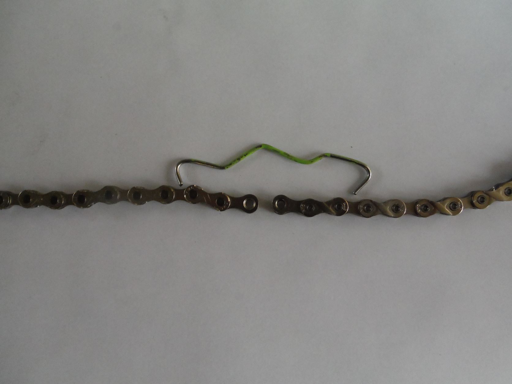

See if you can get away with one less link. Were you in a high gear? That is when the derailleur is most slack, or not providing much tension. The way to check if the length is correct is to make a chain hook from a spare spoke. It is just a 75ish mm length with a hook at each end that pulls a chain together.
I was in 4th gear. I appreciate the suggestion, @PedalUma but am a bit confused: if I make a hook, what then am I looking for? slack? Sorry for being dumb n00b.

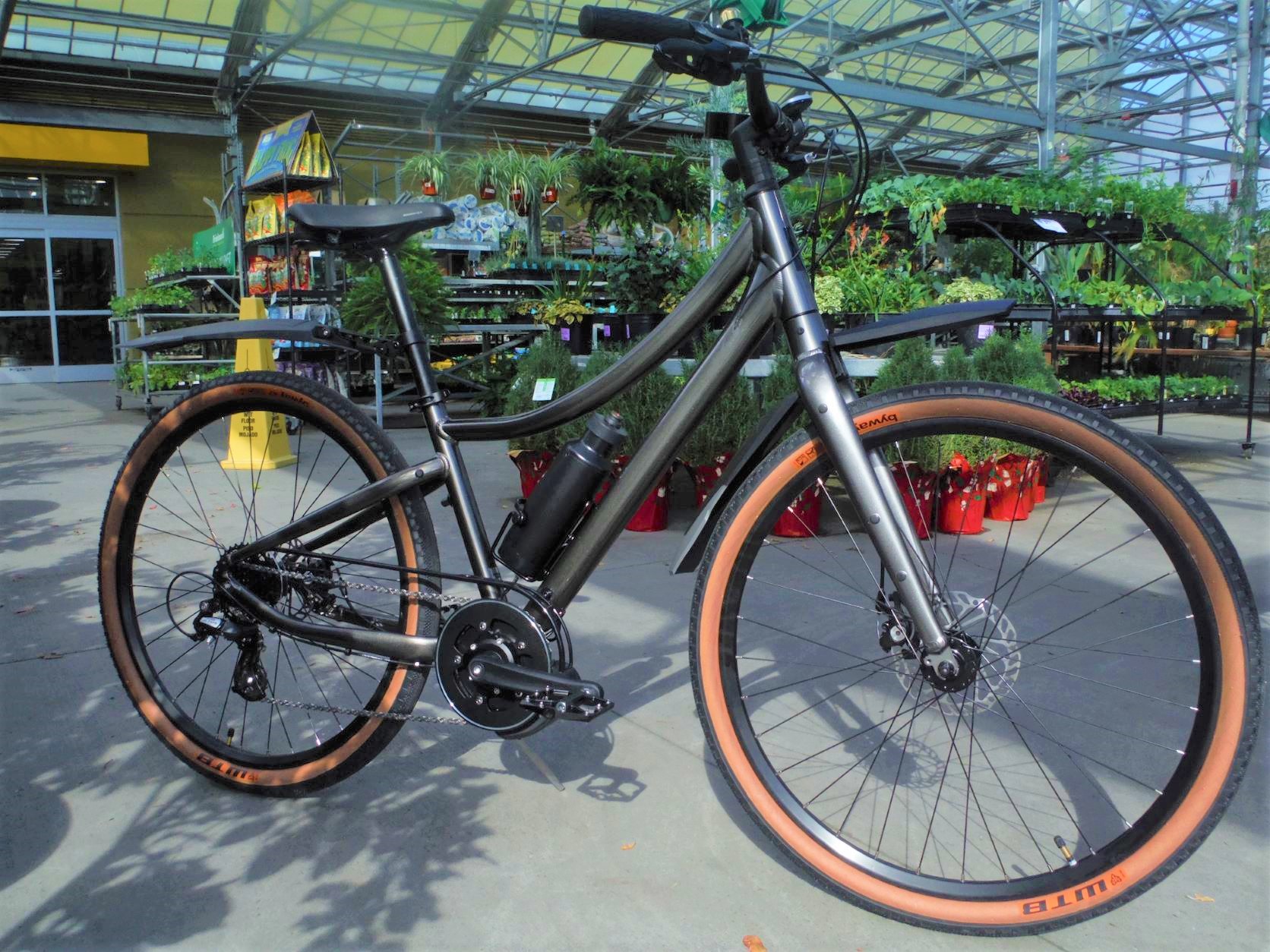

It is all good. See a Park Tool video that shows rear derailleur setup as it relates to chain length. The hook will show if you can take out a link while not having it too tight in first gear. It took me awhile to get up on the curve by making mistakes. I am attaching a photo of a bike I made electric today. 85Nm, torque sensor. It was a non-electric Giant Momentum Vida Mid-step. I changed a bunch of things about it plus, adding the mid-drive.
Right on, thanks so much! I'll check out Park videos and see what comes of it.

The SRAM GX 1x11 X-HORIZON Rear Derailleur features a built in clutch and a Cage Lock to make it easier to remove the wheel. I suspect the Praxis chainrings wear faster than normal on an e-bike. After about 3700 miles (6000km), I started to get random drops with old chain, new chain, clutch off and clutch on. I switched to a Wolftooth chainring because I wanted a 42T and I have not had a dropped chain in the last 500 miles. It may be random chance but it seems to be fixed with a new chainring and I won't worry about it until it starts up again.
