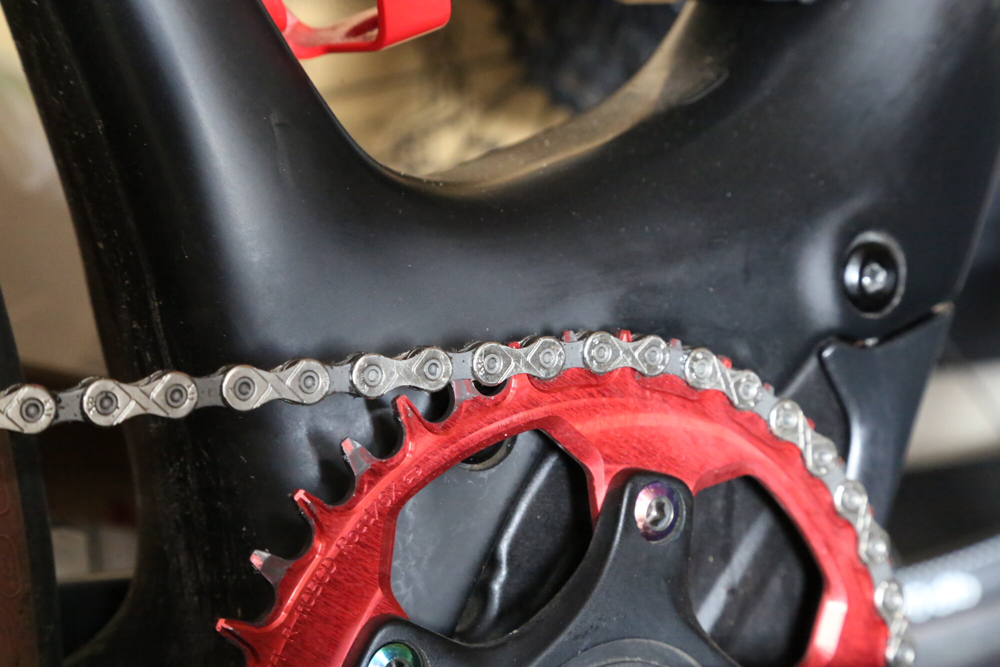

I use a Garbaruk Chainring on my Creo. As you will see, it has taller teeth that engage the chain more securely and never had a dropped chain. This chainring is also half the weight of the Praxis one and excellent quality. Highly recommended from me.

Check your chainring b4 you buy a new one. Some Creos (my 2022 for one) have 107bcd with 4 bolts. Others have 5-bolts chainrings, not sure of bcd.
The chainring mine came with is SRAM AXS X-sync. No drops so far.

I wanted to change to a 42T for better climbing. I went with a Wolf Tooth chain ring and I have not dropped a chain since I changed. I tried to test my backpedaling idea with the Praxis but could not reproduce the chain drop. I think the Praxis is light weight and maybe wears a little faster? I did not have any drops until after 3500 miles.
Pretty sure the Praxis is Aluminum to. My Garbaruk was half the weight and much better made. The higher teeth profile has never dropped a chain, even on back pedal.
