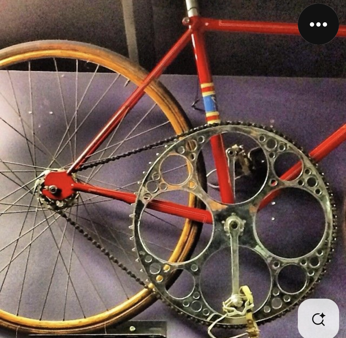

I’m picturing this. It sounds like if the chainring is too large/tall then, the angle from the top of the low gear to the top of the chain ring changes upward. This would mean that there are less teeth engaged on the lower gears. It shouldn’t matter much on the lower part of the smallest cog because the chain still goes immediately through the derailleur.
Here is a dramatic increase in the angle of the chain, but you’ll notice how high the chain goes towards the chainring. 120t!
I think that is part of the problem. A minor cross chain can be handled by similarly sized cogs. But on a large one the force is also pulling down as it also pulls sideways. Also the distance to the first tooth touching the chainring is reduced and is further to the rear. This all leads to derailment.

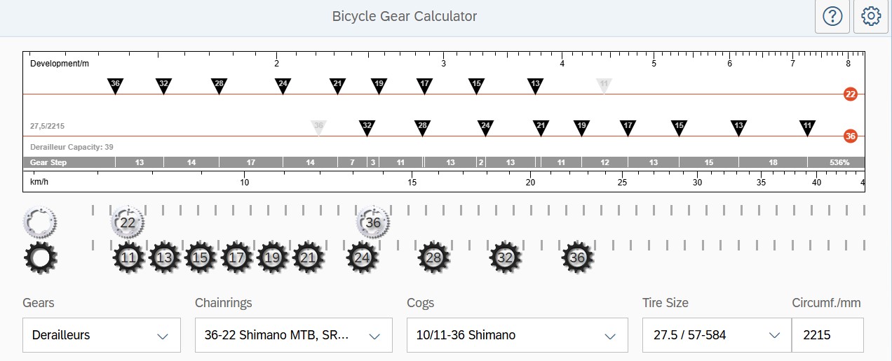

use this:
Gear calculators are a great place to start but they don't take into account ones physical abilities
I've come to the conclusion that what looks good on paper doesn't always match up with what my chicken legs are comfortable with. 🙃
