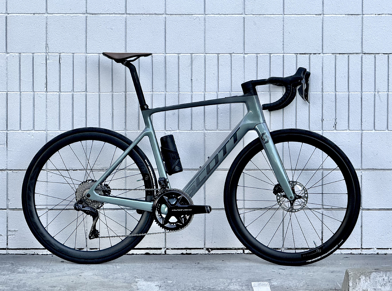

i didn't like the color of the addict that came with the build i wanted, so i got the next tier down and changed out the cockpit, cranks, cassette, and am in the process of changing the saddle and seatpost. here's the bike :
it weight a bit under 24lb - so while it's lighter than the creo, 15% isn't so much different that you don't know it's an ebike. it has almost the same di2 drivetrain (a mix of dura ace and ultegra in this case) as my aethos with a 52-36 up front and 11-34 in the back. i was in between this size and the largest size, so i went smaller and put a 130mm one piece cockpit on it, which i like a lot. haven't fully set up my phone mount and a couple other details.

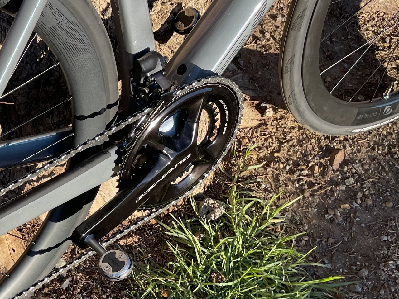

1) the "bike" drivetrain is way better for a road bike, period. nearly instant and smooth shifting even under load, and no motor effects on the drivetrain.

finally - and this may be an important factor - i don't think the scott LBS network is very good in comparison to specialized. i have several very capable specialized dealers/shops within a short ride of home, and know them well enough to know what they know and what they don't. the shop i ordered this bike from is really great, nice, good selection of many types of bikes, but they do not see many of these, don't specialize in road bikes or e-bikes, and there were a couple mistakes that not even i would have made... like not adjusting the front derailleur's vertical position when changing to a crank with larger chainring! quick fixes, of course, but not confidence inspiring!

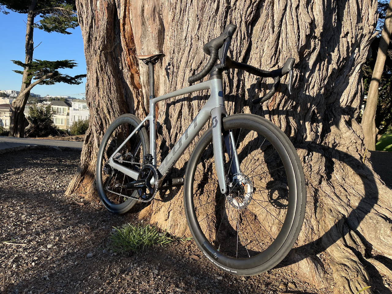

no exposed cables or hoses anywhere

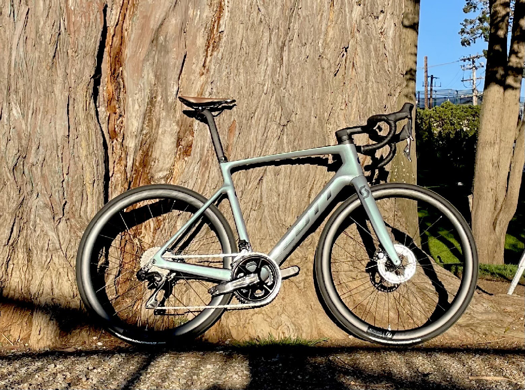

 it's a nice greyish color with some irridescence. i do not like all the scott logos, but it is what it is.
a familiar and well loved drivetrain
