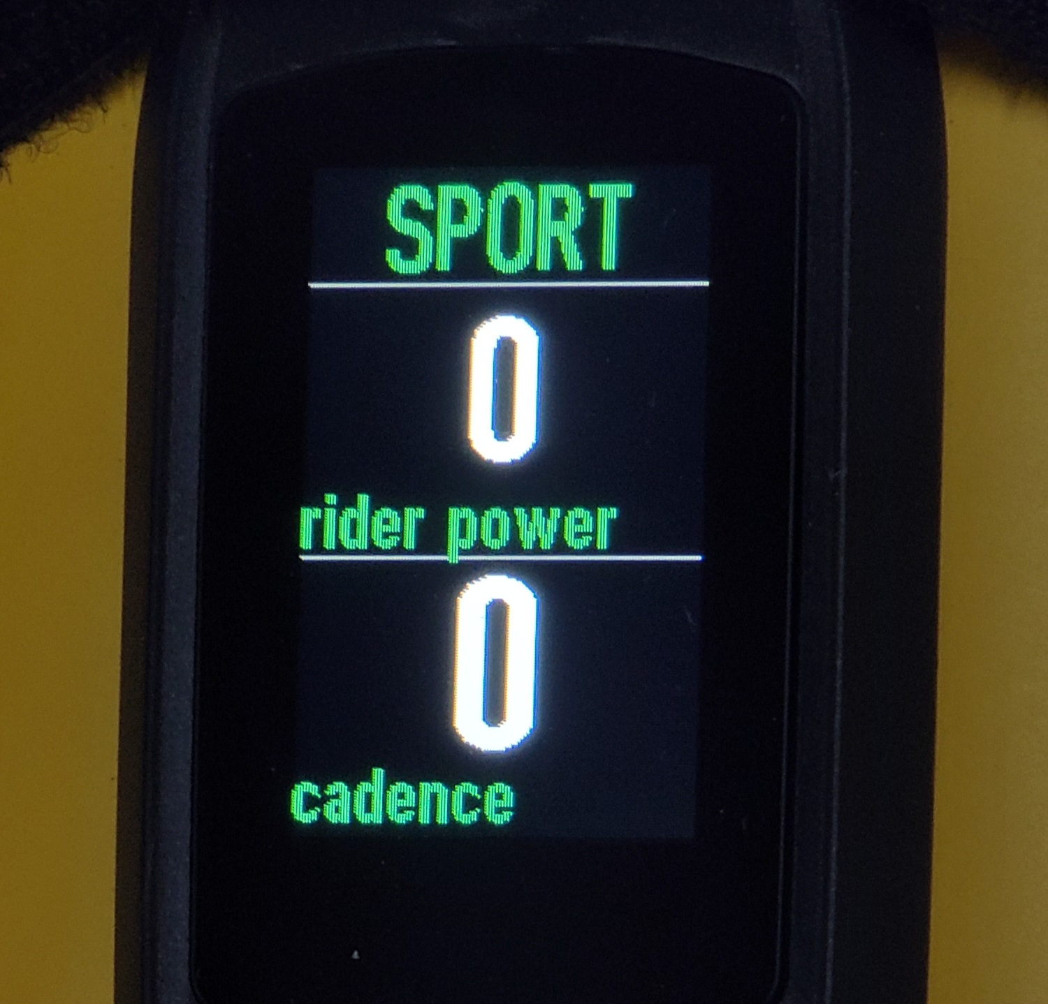

Specialized says that their mid-drive motors use internal sensors to measure true cadence and rider power directly, with real-time rider torque presumably calculated from that data stream in firmware. Since the main determinant of mechanical motor power in their mid-drive PAS is rider power, I think of it as a power-sensing PAS.
I observed that it also uses cadence as the motor doesn't kick in if I'm just pushing on the pedal with the bike not moving.
Most so-called "cadence sensors" do nothing more than return a yes-no answer on crank or cassette rotation. For safety reasons, all ebikes need this capability. Some higher-end ebikes like the Specialized mid-drives also measure true cadence in RPM and report it on their displays.
Custom display page on my Specialized Vado SL mid-drive. SPORT is the current assist level.
