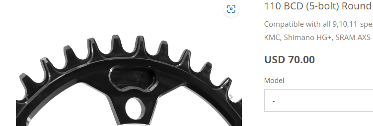

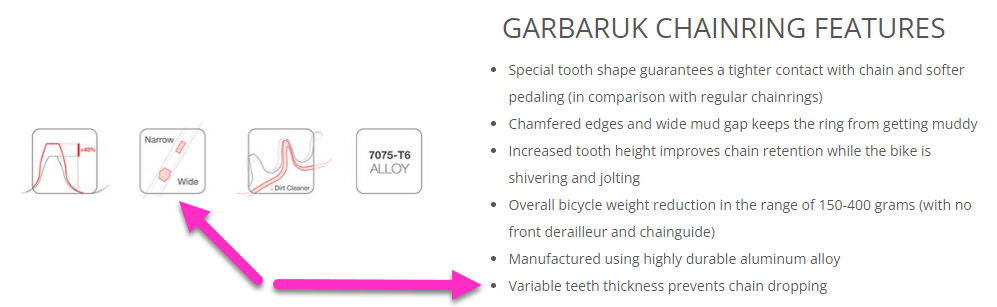

Do you think Garbaruk makes Narrow Wide 1x chainrings? I do not think so.
They show it on their website.
Are you suggesting that they ship something different than the advertised and pictured narrow-wide tooth pattern?

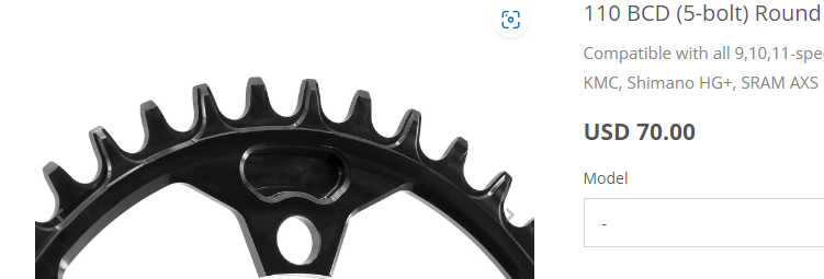

Could you check it for the

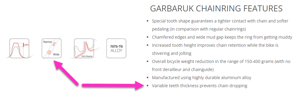

No, they make what they advertise. When I was installing my two latest Garbaruk chainrings, I even did not pay attention how I was placing the chains on those two chainrings, as a person must be totally inexperienced to place the chain the wrong way...
On a proper narrow-wide chainring such as the Garbaruk and Wolftooth, you don't need to pay attention since the chain won't really fit the wrong way - the narrow chain gaps won't go onto the wide teeth.
