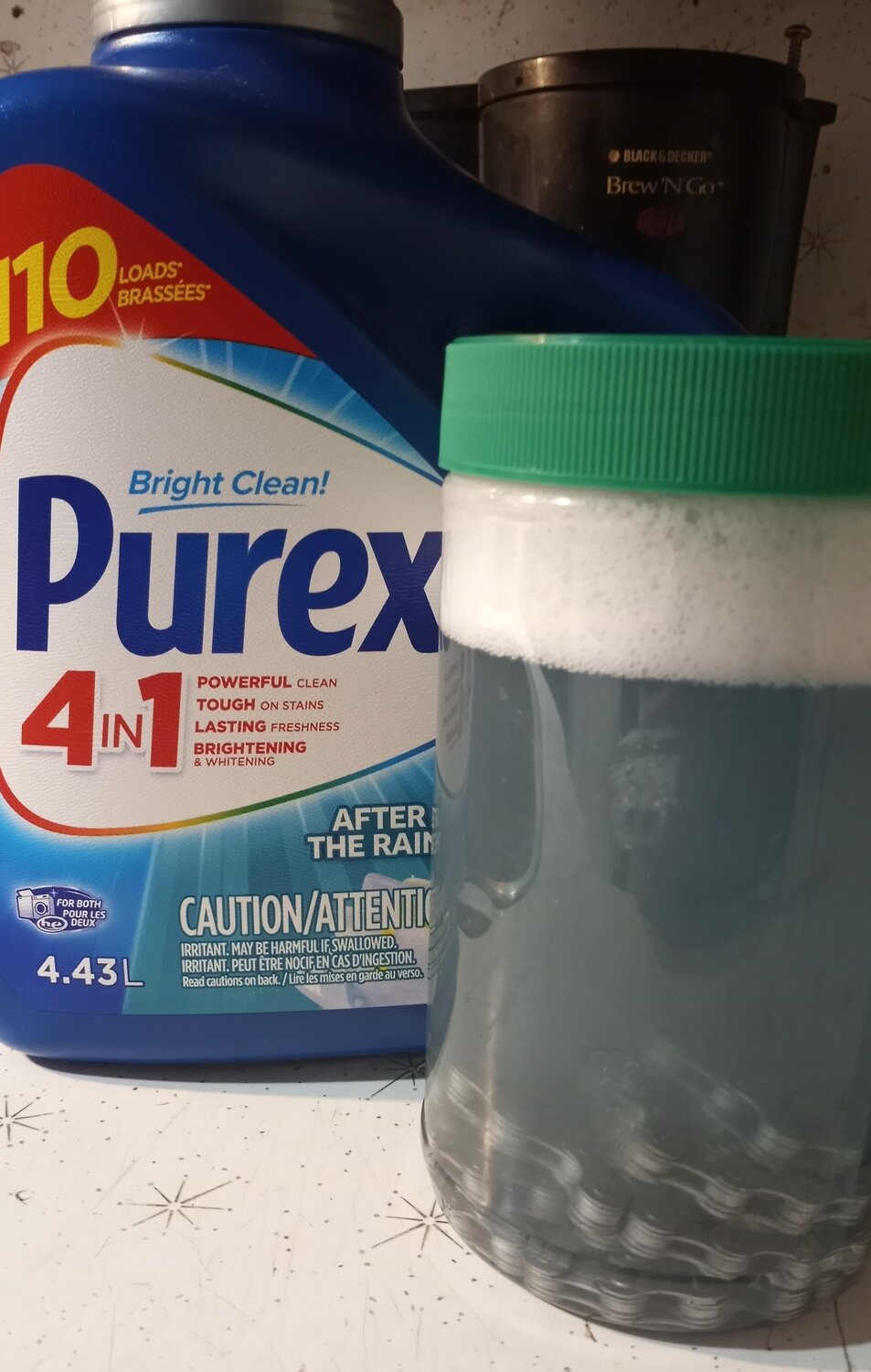

I'm gonna try that for my third cleaning,..
The plastic peanut butter jars are great.
The lids seal.
This is my old jar lid. The vacuum caved in the lid instead of leaking.

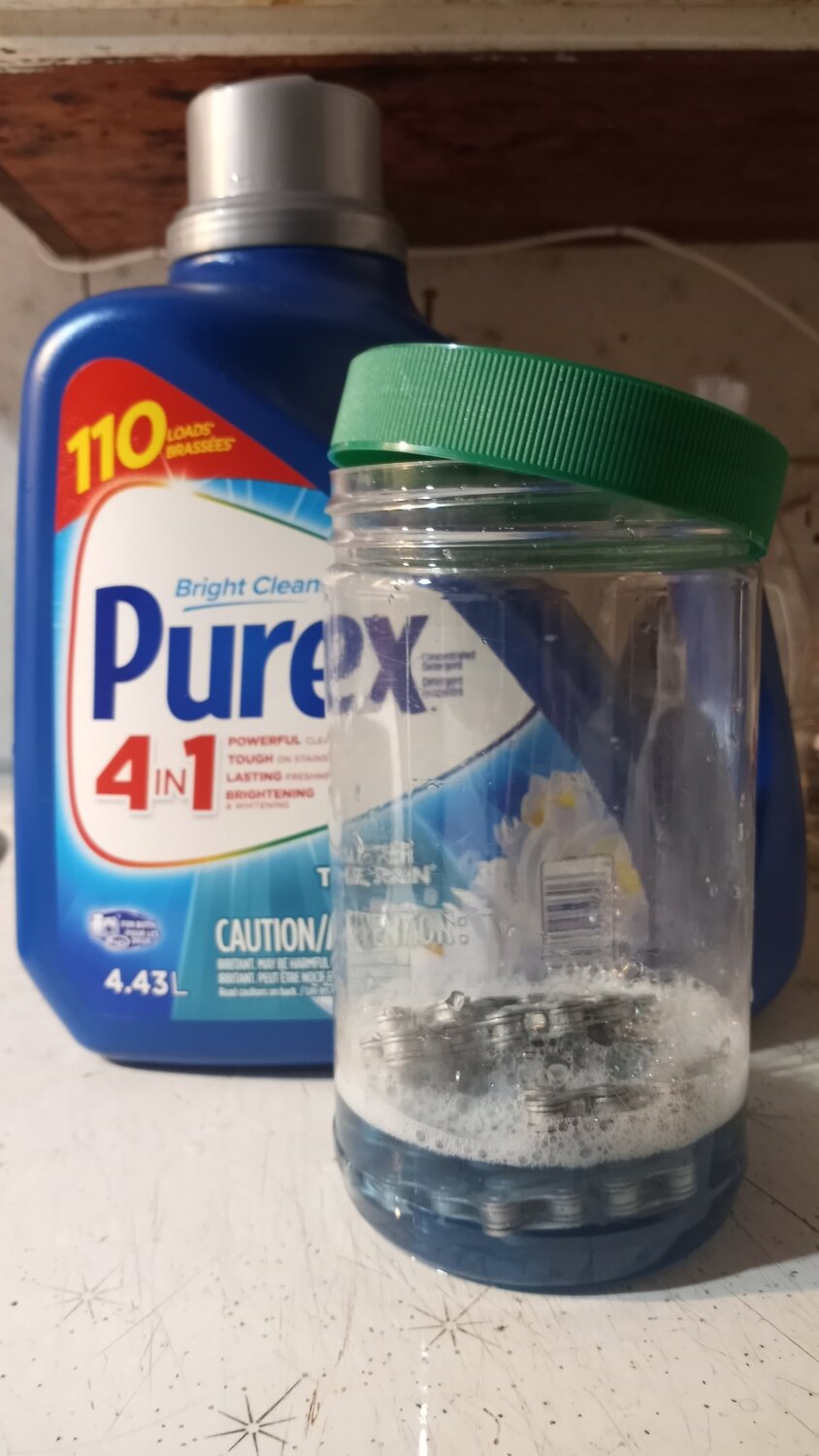

I use an old peanut butter jar with laundry soap and water to strip the packing gunk off a new chain. It is amazing how much black crud comes off. Stuff such as Simple Green works too. Then I like to soak it in another jar of nano wax. The dry lube does not attract grit. With a quick link, removing a chain for this purpose is easy. Reinstall it off the chainring so you have slack.

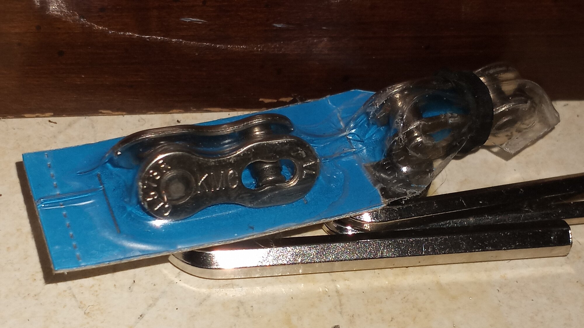

Which brings up another question: Can you reuse a master link? I bought some extras from SRAM just in case. The packaging says quite clearly not to reuse them.
I'm on to the next stage of chain cleaning,..
Yes, you can reuse a quick link (master link) in most cases for six, seven, eight, and nine speed chains. Some exotics can be different. I just cleaned my chain and am ready to ride. I am going to a place on the water that serves a quarter of an extra-large NY style pizza with a drink for $7. They call it a New York slice. Then I will hit some gravel trails.

almost everyone I know, including myself and people with mid drives and really strong riders, re-use them a few times. if it doesn’t make a nice solid click when it snaps shut, replace.

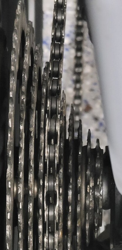

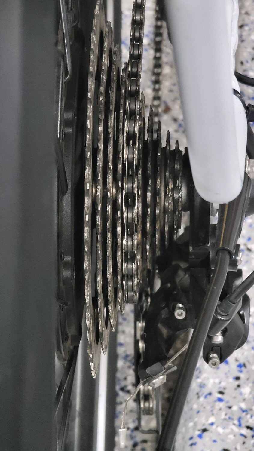

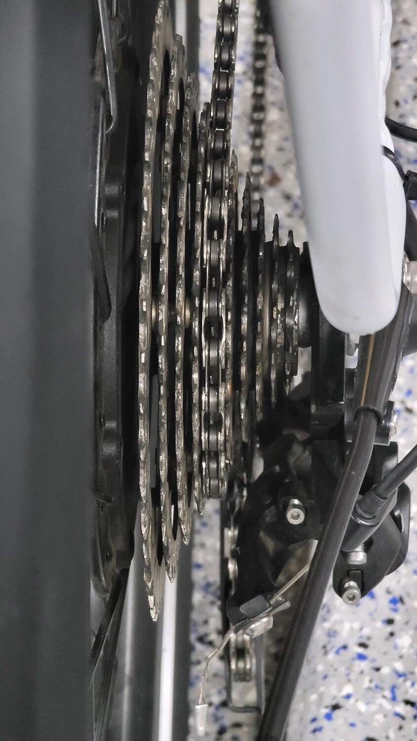

Well, now that I have chain length sorted — thanks to EBR members — on to the right chain width for my 10-speed Deore cassette and derailleur.
I ask because my 10-speed Deore cassette and derailleur shifted perfectly with the previous SRAM EX1 chain — right up to the day that chain popped a side plate (see post #1). But with the new EX1, I'm getting sloppy upshifts and downshifts — including jumps of 2 gears at a time.
This occurs exclusively in the middle gears — which makes me think that more than a derailleur adjustment is needed. First and 10th aren't affected.

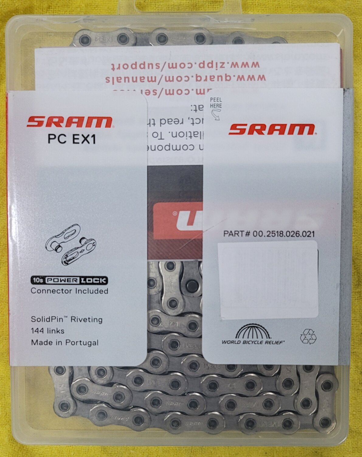

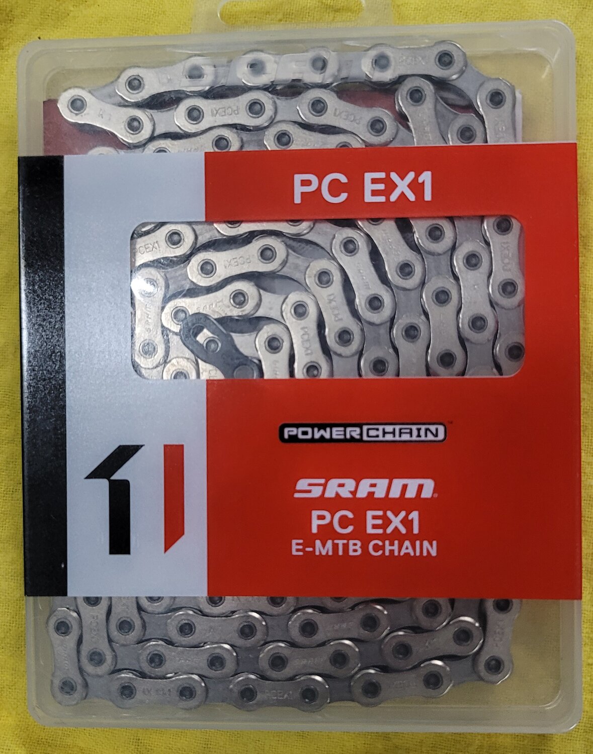

Did I buy the wrong EX1 chain? New chain photos below...
Note that the SRAM packaging (2nd and 3rd photos) clearly says "10s" on the back (3rd photo), but the sticker (4th photo) says both 10- and 8-speed.
This is my guess, based purely on speculation,..
I think you've got a fatter chain if it will fit an 8-speed.
When you're in the middle gears, the chain line is straighter towards the chain ring, so the extra gap in the chain can catch an adjacent sprocket.
First and 10th pull the chain sideways, so it stays on the sprocket.
You also have an E-MTB chain that is made in Portugal.
Perhaps the chain only works properly in the mountains of Portugal? Sort of a proprietary thing maybe? 😂
It needs to be a designated ten-speed chain. Something like the KMC X10. Yes, I agree with @PCeBiker that the chain is too wide. The straight down photo is very good. It shows that the vertical is not aligned but off to the right. Get it aligned straight up and down in a middle gear. That means the cable needs to have no slack in the highest gear. Reset the cable tension in 10. Do that with two turns of the barrel adjuster out. And dial it in from there by sound, no clanking in a middle gear.
,..Get it aligned straight up and down in a middle gear. That means the cable needs to have no slack in the highest gear.
I don't agree with that.
The derailleur feeds the chain on to the sprocket at the bottom.
By the time the chain is at the top of the sprocket, it's the chain ring pulling on the chain that pulls it to one side or the other.
,.. It shows that the vertical is not aligned but off to the right.
It's not just the alignment.
The chain looks as if it's tipping over sideways.
I think an 8-speed chain might have bigger rollers, and an 8-speed freewheel/cassette probably has deeper tooth pockets?
I think a proper 10-speed chain should fit snuggly.

It is my understanding that 8 speed and 10 speed chains are different widths. That makes the sticker on the chain that specifies both to be confusing. If you have some calipers I would measure your old and new chain widths and compare with the information linked below.
https://bike.bikegremlin.com/1220/1-bicycle-chains-compatibility/#3
Confusing indeed. The new and old chain widths looked the same when I compared them by eye. But I'll try the measurements and report back.

But the original, unopened SRAM packaging said "10s". The sticker added later said both 10- and 8-speed.
The old and new side plates are stamped "D2" and "K1", respectively. No clear indications of intended cassettes, and no online indication of what these codes might mean.
