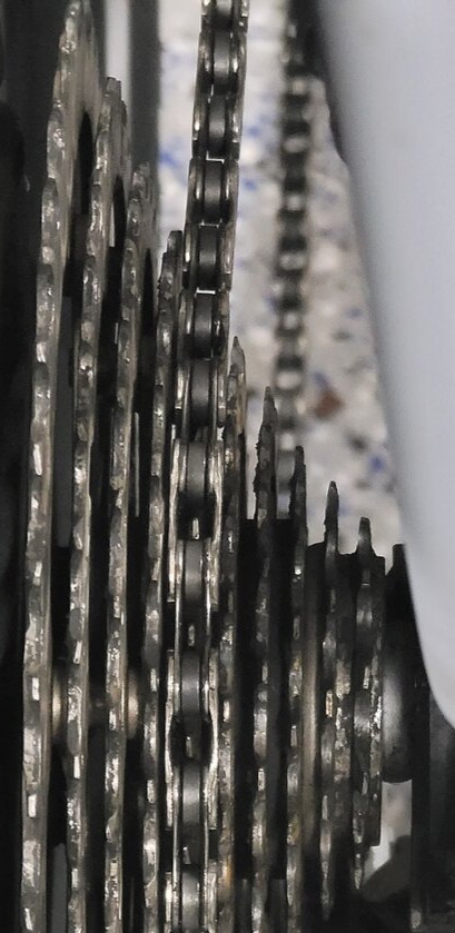

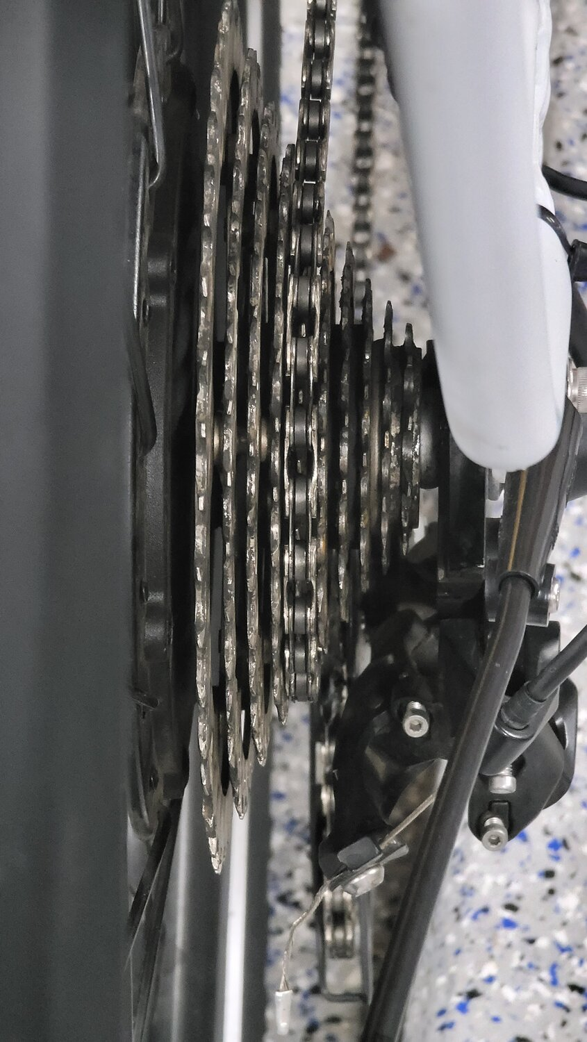

It needs to be a designated ten-speed chain. Something like the KMC X10. Yes, I agree with @PCeBiker that the chain is too wide. The straight down photo is very good. It shows that the vertical is not aligned but off to the right. Get it aligned straight up and down in a middle gear. That means the cable needs to have no slack in the highest gear. Reset the cable tension in 10. Do that with two turns of the barrel adjuster out. And dial it in from there by sound, no clanking in a middle gear.
Thanks, I also think the chain is too wide, the packaging notwithstanding.
Should I get a Deore 10-speed chain to match the derailleur and cassette? Other chains to consider? Remember, this is for a hub-drive with a delinquent owner in a very salty and sandy environment.

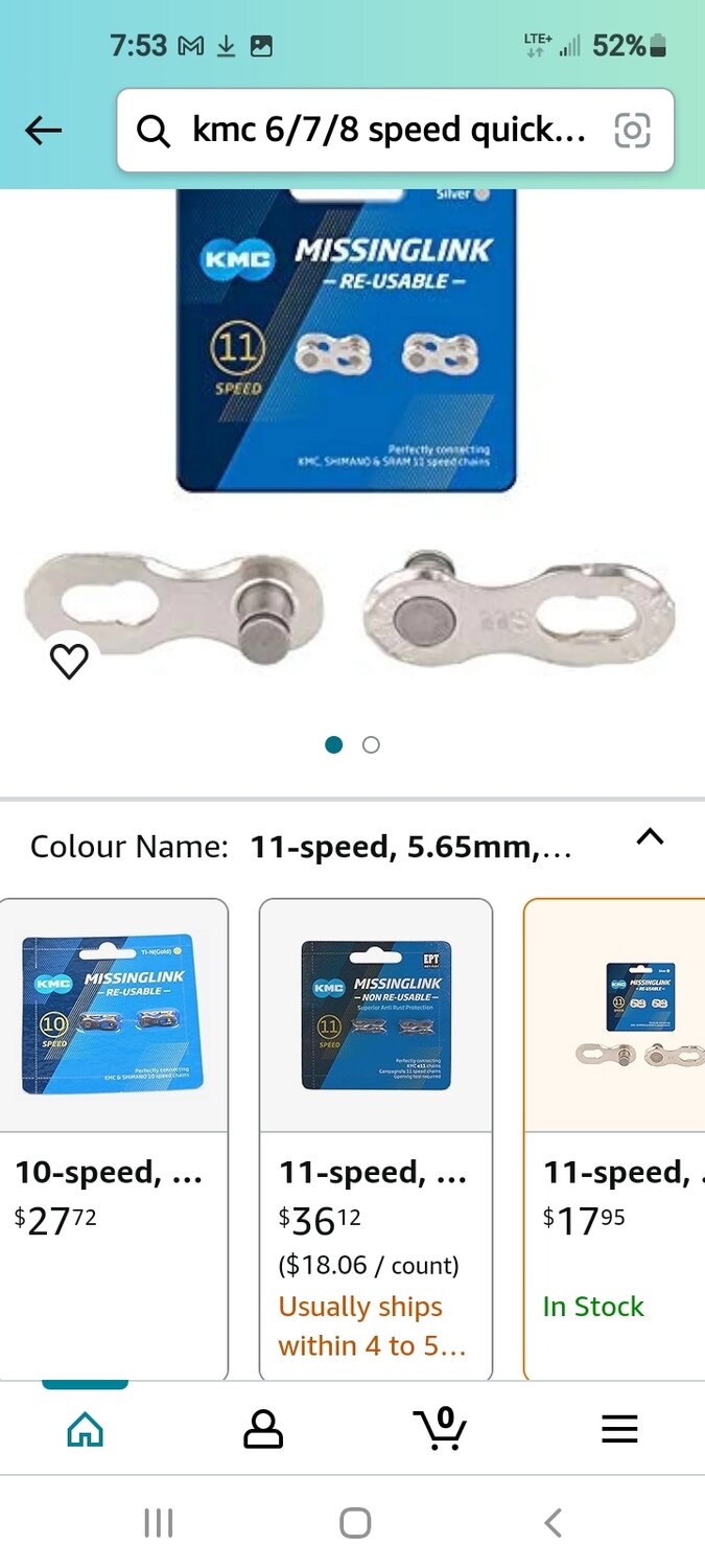

It's not the number of links we're talking about.
It's the thickness of the links.
5.2 mm
5.6 mm
5.65 mm
5.88 mm
6.6 mm
@Rome can you use your micrometer and measure the thickness of your chain?

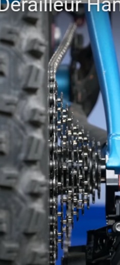

The chain in the video shows the chain coming off the sprocket squarely.
It's not leaning over. It just goes to the right.
I believe this is even when the derailleur hanger was bent.
Jeremy's cluster,..
And this is on a middle sprocket.

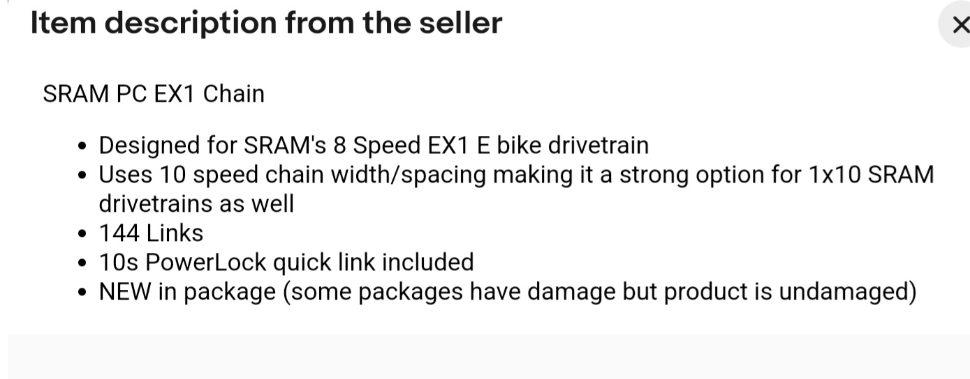

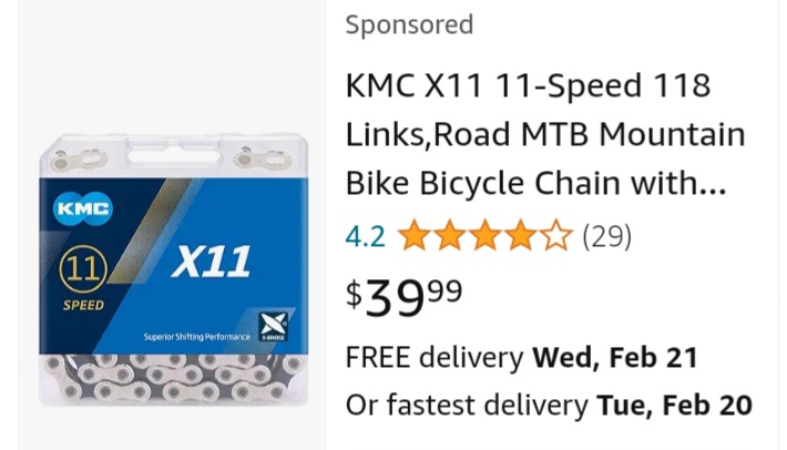

See this eBay sale:
eBay sale
"SRAM PC EX1 10 Speed or Electric Bike 8 speed Chain 144 Links with PowerLock"
This title seems to suggest that there is a difference if the bike is an EBike. Can this be or is this poorly worded?

I'm thinking that your chain isn't fully seated in the cassette teeth?
Can you take a picture of your chain with this angle?
Along the chain, to see if the chain is rolling over sideways?
As off-angle as this chain is, it's not rolling over,..
It's kicking off sideways squarely.
See this eBay sale:
eBay sale
Something doesn't sound right to me,..
Does he offer a guarantee?
I'll bet that chain would work fine on my 8-speed freewheel, but it won't work worth a crap on a 10-speed.
Using a 10-speed chain on an 8-speed, isn't the same as using an 8-speed chain on a 10-speed.
