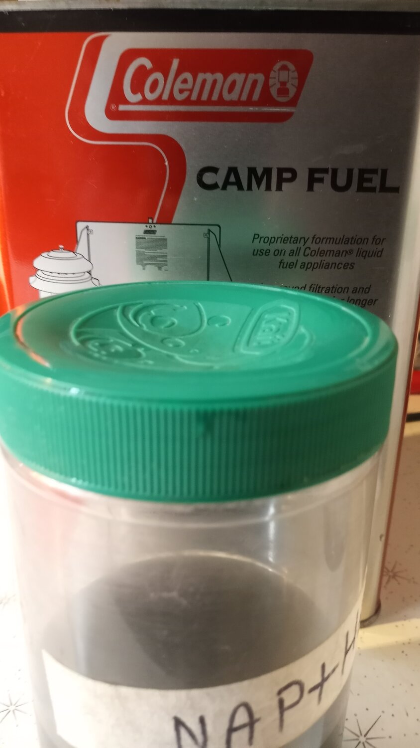

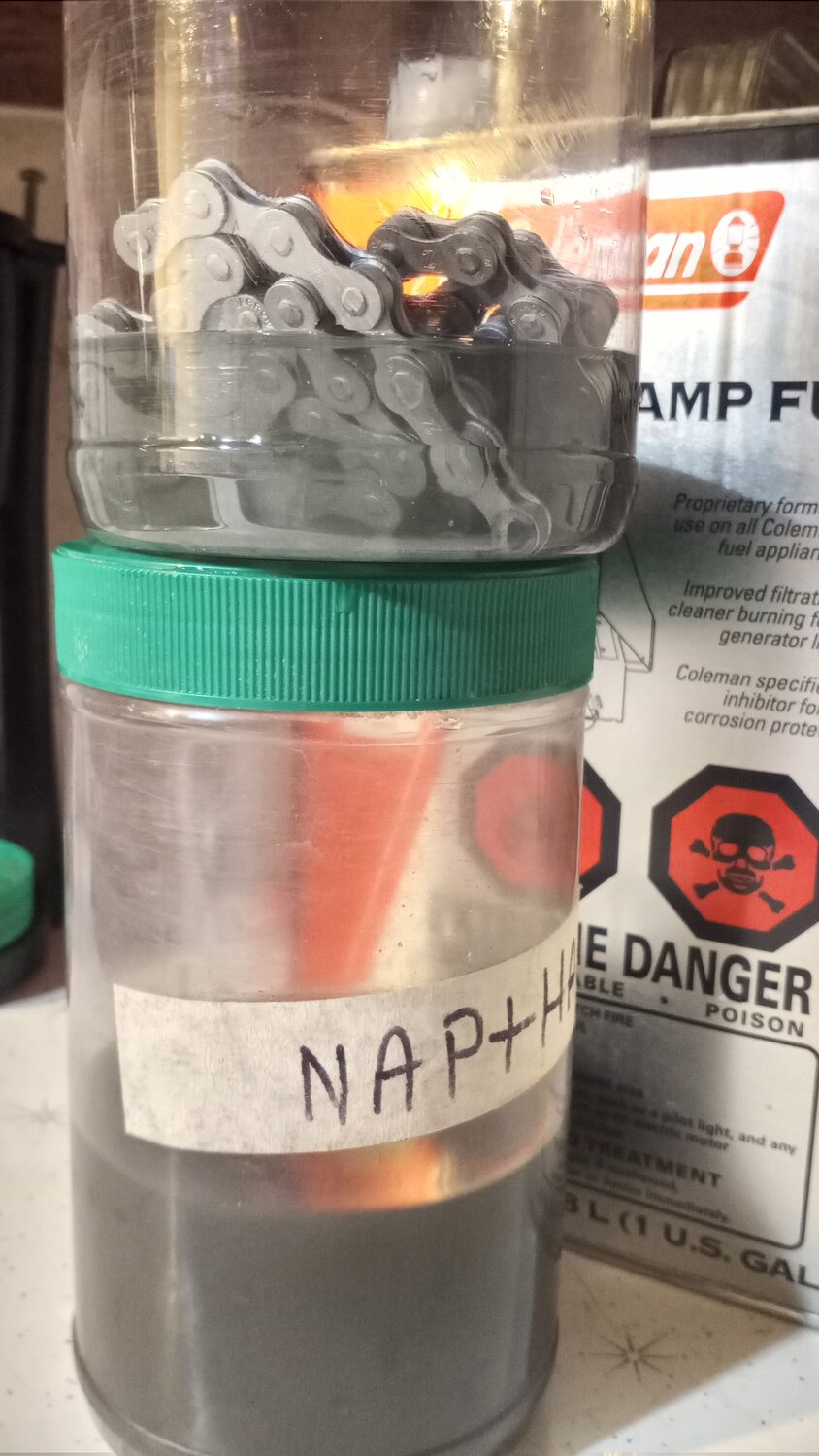

I use an old peanut butter jar with laundry soap and water to strip the packing gunk off a new chain. It is amazing how much black crud comes off. Stuff such as Simple Green works too. Then I like to soak it in another jar of nano wax. The dry lube does not attract grit. With a quick link, removing a chain for this purpose is easy. Reinstall it off the chainring so you have slack.
@Jeremy McCreary,
I'm gonna try that for my third cleaning,..
The plastic peanut butter jars are great.
The lids seal.
This is my old jar lid. The vacuum caved in the lid instead of leaking.
