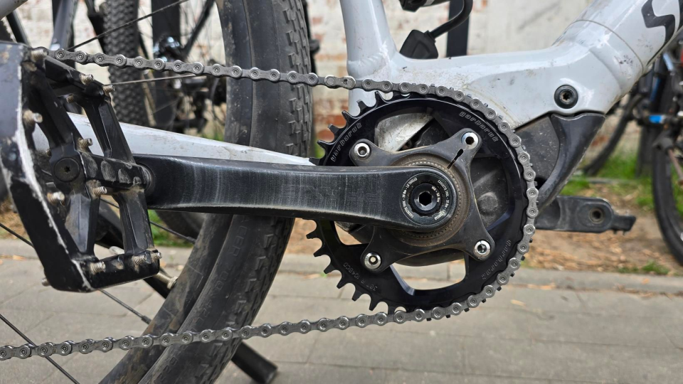

My Vado SL 4.0 Gen 1 came with a 10-speed Shimano Deore drivetrain. As there were big jumps between some gears, and I also needed a wide range cassette, I replaced the drivetrain with a 11-speed Shimano M5100 drivetrain with a 11-51T cassette, a new long cage derailleur, and an appropriate shifter. A new high quality shifter cable had completed the upgrade. Combined with a 42T Garbaruk chainring, the upgrade met my expectations. Why M5100? It was because the drivetrain was relatively inexpensive and had a wide gearing range.

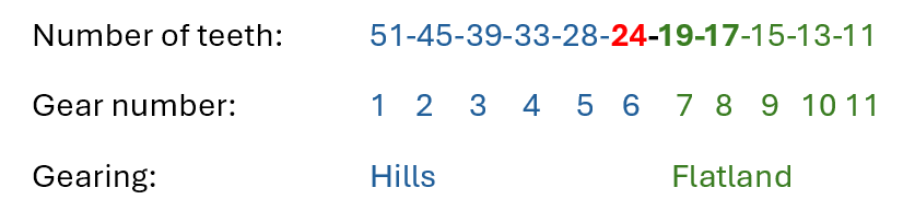

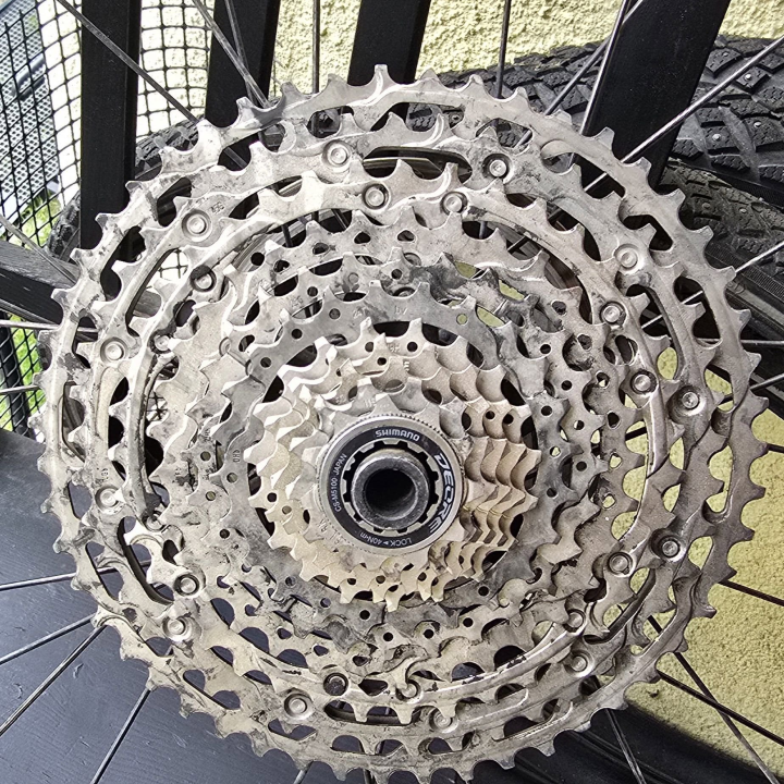

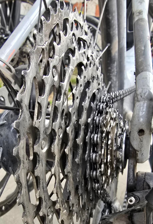

Having available spare compatible sprockets, I built this cassette:
Yes, now there is a big jump between the Flatland and Mountain gearing range!

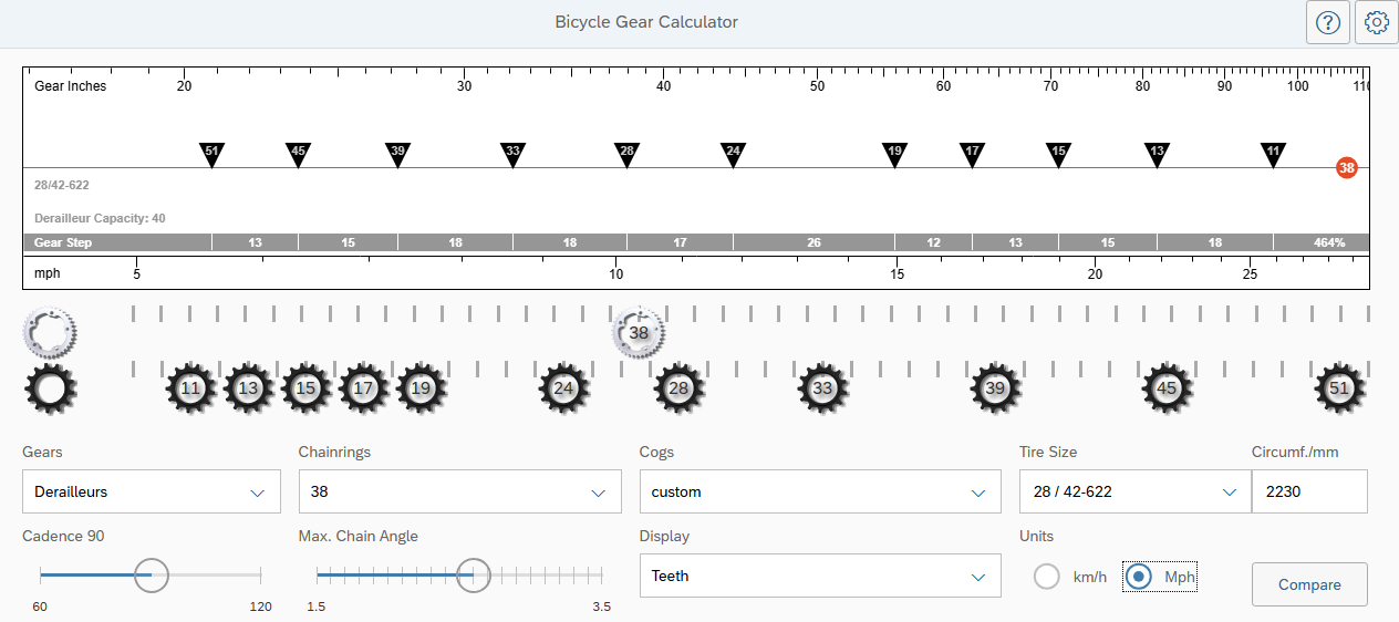

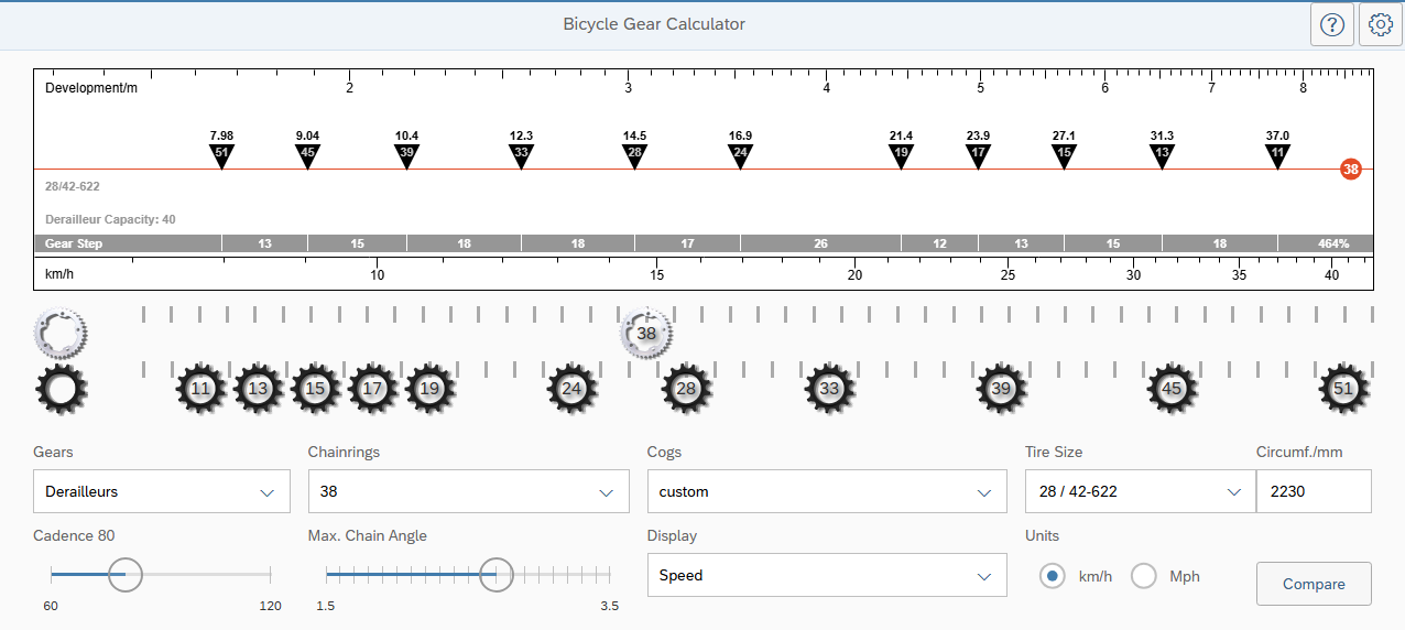

Now, I consider swapping the chainring for a 38T. It would give me five equally spaced high gears for a constant cadence...
