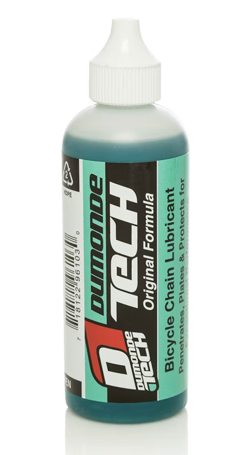

I did order 3 bottles of Rock N Roll Gold and ordered one bottle of T9. I will see over time what I eventually prefer.
The one bottle was Dumonde Tech Classic Original and not T9

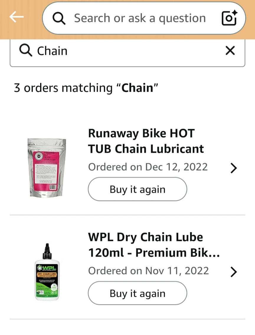

I bought some dry lube when I first bought my e-bike, then bought the hot wax a month later.

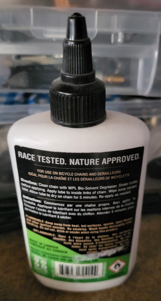

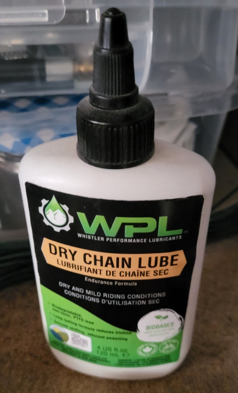

I've never used the dry lube, but I like how the plants and animals give it their approval. 😁

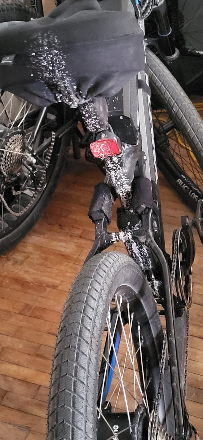

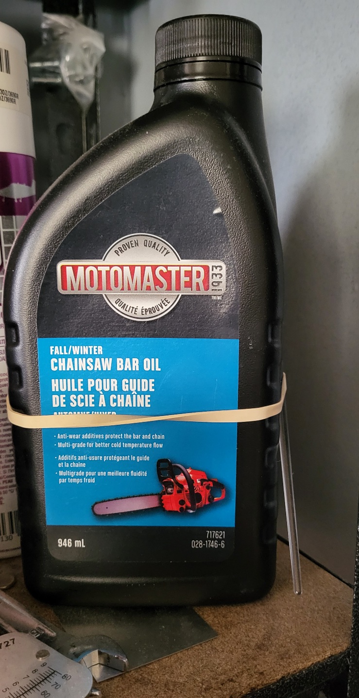

I just cleaned and waxed my chain.
I've got the perfect wet lube for Winter,..
I think that the evidence will speak first itself.
Results similar to this, I suspect?? 😁
