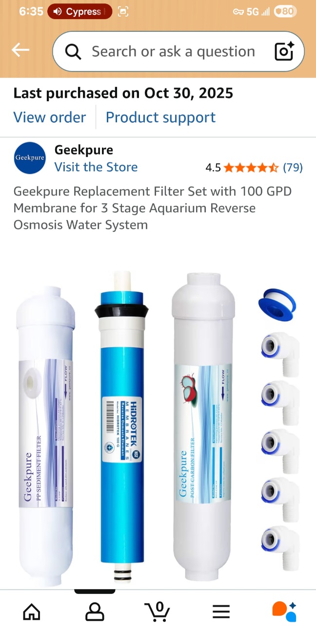

I just bought a new membrane !!
My old one was starting to leak !!
I think it got holy ??
It went from 12 ppm new to over 40 ppm now. 😁

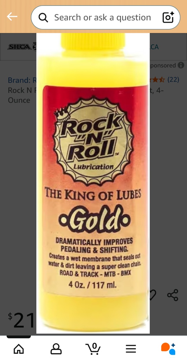

I thought you ordered the Rock N Roll Gold? (maybe you ordered that too??)
It says on the label "creates a wet membrane" and I want dry so I went with the T-9.
It's just parrafin wax and a "delivery agent" that evaporates leaving just the wax behind.
It might dissolve some of my hot wax away, but it should replace it with fresh wax.
(that's all complete speculation on my part. I tend to make stuff up. 😁)
I did order 3 bottles of Rock N Roll Gold and ordered one bottle of T9. I will see over time what I eventually prefer.
