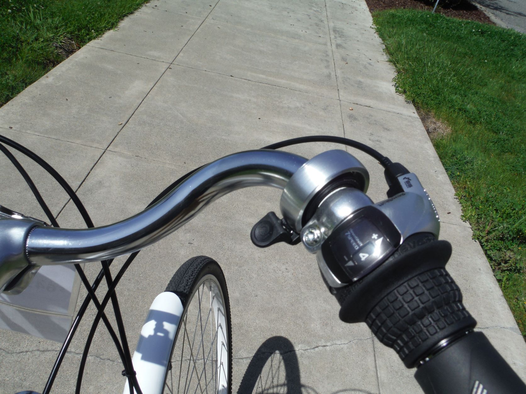

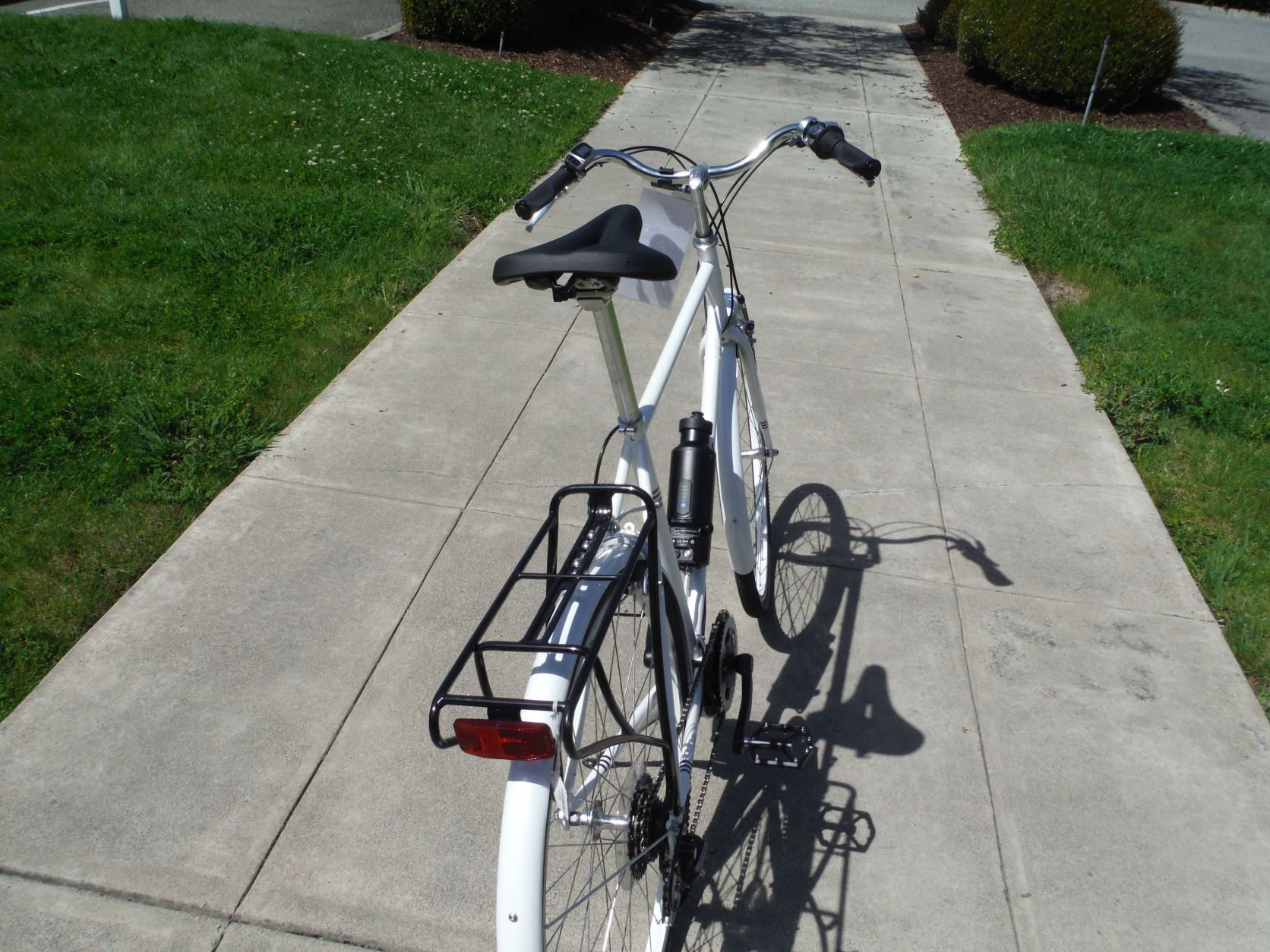

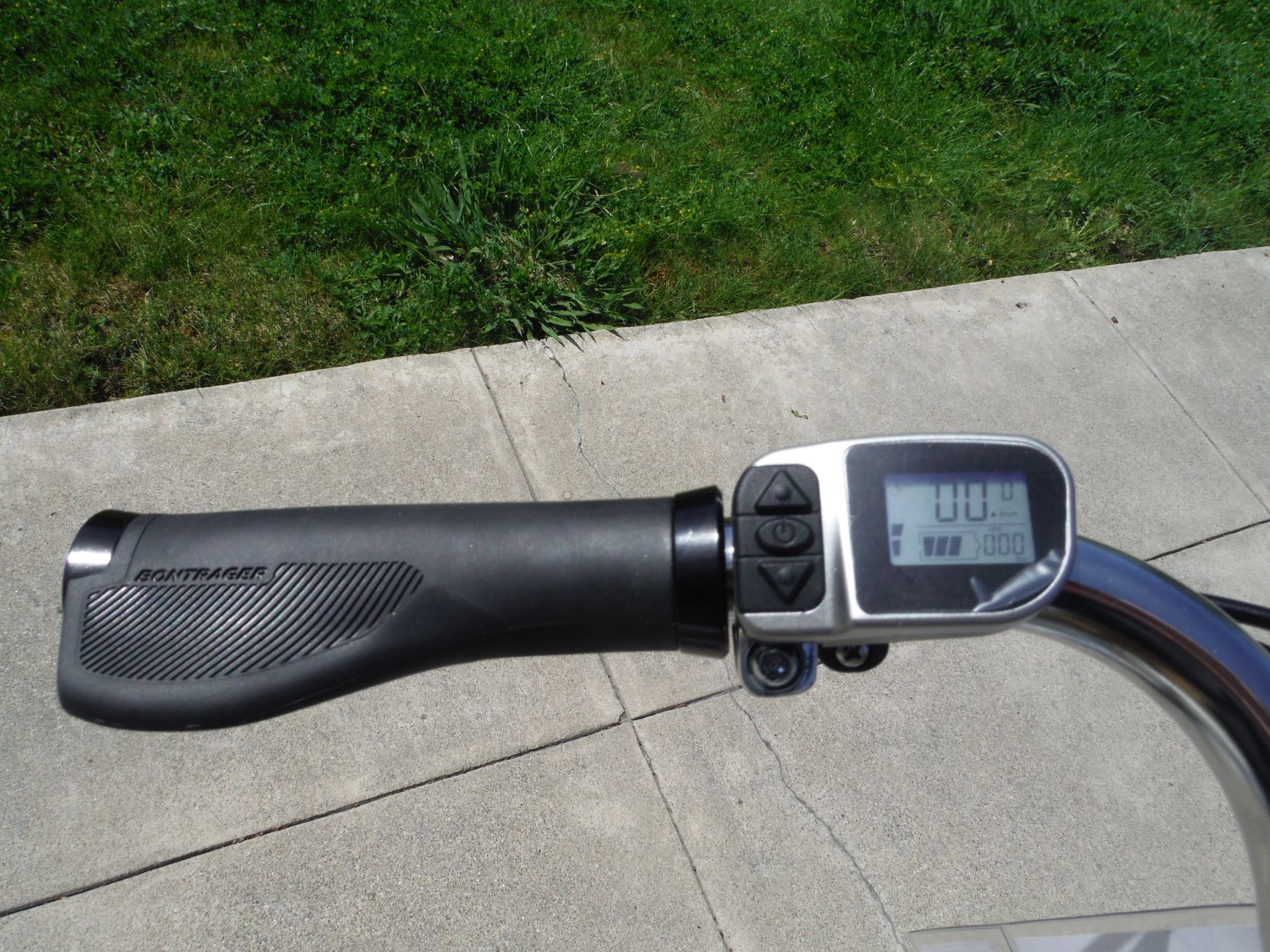

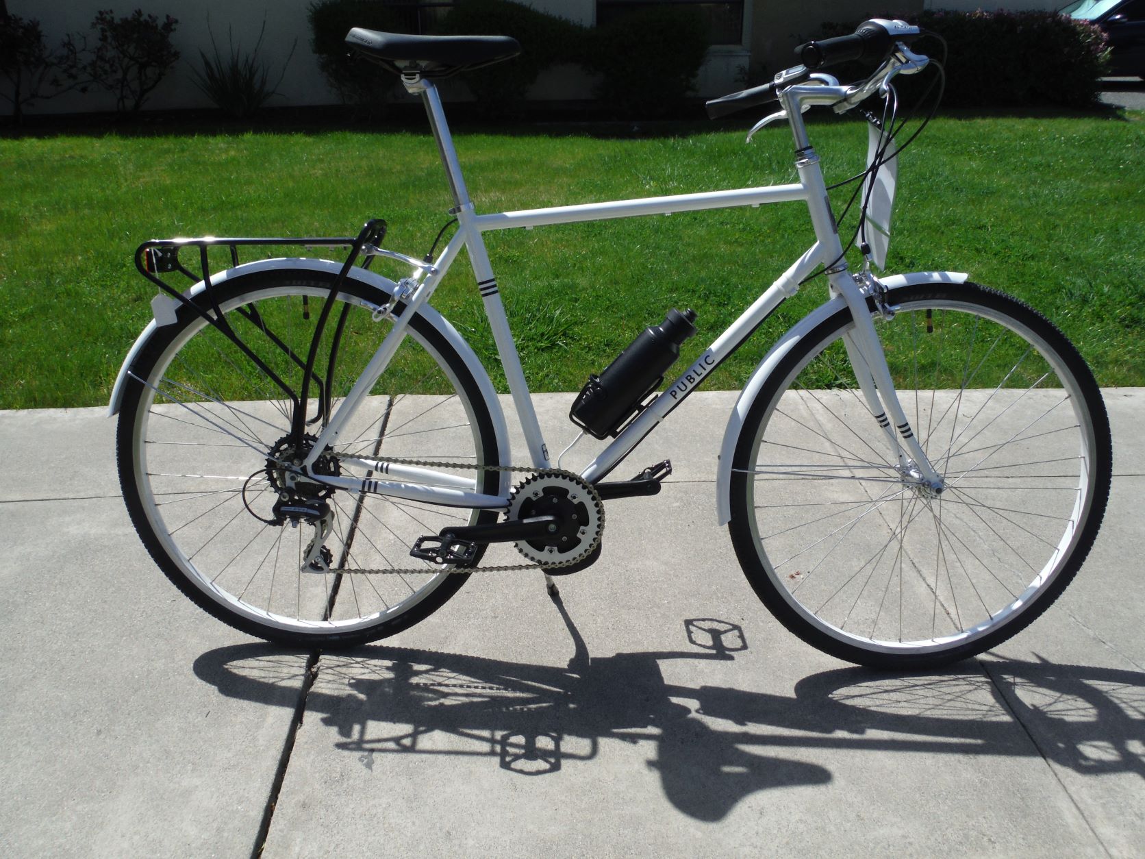

I have been riding a very basic bike a lot since February when it got a new chain, freewheel, and gravel tires. Today at .5 it got a new hot waxed chain, freewheel, and a tire rotation. I also went from a revoshift to a Microshift push/push with fresh DOT 5 down the housing. I also had the derailleur in the tank and it got a cleaning and lube. I used the DhAG. Then I trued the wheels and the tires. I know, truing tires, really? It is easy to check. Just take a pastel crayon and spin the wheel. Brace the crayon while barely touching it to left, right, and tread. Sometimes the bead is a little off. Now it rides great. I love that MucOff C3. I still have four little UV lights on a shelf. I got the starter bike on Super Sale new for $450 in 2020 and enhanced it a lot. It is comfortable around town and cheap to maintain. For example the new 11-34 nickel plated freewheel was $22 plus tax. Batteries are easy to swap for whatever the size of the ride.
