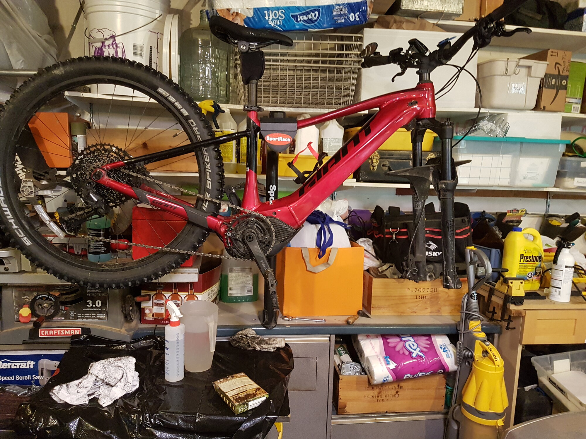

I've been woefully poor on chain and drivetrain maintenance, so today I took my time and did as good a job as I could.
It's winter here, and hovering around 0C, so I decided to do some work inside and some work outside in my unheated garage.
An extra complication is I am running Schwalbe Ice Spiker tires for the winter, so just wheeling the bike indoors is not going to happen.
First up - bike up onto repair stand, which in my case is a cheap truck bumper Sportrack 4 bike carrier. It's bolted down to some very heavy storage cabinet/work surface.
Yeah - just a bit of clutter, but that's what garages are for.

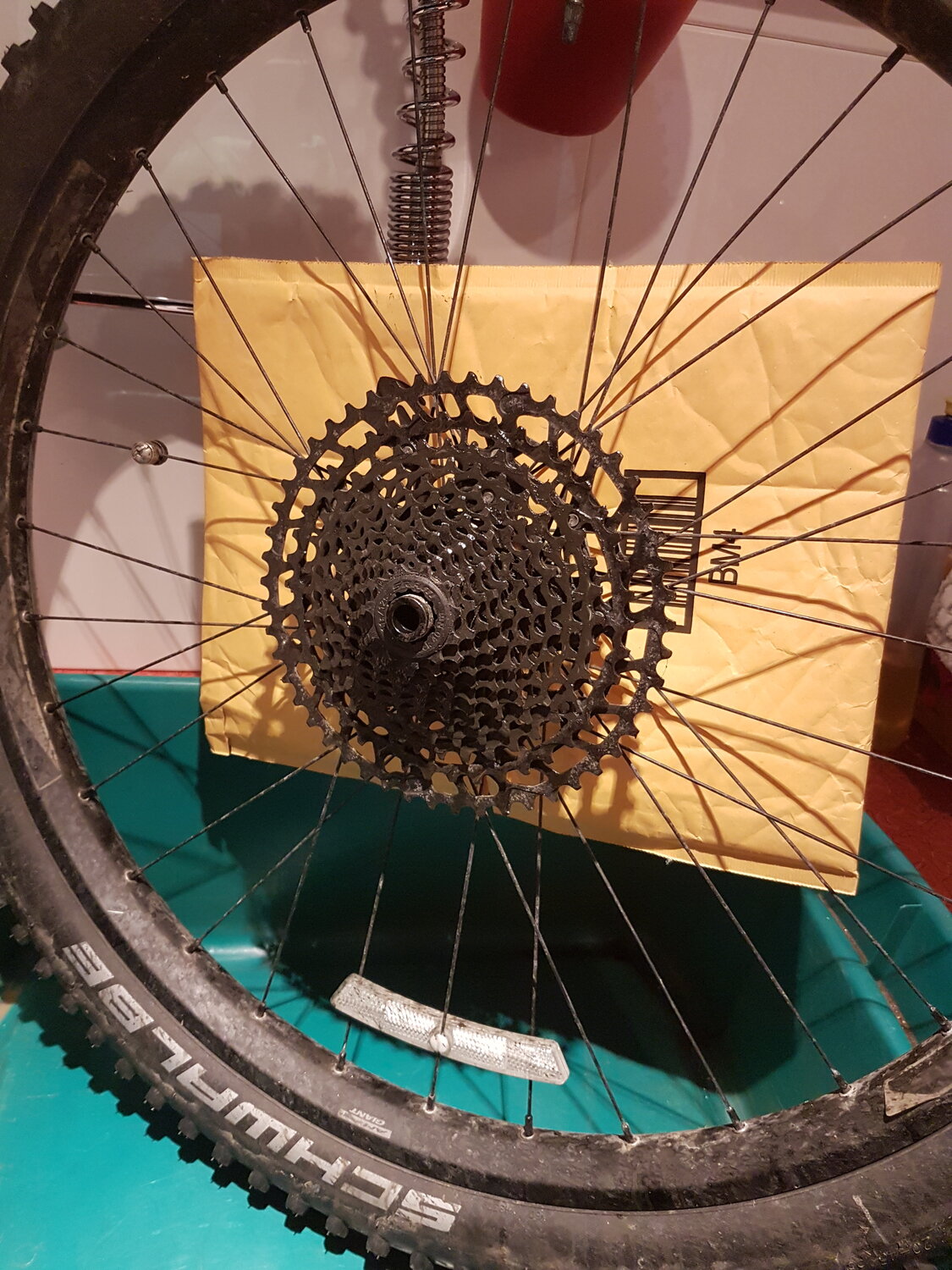

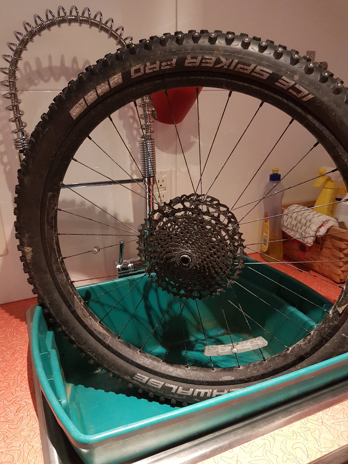

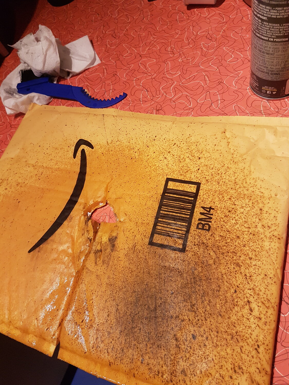

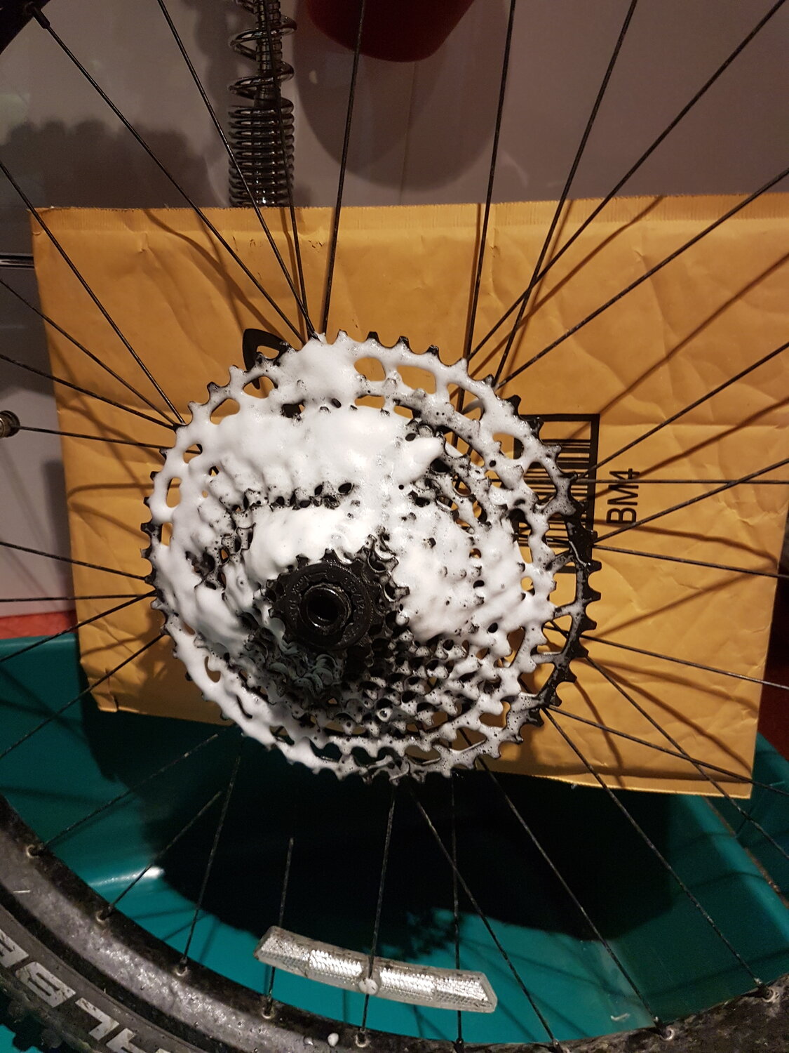

As I mentioned, I worked inside as well - I cleaned the cassette downstairs in my utility room. I placed the rear tire in a plastic bin that fit in my sink - once again this is a studded tire.

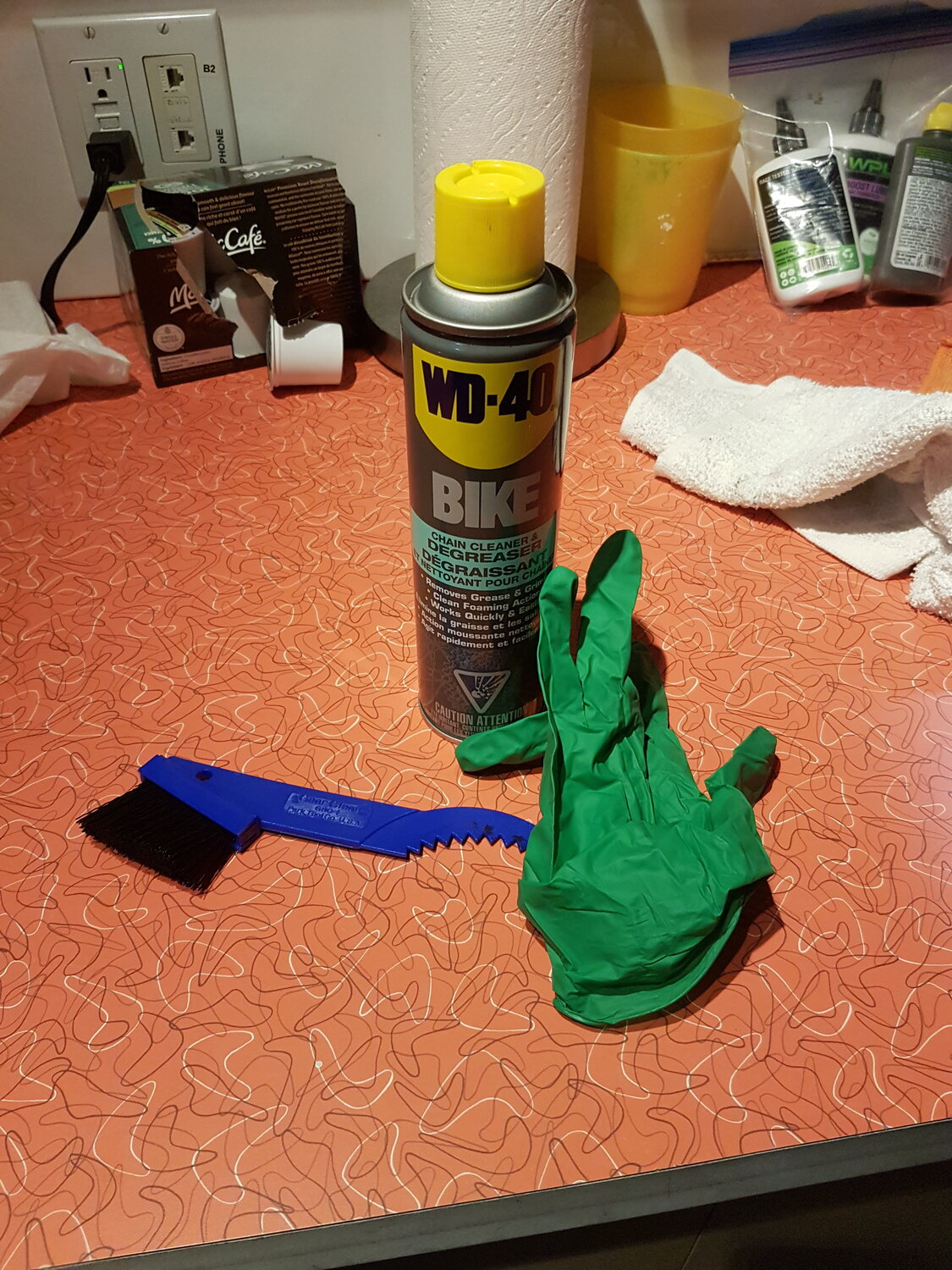

Thumbnail pics left to right;
  • tire in bin
  • tools
  • makeshift splatter guard shielding rotor. faucet and wall
  • degreaser applied
  • splatter guard after the job was done.
20210223_133850.jpg 20210223_133902.jpg 20210223_134204.jpg 20210223_134252.jpg 20210223_134851.jpg
I degreased twice as it was pretty bad!

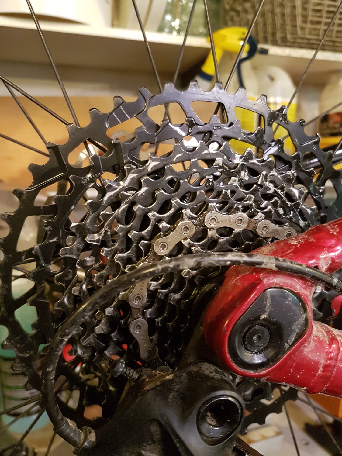

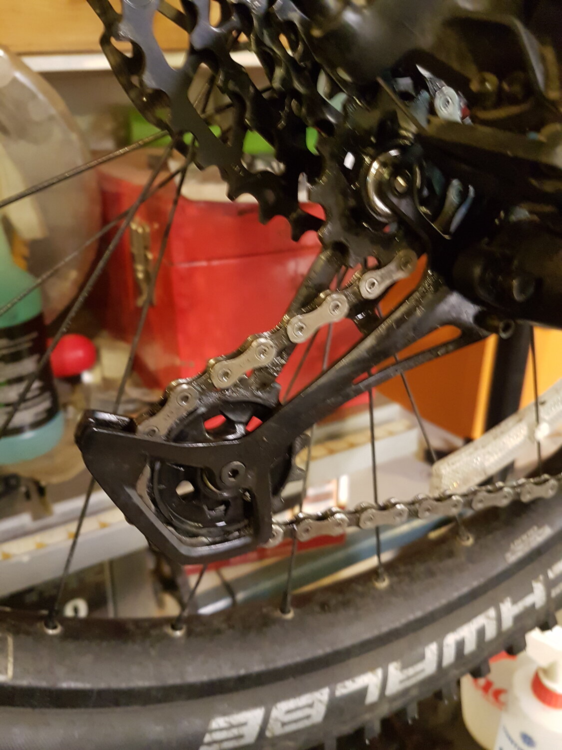

Using the same degreaser I cleaned up the jockey wheels with an implement called a shave hook and then degreased the chain and crank before putting the back wheel back on.

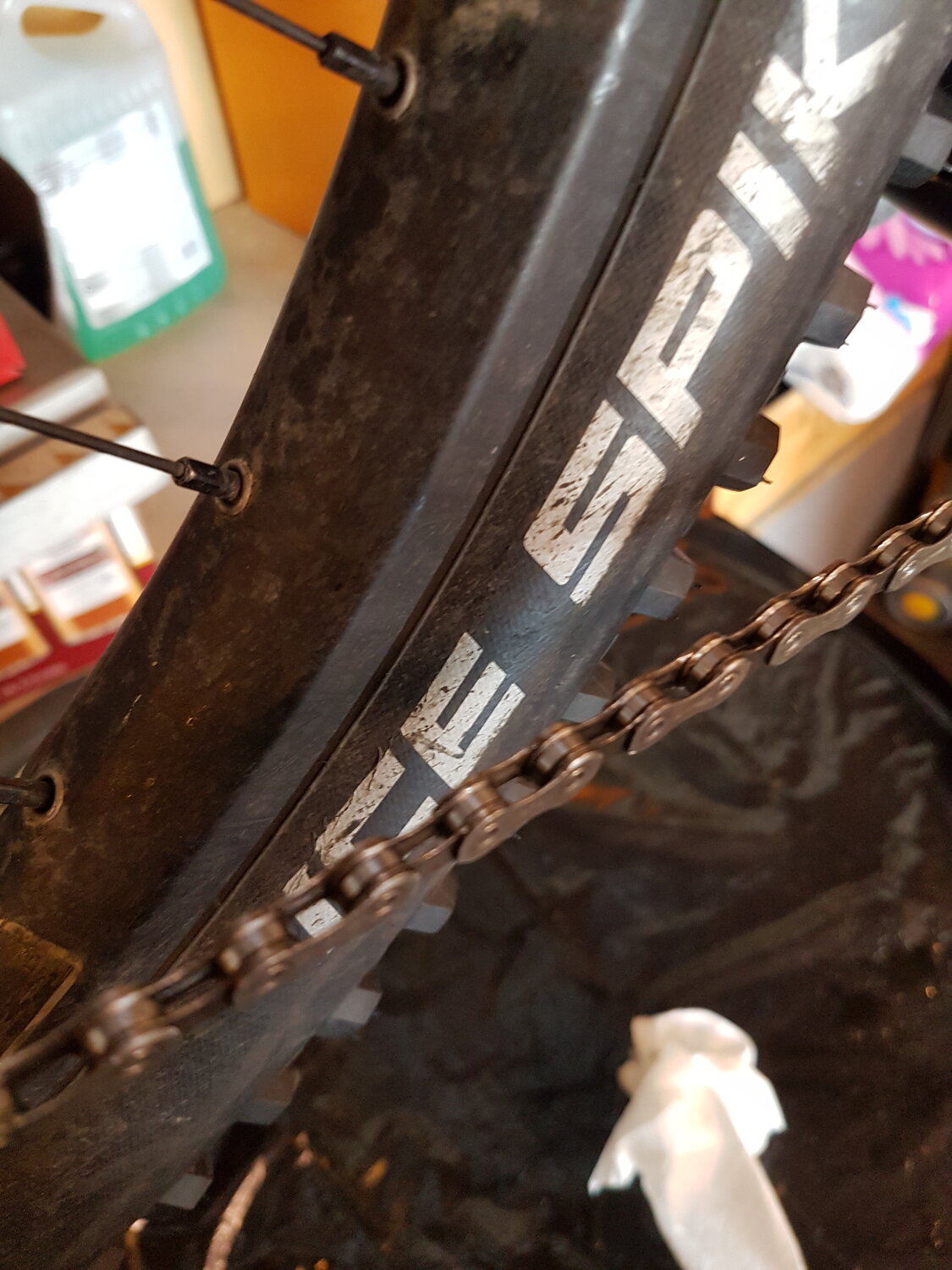

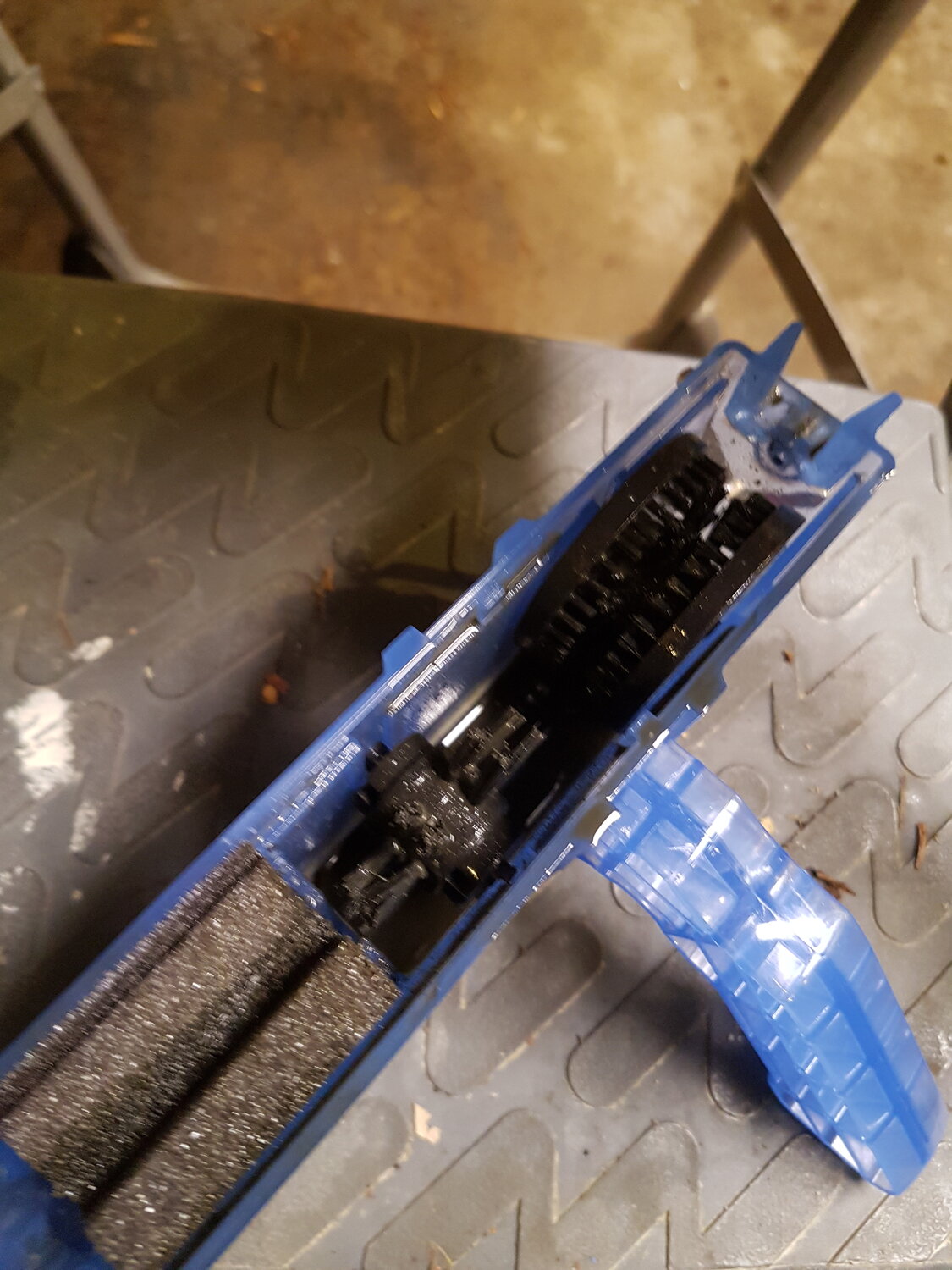

Then out came the Park Tool CM5.3 Cyclone chain cleaner - it took 3 passes to get the rest of the stuff off the chain.
I think I'll invest in a dummy hub for next time, as I was reticent to put the "not quite clean yet" chain back on the just cleaned cassette.

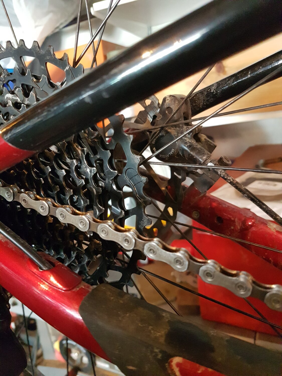

Cleaned everything up and gave it a good dry before re-lubing the chain with WPL "Wet" formula .
  • tire in bin
  • tools
  • degreaser applied
View attachment 79893 View attachment 79894 View attachment 79895 View attachment 79896 View attachment 79897

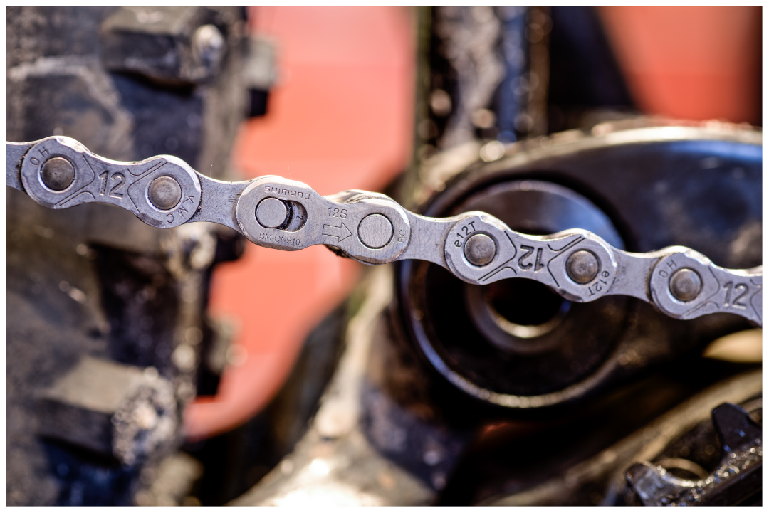

Let me go off-topic a little bit because I feel I must express my frustration. I should not be allowed to touch any bike on the mechanical side. "A peasant should get some turd instead of a watch" - it is how we describe such people as me in Poland :D
I thought I installed a 12-speed KMC chain properly. Almost. I didn't notice I placed the Missing Link in the wrong orientation... "The peasant" broke his new chain after a half-mile ride! Repairing the chain with a spare Quick-Link. And what if I hadn't the spare master link at hand?!
I feel miserable.
I feel miserable.
I hope it is properly done now (the upper part of the chain visible here).
Some lessons learned, are lessons learned forever...
I hope to never squeeze a brake lever while the wheel is out, ever again - we'll see.
Chin up - open wide - insert beer...
IDK if it will make you feel any better, but in the USA we have an expression..."the handyman's curse" ... that I have experienced with remodeling houses.
Something needs repaired, I would figure it out and attempt to fix it, screw it up badly, figure it out again, and fix it correctly. Then once I finally knew how to do it the correct way, I would never need to make a repair like that again.Rinse and repeat on a half a dozen houses.
At least know you will be replacing chains again, so you will use the knowledge ( painfully) gained.
I feel miserable.
Interesting to find that the link is directional... thanks for sharing.
