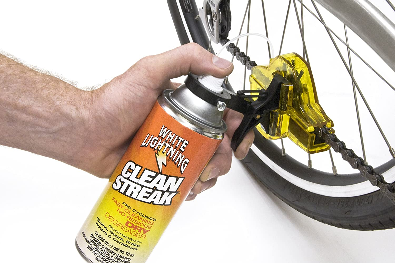

I don't understand, the spray cleaner I recommended in the first post here starts at $5, including shipping, from Amazon.
It's purpose built to cleaning bike chains, works really well and is safe for paint and plastics. Why the need/desire to go with anything else?
Another member mentioned using Brake Cleaner and I cautioned against it as it can also remove paint! ;)
Anyone tried Brake Cleaner for a car, to clean their bicycle chain? You'd need to take the chain off the bike because brake cleaner destroys paint.
It is $5 a can, aerosol, and comes with a spray tube. It will leave the chain squeaky clean and ready for your favorite lube.

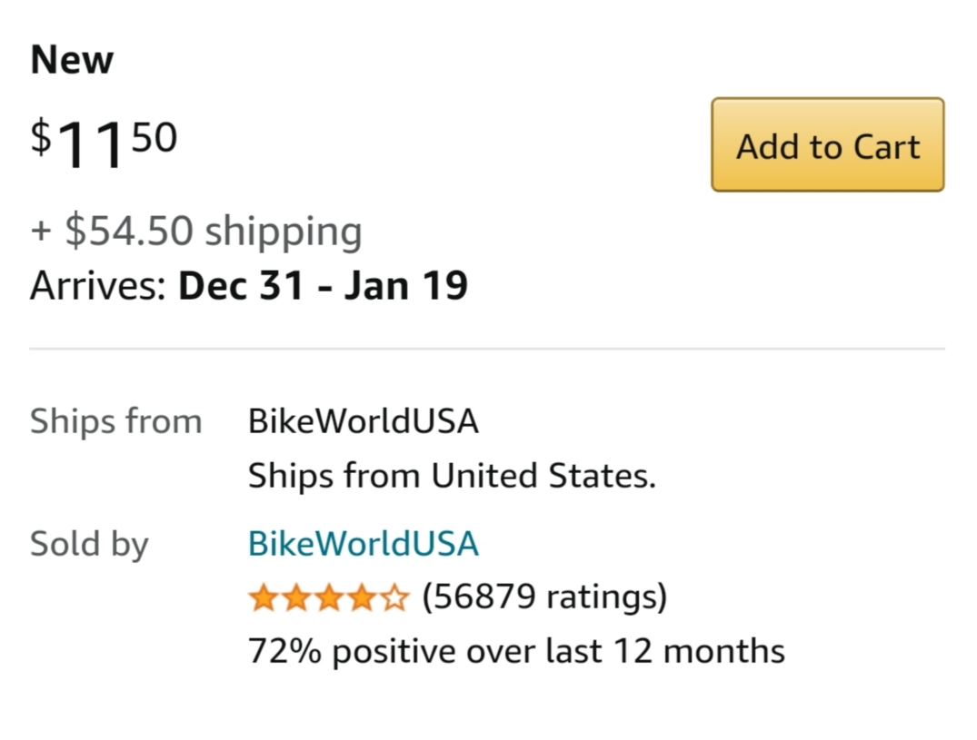

White Lightning is crazy expensive here in Australia ($50 a can, mostly in delivery costs). It just doesn't seem to be stocked much locally. Any other alternative I should look for?
I really like White Lightning Clean Streak as it evaporates and does not leave any residue. ;)
Amazon has it for $5 USD per can or you can get it with the integrated chain cleaner for $22.

Thanks. My first post in this thread was about using Clean Streak, but I didn't realize they made an attachment, which might make my original caveats about covering the area around the bike, etc. less important.
There are 16 sellers on Amazon for this. Don't know if any of them are cheaper to Australia.
All with similar shipping costs. Weirdly there's no local stockists. All our regular bike degreasers seem to sit around the $30 - $40 mark. Which isn't a lot less than I paid for my chain.
