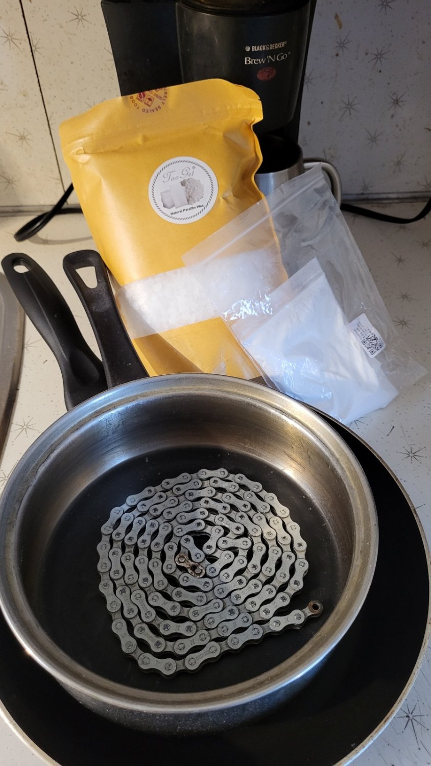

I like how candle wax made it into the top ten.
I wonder how my candle wax spiked with Teflon powder would perform?
