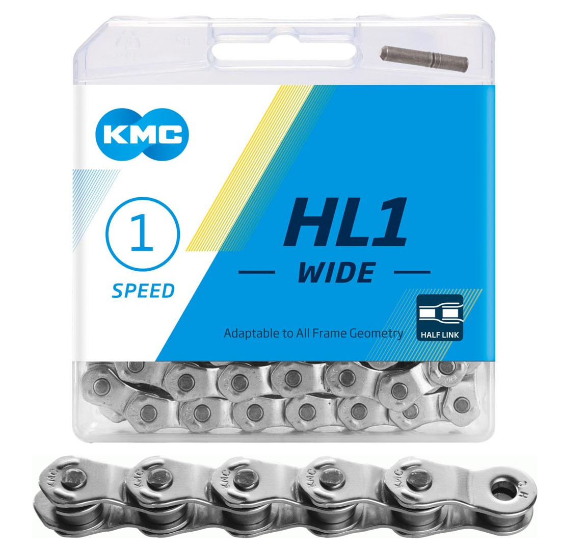

If it moves less than 1/4 inch it is overly tight. If it moves more that 3/4 of an inch it is too loose. One solution with centering the axle in the dropouts is to use an extra wide and strong half-link chain. If you have tightened it twice and it begins to loosen with the miles just a little more. It is time for a new chain, before you have to also swap the worn cog.
