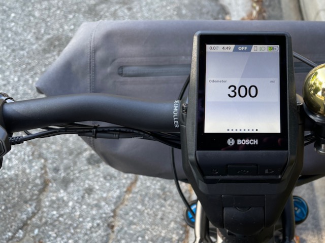

300 mile (483Km) Update: Even after sustaining the Force 5 hurricane in my mailbox (the credit card bill lol) and writing the check... I still bloody love this bike! It opens everything up to me. Long rides, short rides, crazy steep hills, terrible roads, train tracks, whatever, I can go anywhere on this thing. Took it in to the shop for the free checkup/inspection/torque&tension check last weekend, and it's pretty much bedded in. I have the seat and handlebars, brake levers, shifter, shocks, etc. all set just the way I like now. Zero problems, all brilliant.
Some notes, having had it for a couple of months now: No problems at all with der Rohloff. The thing's not even broken in yet. No leaks, no problems. And I love it. The gearing is so wide that I could get home even with a dead battery - just slower. 1st gear is crazy low for most hills even without assist, and 14th makes for a pleasant cadence even at top assist speed of 28mph/45kph. Fox suspension is great. I can't compare it to the standard suspension, but I can say I've run it locked out on nice roads, medium on typical city streets, and fully open on crappy roads and dirt roads, and it has performed superbly. I like the adjustability. Brakes: Awesome. I have total confidence. Battery has plenty of juice. I'm not even thinking about getting a second one yet, up to 35-mile/56Km hilly rides no problem. On flat terrain I could easily go far more. Tires - the Johnny Watts tires are great, but I think I'll opt for the Marathons when the knobbly tires wear out. I don't do enough mud and muck, and I'd rather have the smoother tires that will still do fine on dirt roads. Overall - this bike is totally solid. No rattles, totally solid, confident feel. The only stuff that rattles is the various junk I put in my bags.
300 miles in 2 months is really nothing compared to what some of the hardcore types do, but so far all is good. I'm still working out a route to my office. It's only 13 miles/21Km each way, but finding a route off the major car streets has been a bit vexing. Once that's sorted, there's another 500+ miles/month lol.
Anyway, I am pleased. Or as my friends from Jolly Old Blighty would say, I'm chuffed to the bollocks! It was a major purchase for sure, but no buyer's remorse whatsoever. This is a helluva bike.
