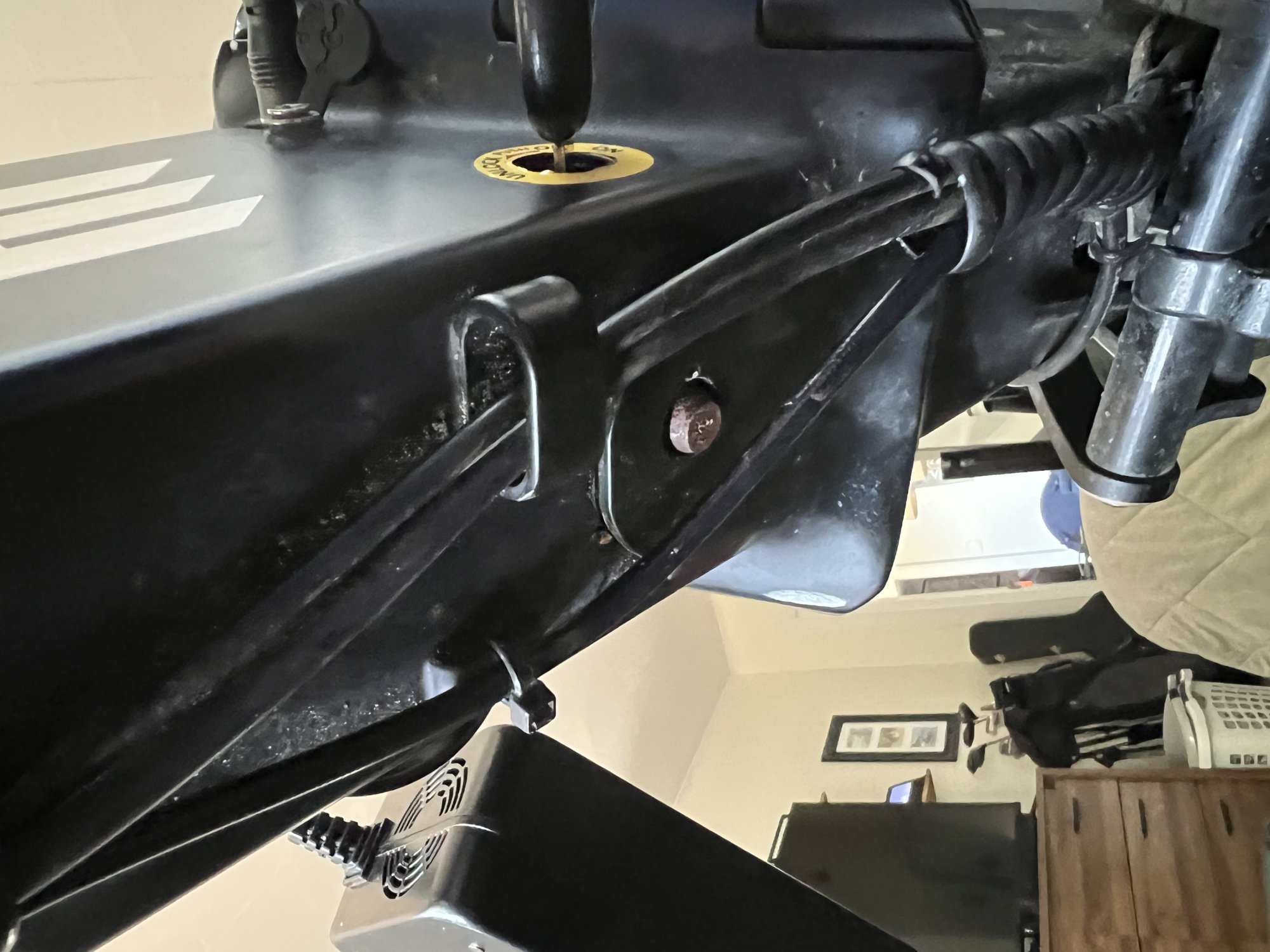

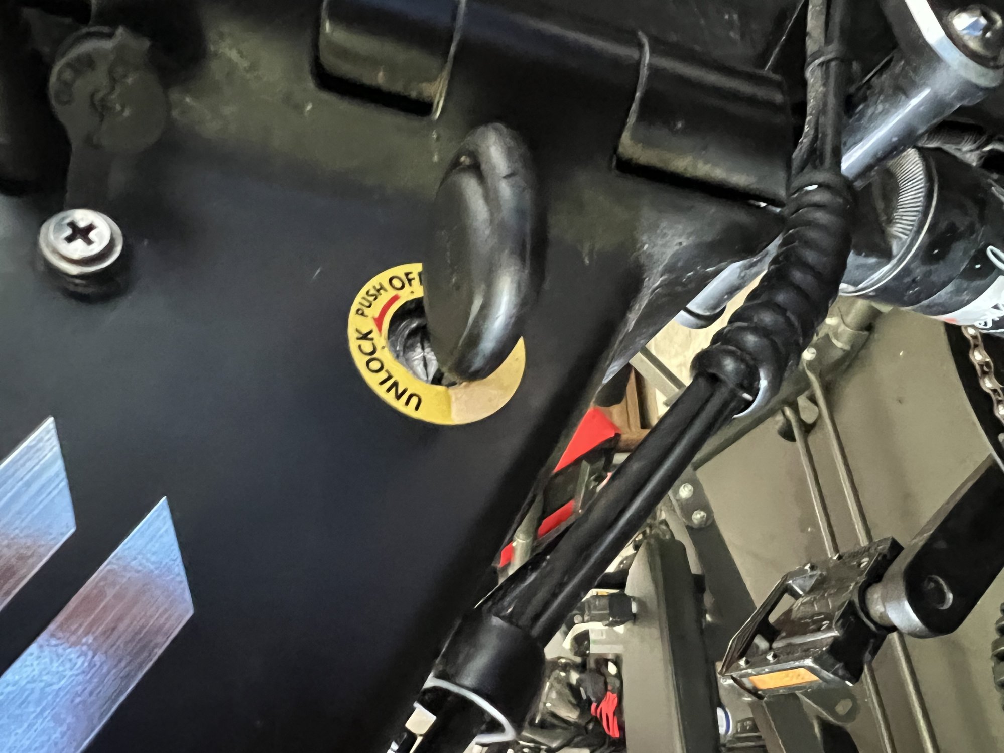

Thank you everyone for chiming in. MUCH appreciated. Here’s a couple photos:
If the lock isn't physically broken you should be able to heat, lube and jiggle it free. Take your time and keep inserting and removing the key with a drop of penetrating lube on it like WD40. . Let it sit for few hours or even overnight if you doesn't work after 5 minutes or so.
