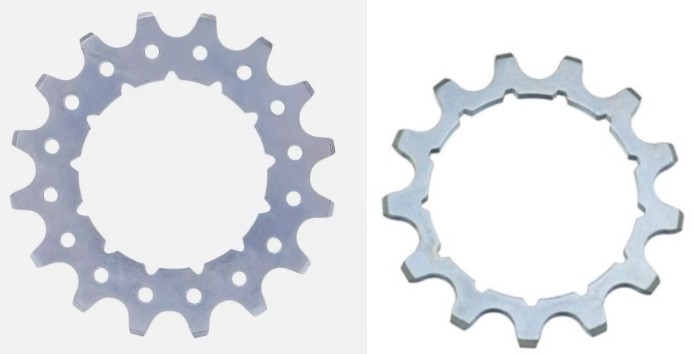

A few months ago I replaced the 16T rear cog with a 13T rear cog to achieve a more desired gear ratio. I wanted more top end. The change was nice, more top with some still serious climbing ability.
After a few months of riding, the 13T cog broke in two. I surmise that becuase it is made of much less steel than the 16T cog, it could not handle the continued stress of the Bafang Ultra. I reinstalled the 16T cog, I'm going to move to a 50T chainring intead of my 40T chainring.
