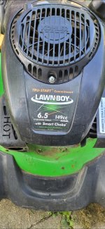

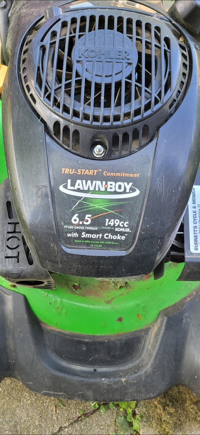

I ended up buying a used 21" self-propelled Lawnboy gas burner for $100,..
It just needed some adjustments and it's working great.

It hurts my eyes to see a 4-stroke Lawn Boy. I grew up with a 2-stroke model and have always had a fondness for them. That being said i have a battery mower now!
Me Too !!
That thing just kept going !!
It had an Aluminum frame, so it was light, and the wheels didn't fall off like when a steel frame rusted out.
It was really light even the engine was lighter being 2-stroke.
Always started and the only maintenance was to fill it with mixed gas.

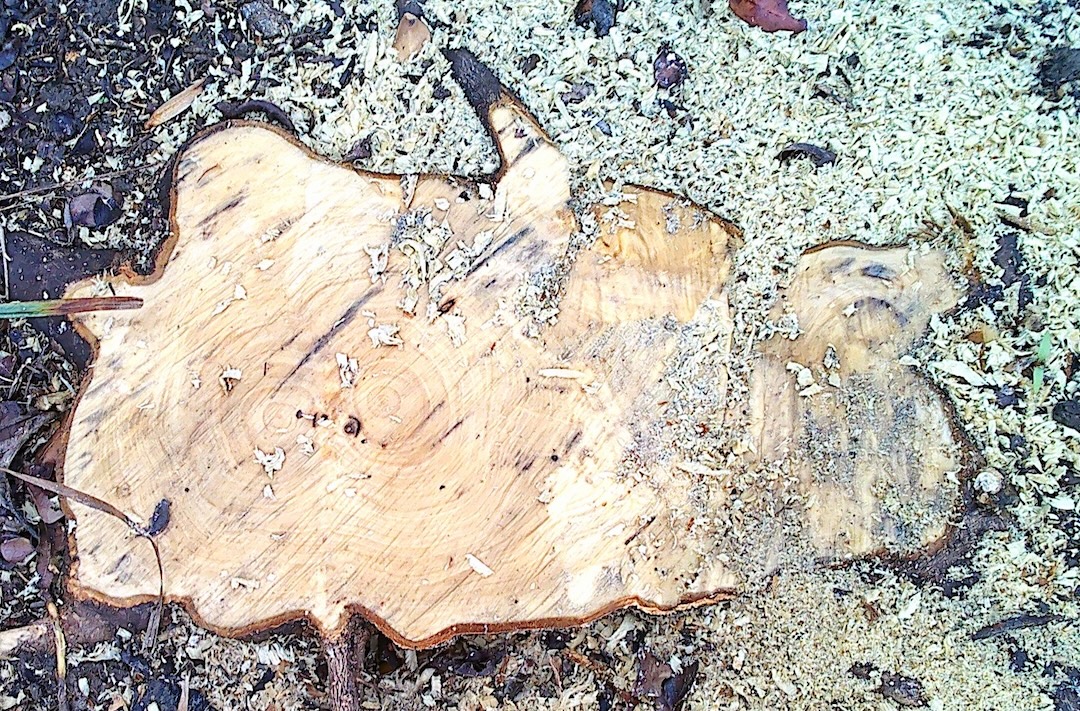

Filing the depth gauges didn't help much. Then I discovered that I hadn't been getting the teeth really sharp.
It goes back to October, 2017, when I cut down a Bradford pear that left a 30" stump in my front yard. With a diamond burr and a foot switch, resharpening my chain worked so well that I decided to saw the stump flush, so that I could mow over it and it wouldn't be a trip hazard. I discovered that at ground level, the wood was very hard, fine-grained, and gnarly. I had to sharpen at least once because teeth that were sharp enough for other cutting would bounce off.
Lately I've been cutting similarly hard stumps. Teeth bumped a lot before starting to cut. I couldn't get it to cut except at the heel of the bar, which meant the toe could end up in the dirt. Sawdust was fine, a bad sign. With a stump, I want to be able to tilt the bar a little like the elevator of an airplane so that if I started 1/2 inch off the ground, I'd be at that height on the other side. Now the kerf was so narrow that I couldn't steer the cut at all up or down.
Sharpening made little difference, so I filed the depth gauges. When that didn't help much, I sharpened again. A glint on the side of a cutting tooth told me it wasn't sharp. I'd just dragged the back of a fingernail along the side of that tooth, and it had felt sharp.
Ha! It was only as sharp as cheap kitchen cutlery. The back of a fingernail will slide smoothly across the edge of a dull knife. If the nail drags, that's about as sharp as you can get cheap stuff. Better cutlery can take more of a razor edge. It feels as if it could shave a layer off the back of a nail.
The first time I sharpened with a diamond burr, the edge felt even more razor-like than new. After that, I was concerned only that I felt a drag as I dragged my nail against a tooth edge. That tool spun so fast that if the burr reached the edge, it was probably well-sharpened. I was more concerned with not overheating the edge.
In 2023 I changed to an adjustable-speed Dremel. A slower speed reduced the risk of burning diamond points or an edge. Now I see it also meant that an edge that would drag against my nail might need a couple of seconds longer to be fully sharpened. I believe my chain has only 28 cutters. It didn't take long to go around, touching up top and side edges until they felt sharp enough to shave the back of a nail.
What a difference! It went through a troublesome 14x8" holly stump quickly and smoothly, with the toe of the bar. Sharper side edges gave me a wider kerf, which helped me keep the cut 1/2" off the ground, where it started, where it ended, and on each side. That's close to flush. If I want it lower, I can use a framing hatchet as a chisel.

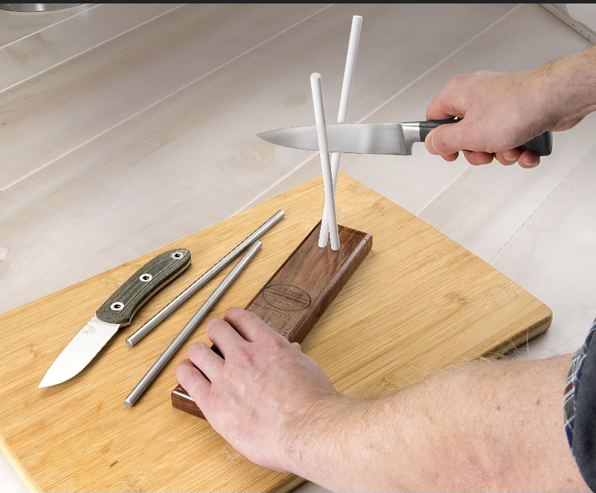

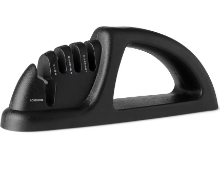

I've had knife sharpeners like these,..
But they put the knife in your hand with the tool on the bench.

I tried one of these, but it only sharpens one side of the blade, and I had No Luck holding the damn thing at the correct angle to sharpen a blade.

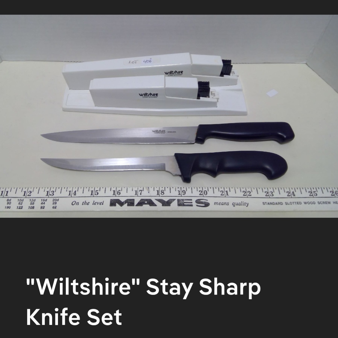

I still have my Wiltshire knives like these and they sharpened Easily because the housing kept the knife at the proper angle.
The housing that hold the carbide cutters finally had one of the cutters fall out and it no longer worked.
That's when I started looking for a new knife sharpener.
The AccuSharp leaves an edge similar to the Wiltshire.

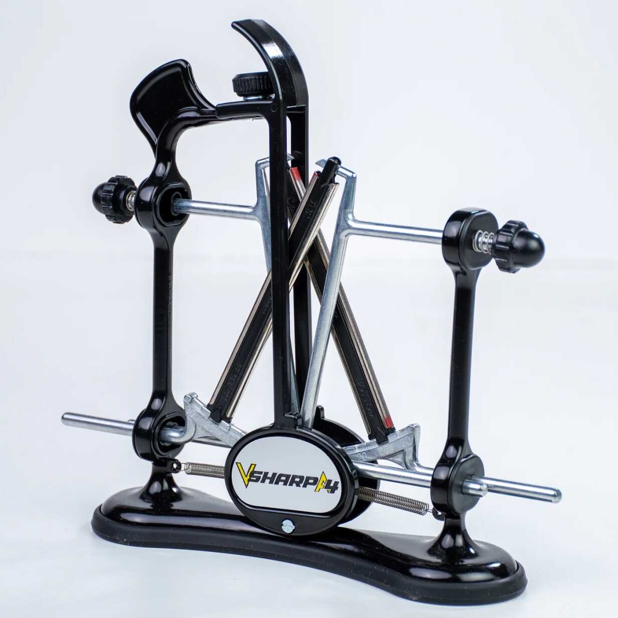

Knife sharpener? I recently bought something called a Warthog. Not cheap, about a $100. Works amazing and I’ve tried everything. Kind of like the twin angled sticks but spring loaded.

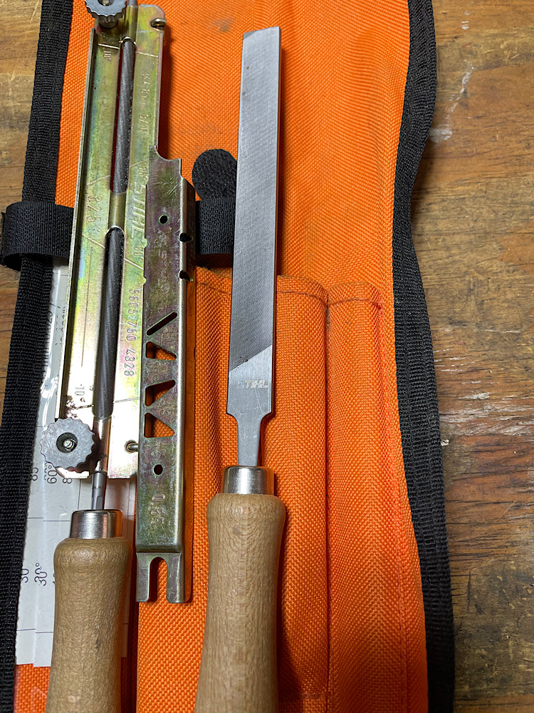

For sharping a chainsaw chain I will recommend getting a file with a guide and using that. It takes some practice but it’s not that hard. I’ve learned to take a look at them with a magnifying glass to see how I’m doing. They also make a Two In One file that has a flat file along with a round file and it files the rakers along with the teeth.

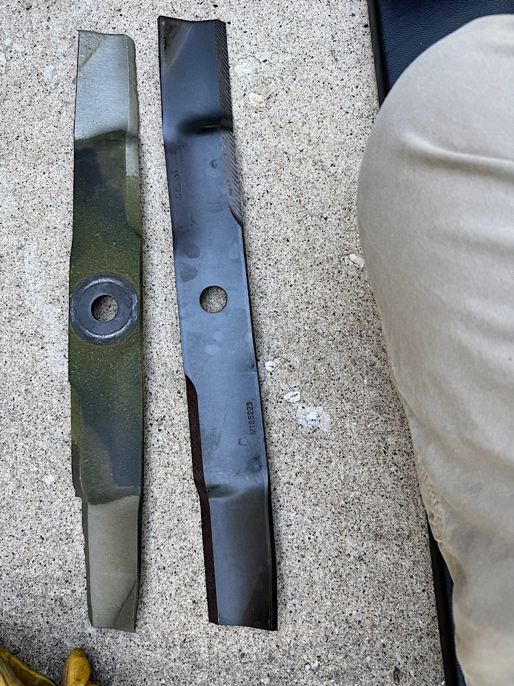

I sharpen mower blades with a bench grinder. Eventually they need replaced. I just replaced mine with three new blades, it’s a 60” deck.

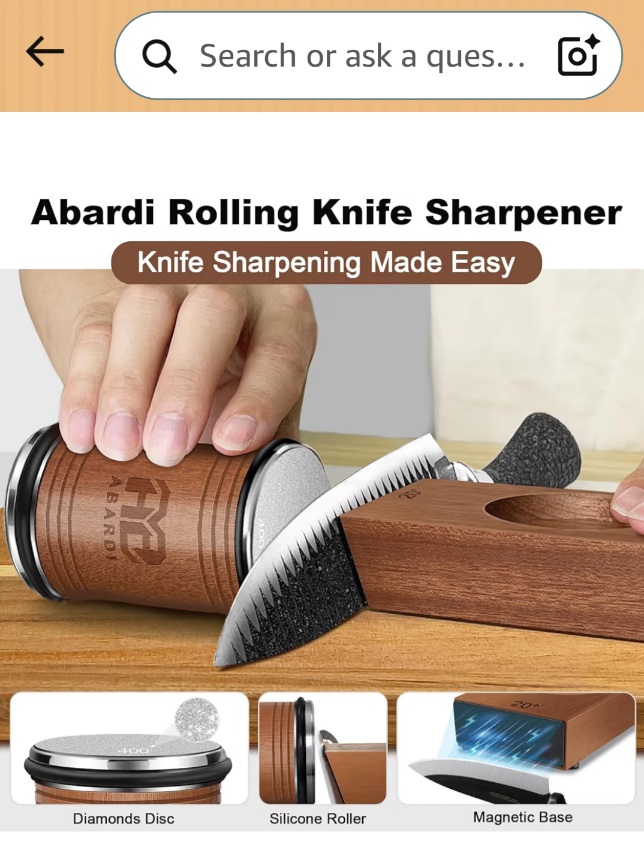

I'm pretty sure that I wouldn't be able to get that to work for me, because I'd still be holding the knife in my hand.
I'd just keep taking the edge off with one crooked stroke after another?
What about this one?
It seems to suit me because the knife is stationary, and the "sharpener" seems to keep everything square by itself ??
I was considering trying one.
With the Warthog knife sharpener there is a guide and it sharpens both sides at the same time. You have to see it used to understand. It sharpens a knife in just a couple of minutes. The store I bought it at had one setup for you to try and I always did my pocket knife when I was there.

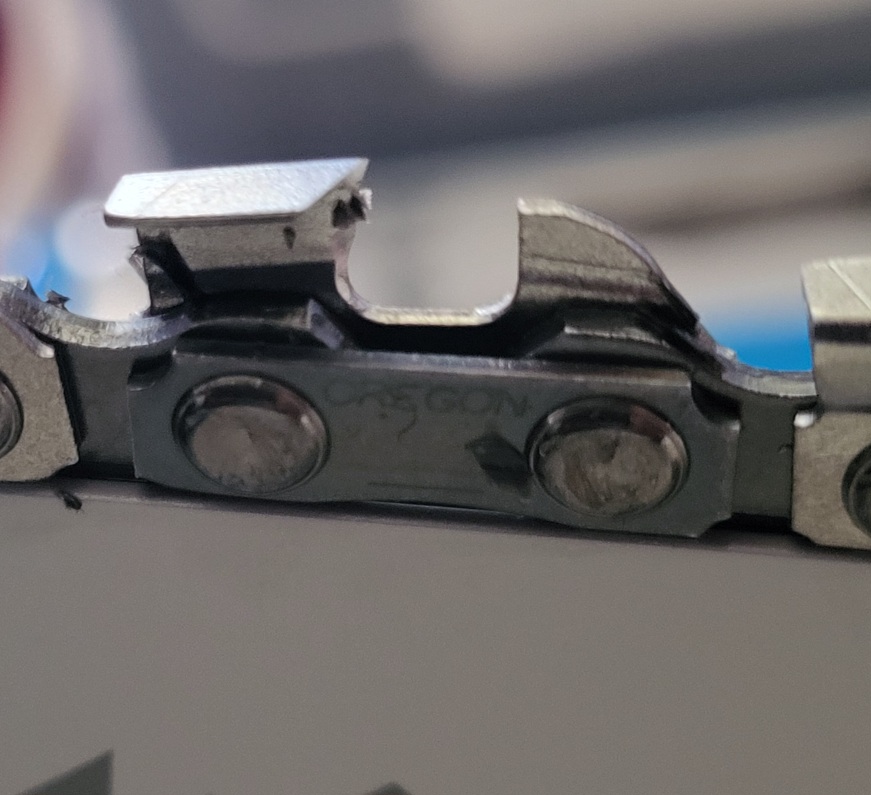

So I just did some investigating.

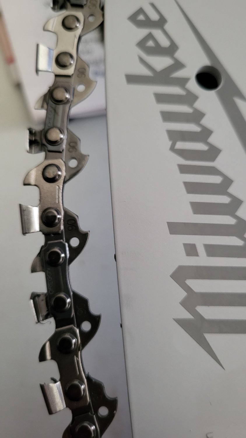

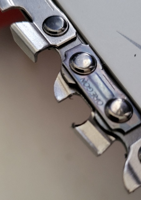

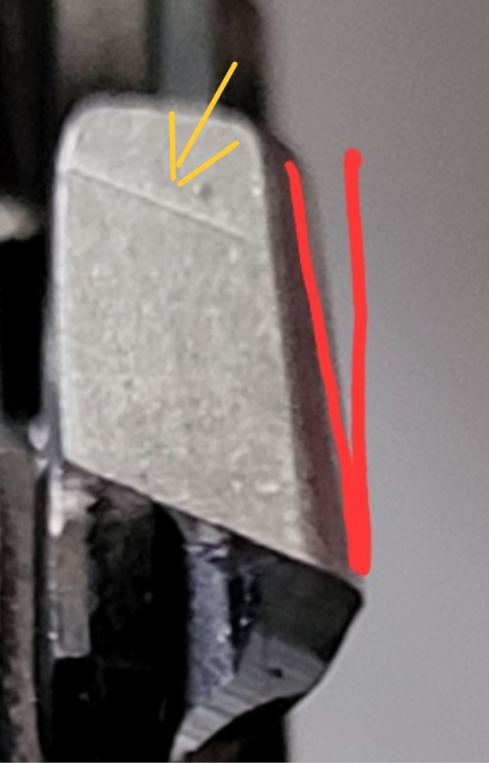

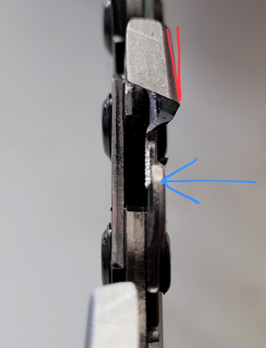

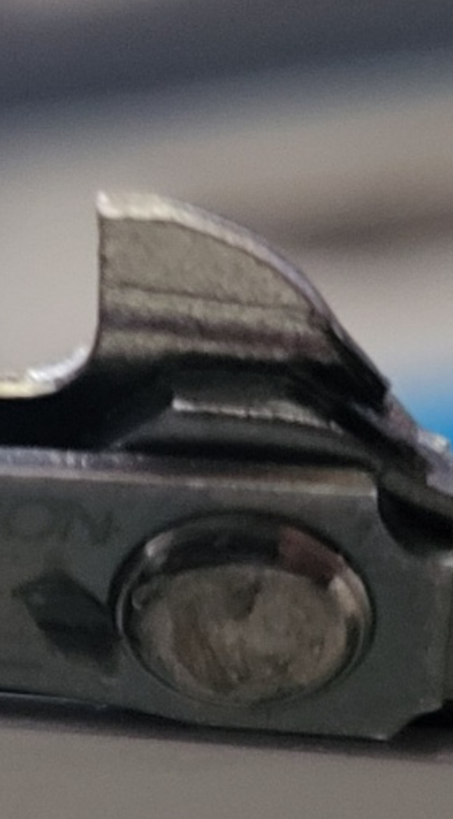

This is the brand new chain on my Milwaukee hatchet chainsaw,..
So the blue arrow must point to the depth "guide"

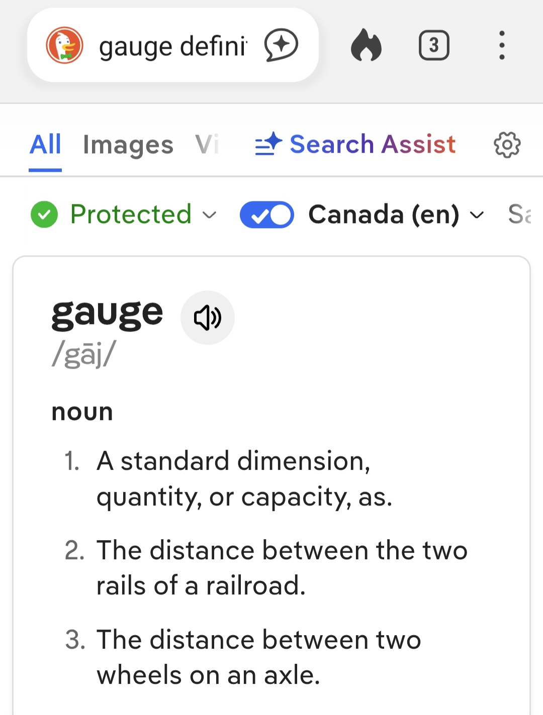

(A "gauge" is a measuring device not a "device")
So,..
As the chain wears and the teeth get filed down after multiple sharpenings, the "angle of attack" into the material gets reduced because the tooth is angled and tapered.
(The red angular finger drawn arrow)
So,..
I guess that some day after many sharpenings, I'd have to thin out the depth "guide" (not gauge) so that I'd take more meat off with the cutter following it ??

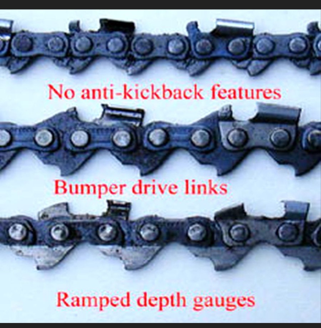

Then I did another search and found this,..
What the hell is an "anti-kickback chain" ??
Or "Safety Chain" as you call it??
I thought the underside of the cutters were only there to keep the chain on the bar, I had no idea that there were different kinds of undercarriages ??
After more investigation and pictures, I found this on my new saw,..
So,..
It looks like I've got "ramped depth gauges" that automatically take care of all that angular momentum stuff and always cut perfectly no matter what ?? 😁

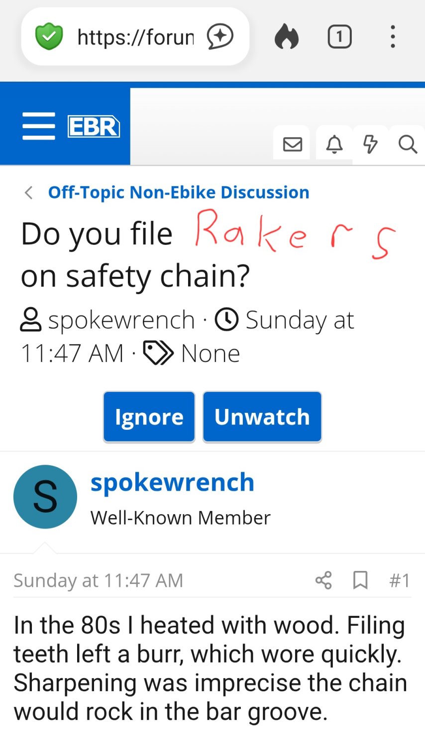

"Do you file depth gauges on safety chain?"
I honestly thought that you were filing tiny little marks on the flat side of every cutting tooth on your chain to "gauge" the amount of wear over time.
"Do you file down your depth guides on safety chain"
Makes Way More Sense To Me,..
You do file down the rakers on a safety chain, they control how deep the teeth dig in. If the rakers are too tall, a poor cutting chain. If the rakers are tool low the chain can bog down the saw because it’s cutting too deep. A safety chain reduces kickback. That’s where the saw grabs and kicks up toward your face. I included a picture of a Stihl sharpener kit I bought years ago. You need to replace the round file on occasion.
The tool on the left is the round file with a guide on it to help you get the correct angle. The file on the right is a flat one for the rakers. The tool in the middle is the gauge I use for the rakers. You set the gauge on top off the chain until the raker is in the u shaped area at the bottom of my picture. The raker shouldn’t be sticking up above the surface of the gauge. If it is you file it down. You should do every single raker this way but I check a couple and then just file them the same amount. Like I say with a little practice it’s a 5 or 10 minute job and it saves time because the saw cuts so much better.
Another tip. In PCeBikers post above with the red and blue marks in the picture, if you look at the picture of the tooth(the red mark beside it) there is an etched line of the tooth towards the back. The etched line shows the correct angle to sharpen at plus when you hit the etched line from filing the tooth down, it’s time to throw the chain out. You can see how much wear you can get out of a chain.
.. there is an etched line of the tooth towards the back.
Ohh,.. OK 👍
I thought the dude that painted the chain had a problem with his spray gun. 😁
EDIT:,..
You mean this line,..
That makes more sense.
