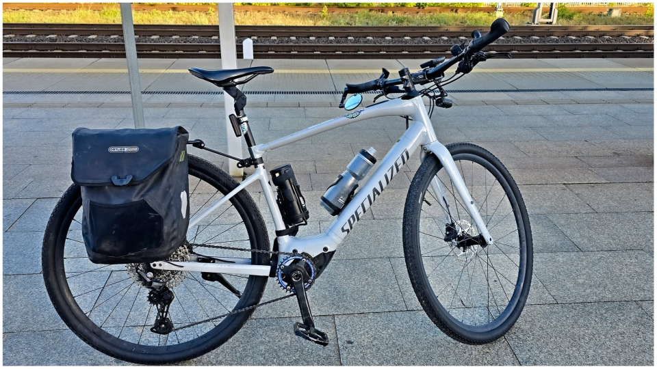

I guess I wasn't clear. My issue is that I don't know anything about how the crank assembly goes together on these bikes. The last time I worked in that area was 20 years ago when I replaced the 9-speed Sora components on my road bike to a full 105 10-spd groupset. In that case, if I wanted to change the chainrings, I could take the left-side crank arm off, pull the crank axle assembly out the right side, and it was right there in my hand. On the SLs, however, the chainring is not attached mechanically to the pedal crank and I don't have a clear picture of exactly what's there and what I'd have to pull off in addition to the pedal assembly. I assume there must be some sort of sprag clutch or equivalent involved that lets the crank drive the chainring in the forward direction but "freewheel" when pedaled in reverse. I just need to know how to get access to the chainring bolts. :)

You may have hit on the solution for me. While searching for chainrings with the proper specs, this site turned up. It looks like what came on my bike and indeed my bike is on the list of bikes equipped with it. I took a closer look at mine and it indeed has the narrow-wide teeth. So I'll just stick with what's already on the bike unless something doesn't work after I've done the rest of the conversion.
ahhh, yeah you don’t need to take the cranks off. the clutch mechanism for the SL motor is essentially inside the motor, and the spider for the chainring is attached to one side of it and the crank to the other. you remove the chain guard / pant leg guard and access the bolts from the “inside” (non drive side) through or below the frame. obviously you have to turn the cranks a few times to get to all four.
are the bolts not visible when looking at the non-drive side of the chainring?
