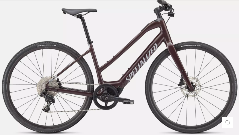

I've been perfectly happy with my Vado SL 5.0 and envisioned riding it indefinitely; at 80yo my bicycle adventuring days are behind me and I'm mainly interested in just enjoying my rides. However, for various health and safety reasons, I would really be better off with a step-thru frame but have had trouble finding one that's suitable. I'm not going to detail my requirements since I'm not looking for brand/model suggestions here, but one of my biggest priorities was not adding much if any weight vs. the SL 5.0. There was a Trek bike that I was considering (FX+ 7S), but it has some possibly serious drawbacks, and the Vado SL 2 line has gone in a direction I'm not crazy about and weighs too much.
Anyway, it turned out that there are still some "old" SLs available, including a step-thru in the right size. The only issue is that it's a 4.0 so I'd be giving up a few features. Not having the FutureShock isn't a big deal since there's always the Redshift solution, but I think I would really miss my Mastermind TCU and its MicroTune feature. However, I checked with the LBS and they've done a number of these conversions so it will be no big deal.
The huge plus factor for me is that all of my modifications and add-ons can be swapped right over from the 5.0. For example, my Redshift seat post is exactly the right diameter and all of my "handlebar hardware" items will fit the same. The biggest carry-over would be the $1K+ custom wheels with Onyx Vesper hubs that are still almost new; their boost hubs are not compatible with the SL 2 or any of the other bikes I've considered, but of course an easy swap to the NOS bike. I also have a barely-used extender battery that, again, will carry right over.
So when I went to the dealer I found that they don't draw from the same inventory as the "web store" does and they could only find the same model in XL. So I returned home and easily ordered it online. Looks like I have some (enjoyable) work ahead of me to swap all the parts around, returning my 5.0 to its original configuration and getting my new one ready to go.
