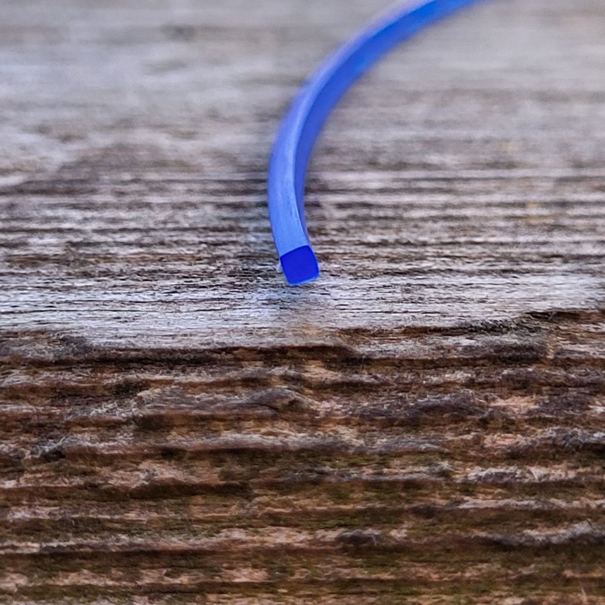

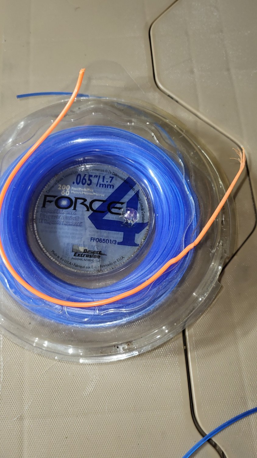

My string trimmer can really plow through the grass, but the string is round, and is probably the dullest shape possible?
Even a blunt edge would have corners that would help make it sharper.
Interestingly, I ran out of string for my trimmer and bought new line that turned out to be square !!
It works Way Better !!!
My chain link fence used to eat up all kinds of blunt round line because I had to rev the snot out of my trimmer to "beat the grass off".
With the square line, my rpms are Way Slower with the "sharpened corners" to cut through the grass, so the line just rubs on the wire fence instead of being cut.

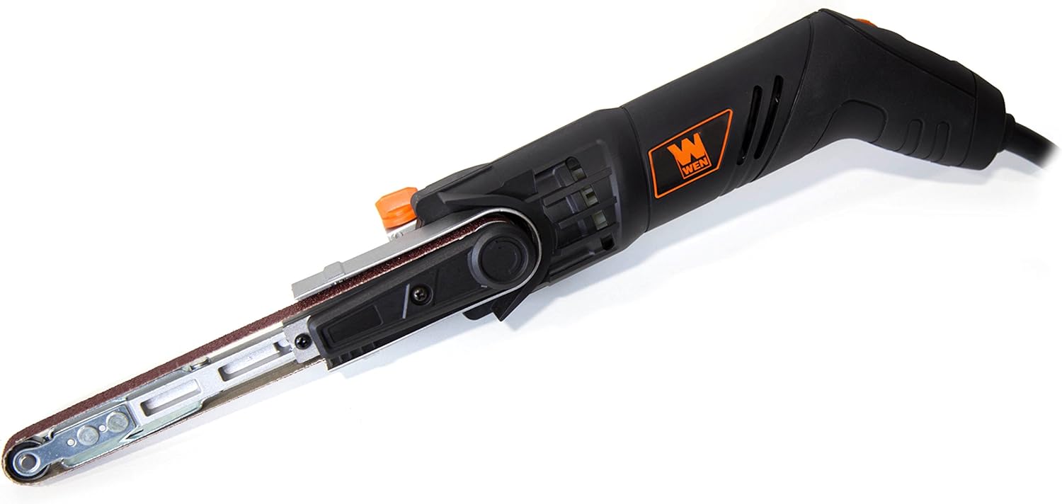

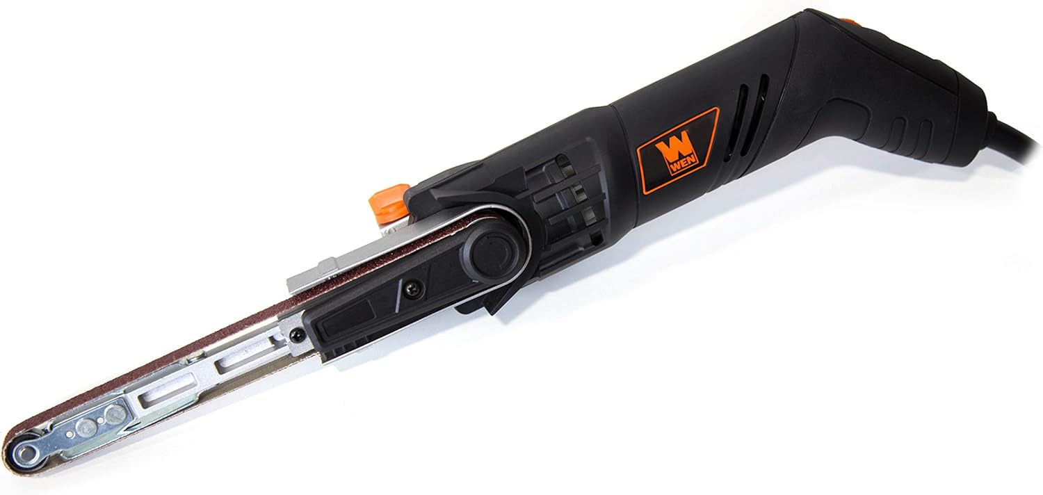

In 2019 I discovered the 1/2" belt sander. The speed can be adjusted between 10 and 20 mph. Almost no pressure is needed, so I can clamp a blade to the end of a board near eye level, where I can see up close. The length makes it easy to maintain a precise bevel, which I can find by painting the original bevel with a felt-tip pen. The ink also makes it easy to see when I've ground an edge sharp. I have a wide assortment of grits, and changing a belt is much cheaper than buying a file.

In 2019 I discovered the 1/2" belt sander. The speed can be adjusted between 10 and 20 mph. Almost no pressure is needed, so I can clamp a blade to the end of a board near eye level, where I can see up close. The length makes it easy to maintain a precise bevel, which I can find by painting the original bevel with a felt-tip pen. The ink also makes it easy to see when I've ground an edge sharp. I have a wide assortment of grits, and changing a belt is much cheaper than buying a file.View attachment 211314
Belt sander still heats the edge of the blade. I have a bench grinder and angle grinder so no advantage to the belt. I will never wear the file out on the soft blade.

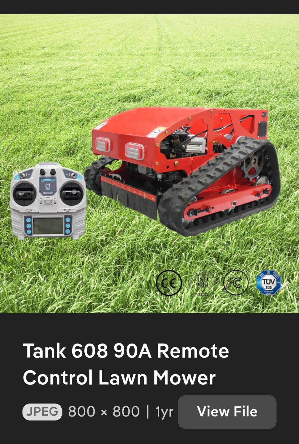

I'd rather have my mower be operated by a Dumb Ass than a Stupid Robot, so I should get one of these,...
And then modify it a bit so I could control it remotely with one of these FLIR headsets,..
Then I can just sit on my ass anywhere in the world and cut my grass.
🤔 I think that might actually make mowing fun ??
Some consumer mower blades are soft enough to file. The first mower I bought was a commercial Lawnboy. Commercial mowers and many consumer mowers have blades tempered to HRC 38 to 45. Using a file to sharpen the blade was like trying to file a knife. I ended up using a stone.
A 5" angle grinder probably scrapes at 150 mph. A bench grinder could be 45 to 125 mph, depending on the motor speed and the wheel size. My belt turns at 10 mph. That slow speed is a big advantage, and I have control suitable for sharpening a knife. I'll finish up with a diamond hone. After I mow half an acre, the edge will still feel sharp enough to peel a potato. Keeping the temper makes a difference.
