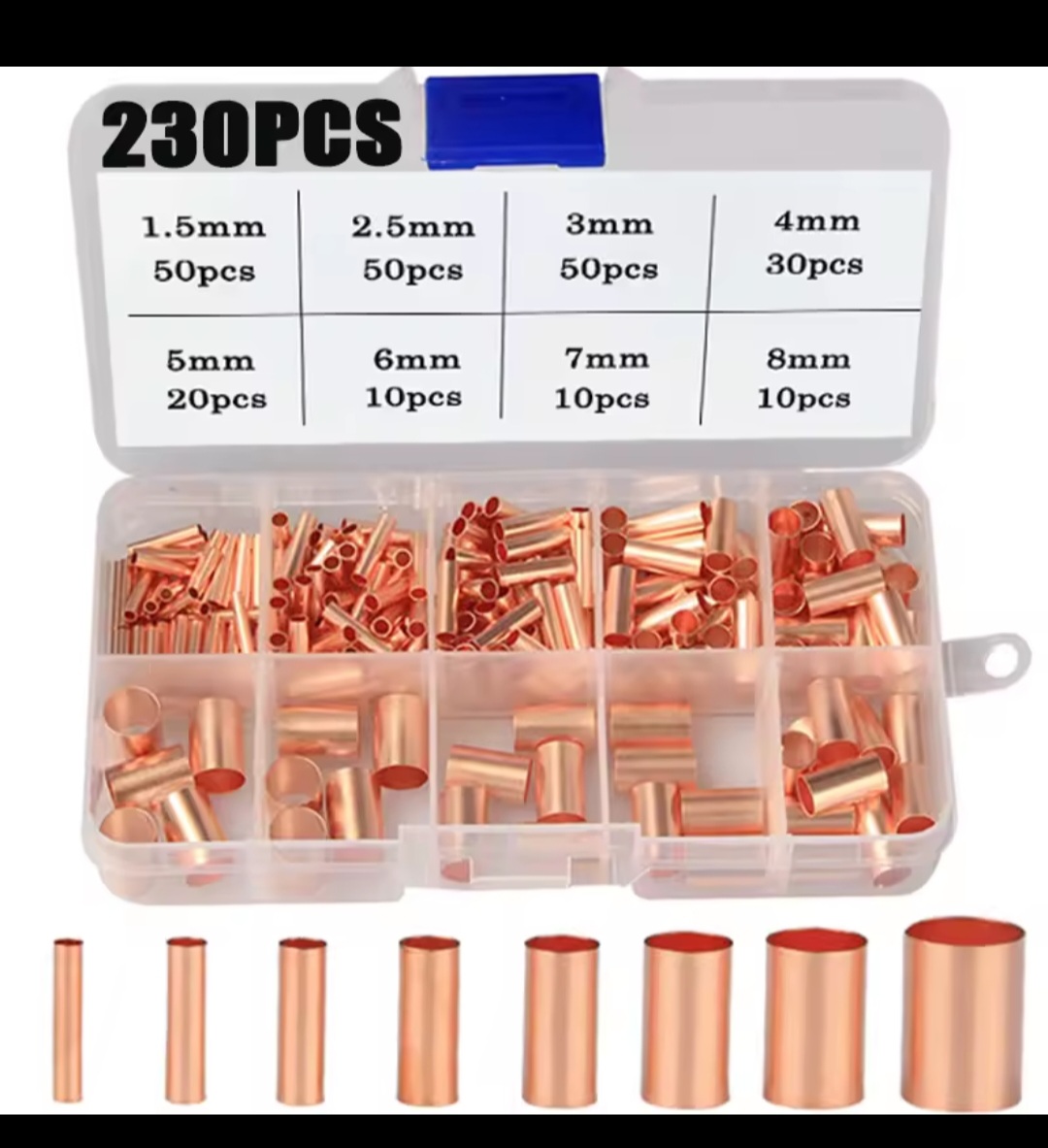

There's the crimp connections mentioned earlier in this thread that don't require special tools and are for small wires.

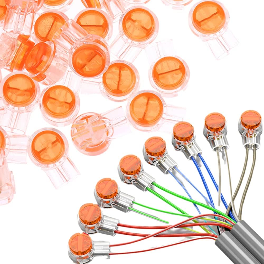

The trade name for those connectors is Corning Presslok. Yes, the glass people. Lots of imitations abound.
Most of the electrical manufacturers make a version... 3M, Ideal.
3M scotchlok even has sizes up to 14ga.

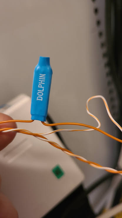

The blue long ones I've come across were always Dolphin brand

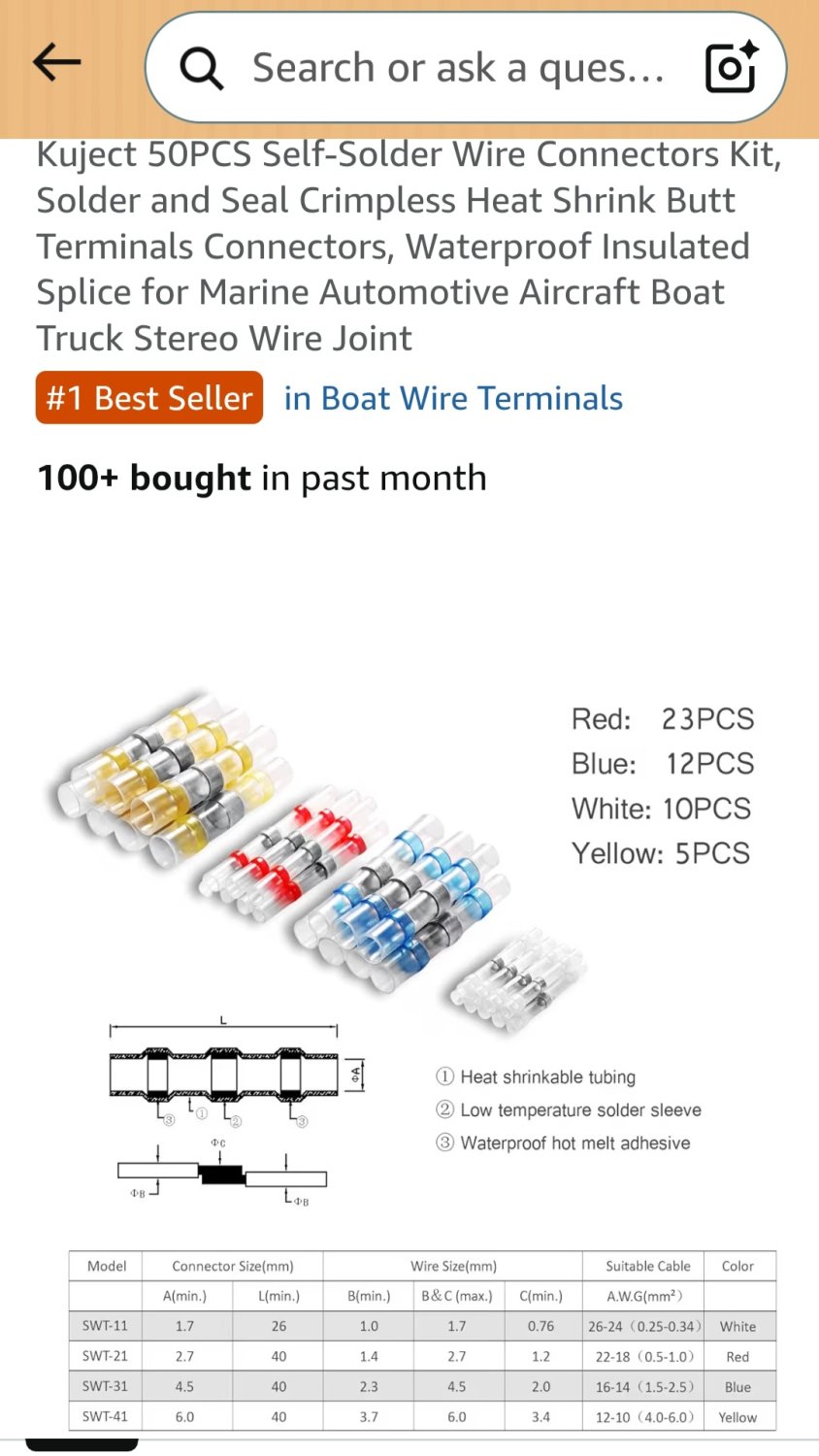

I also bought these crimp on butt connectors that I haven't tried yet either.

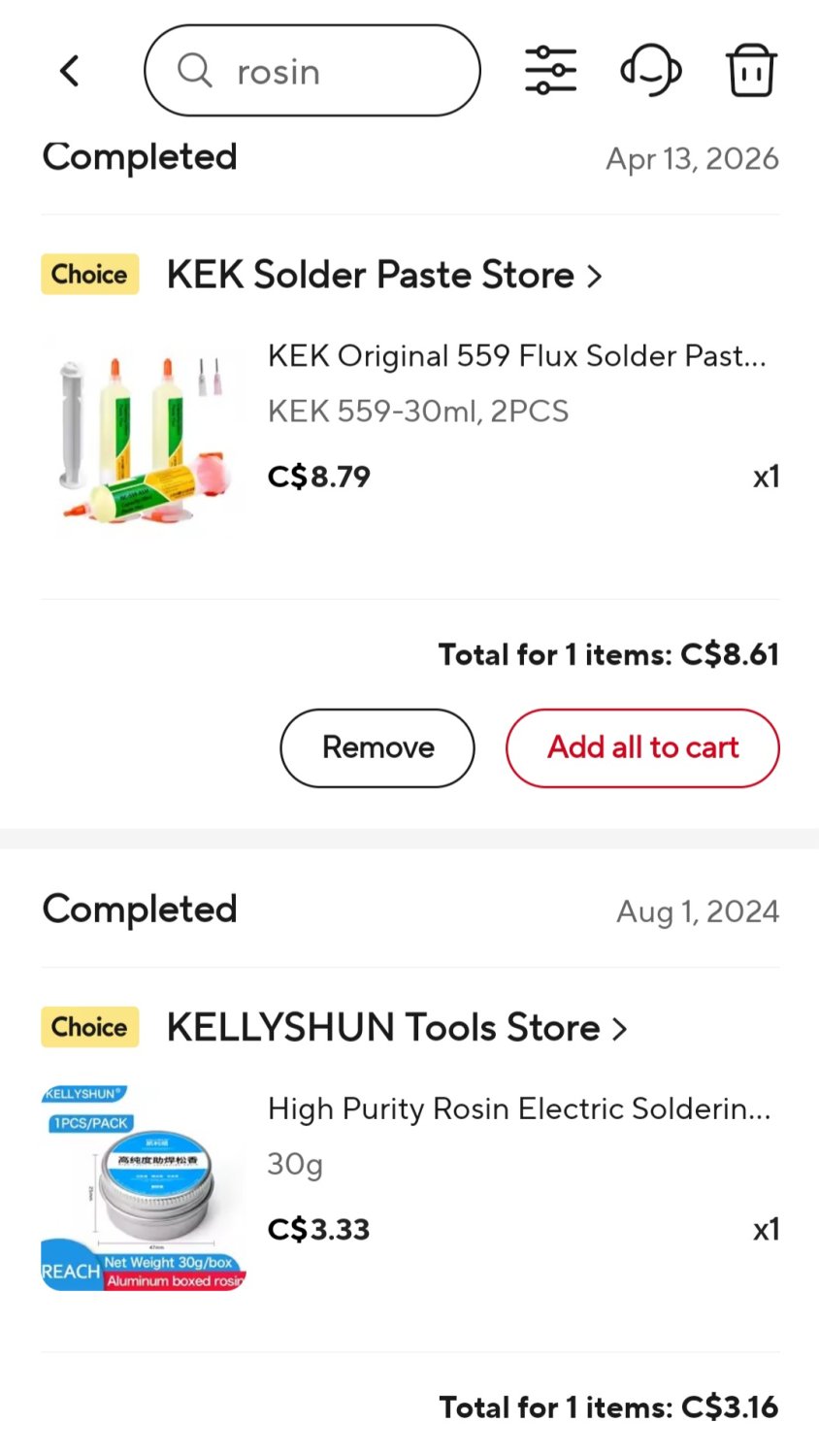

,.. I also have a small tin of flux, but you probably won't need that.
I bought a tin of flux, but it was as hard as a rock and I couldn't add it to a wire connection before adding the solder.
So I recently bought a syringe of "gell" flux to pre-treat the connection before soldering.
I haven't tried the gell flux yet either.

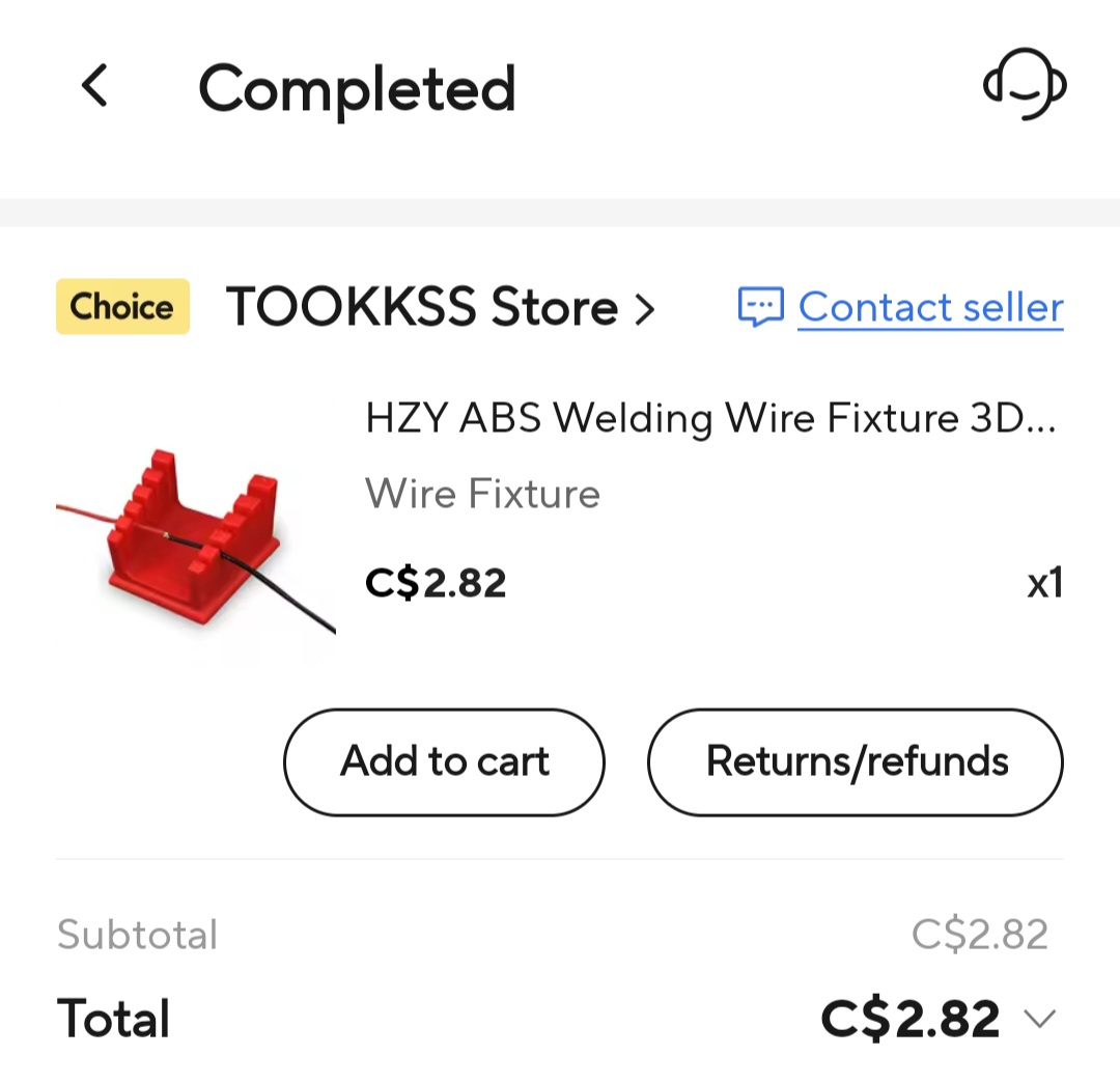

This also turned out to be a good purchase at less than $10:
I bought one of those too, but mine is hard plastic, and the damn wires kept popping out of the grooves.
Your rubber version looks like it would work better.
You shouldn't need additional flux 99% of the time if you are using flux core solder.

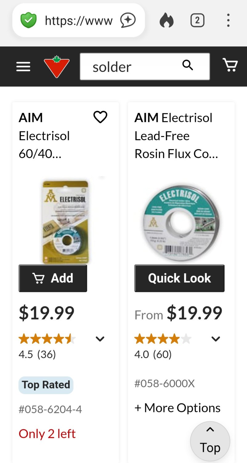

I couldn't figure out why my damn solder wouldn't flow properly, so I bought flux thinking it would help.
It turned out that I had bought the shitty silver solder.😁
So I went to Canadian Tire and bought the proper toxic solder.😁

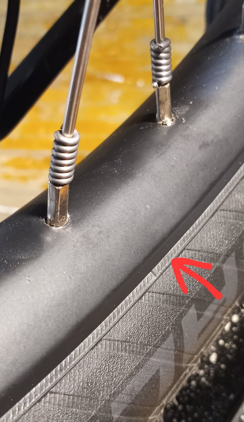

I didn't throw out the Shitty Silver solder, because it makes great adjustable spoke weights to help me balance my wheels.
I made sure to write "Shitty Solder" on the spool, to make sure I don't try to solder with it again. 😁
I am pretty sure the wire holder I have is made from silicone. It is very flexible and heatproof. It works great as long as your project can be placed flat on a table or bench. Like when shortening extension cables.
