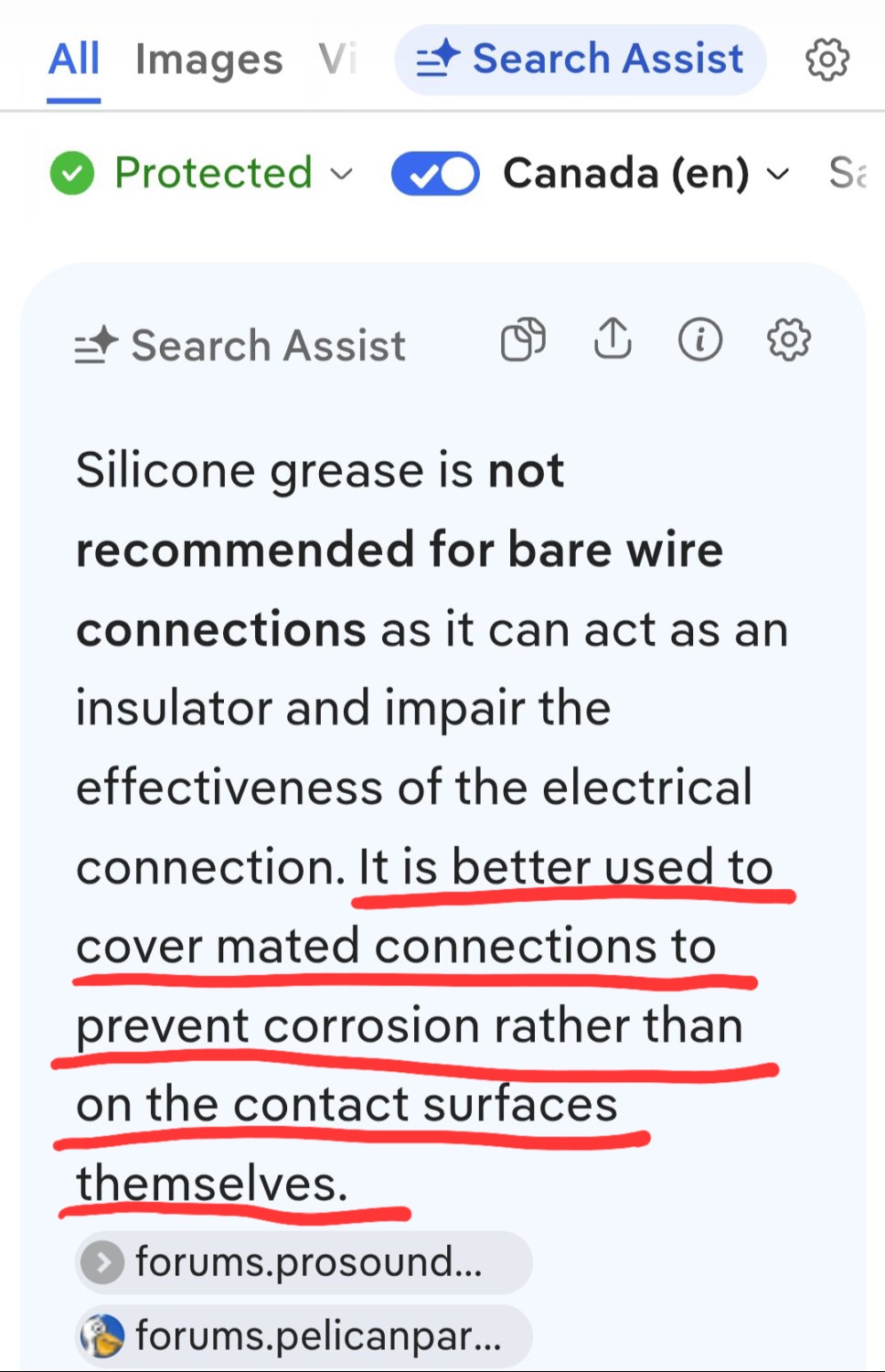

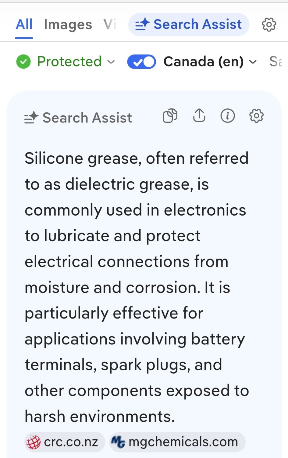

If you don't want to believe me... Listen to Professor Google 🙃
Do you silicone grease conductors or connector housing?
Silicone grease is used to seal the connector housing and exterior terminals, rather than the mating surface of the conductors themselves. It is an electrical insulator. Applying it directly between mating electrical contacts can increase resistance and cause connection failures, though it creates an excellent weather barrier on the outside.
Connector Housing (Yes)What it does:
Silicone grease provides a protective barrier on weather packs, O-rings, and rubber seals.
Benefits: It prevents water, salt, dust, and debris from reaching the pins.
It also lubricates the plastic components, making the connectors much easier to plug in and uncouple without damaging the seals.
Conductors / Mating Pins (No)
What it does:
Because it is an electrical insulator (dielectric), it blocks the flow of electricity if it sits between the metal-on-metal contact points.
The risk: Coating the conductive pins can introduce a resistive barrier, leading to voltage drops, intermittent disconnections, and localized heating.
For low-voltage or signal-level circuits, this can completely disable the connection.
Best Practices for Application
Make the connection first: Always ensure the wire-to-wire or pin-to-pin mechanical connection is fully seated and secured.
Apply to the exterior: Smear a thin coat on the back of the connector wire seals, the connector’s outer mating lip, or over exposed exterior hardware (like battery terminals) after they are tightened.
Use a contact enhancer if necessary: If you are looking to protect metal contacts from corrosion while improving conductivity, a specific conductive grease (not silicone-based) should be used.

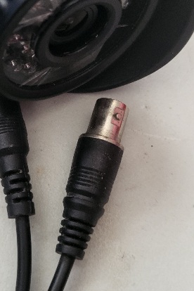

The only time I screwed something up was when I put it on a video cable connector and the video turned pale red.
I tried to remove it with contact cleaner and brake cleaner, but it didn't work.
I figure that the super high frequency of a video signal gets lost in the silicone?
Sounds like an RGB cable. Silicone grease has 2.5 to 3 times the capacitance (dielectric constant) of air, and that would affect high frequencies more than low. Was the connector flawless without grease? Maybe it fit too loosely to squeeze the grease out of the way.
Isopropyl alcohol above 180 proof is used to remove silicone grease.
One of these connectors for my outdoor camera,..

If it's a single cable, I don't know why grease would affect the color.

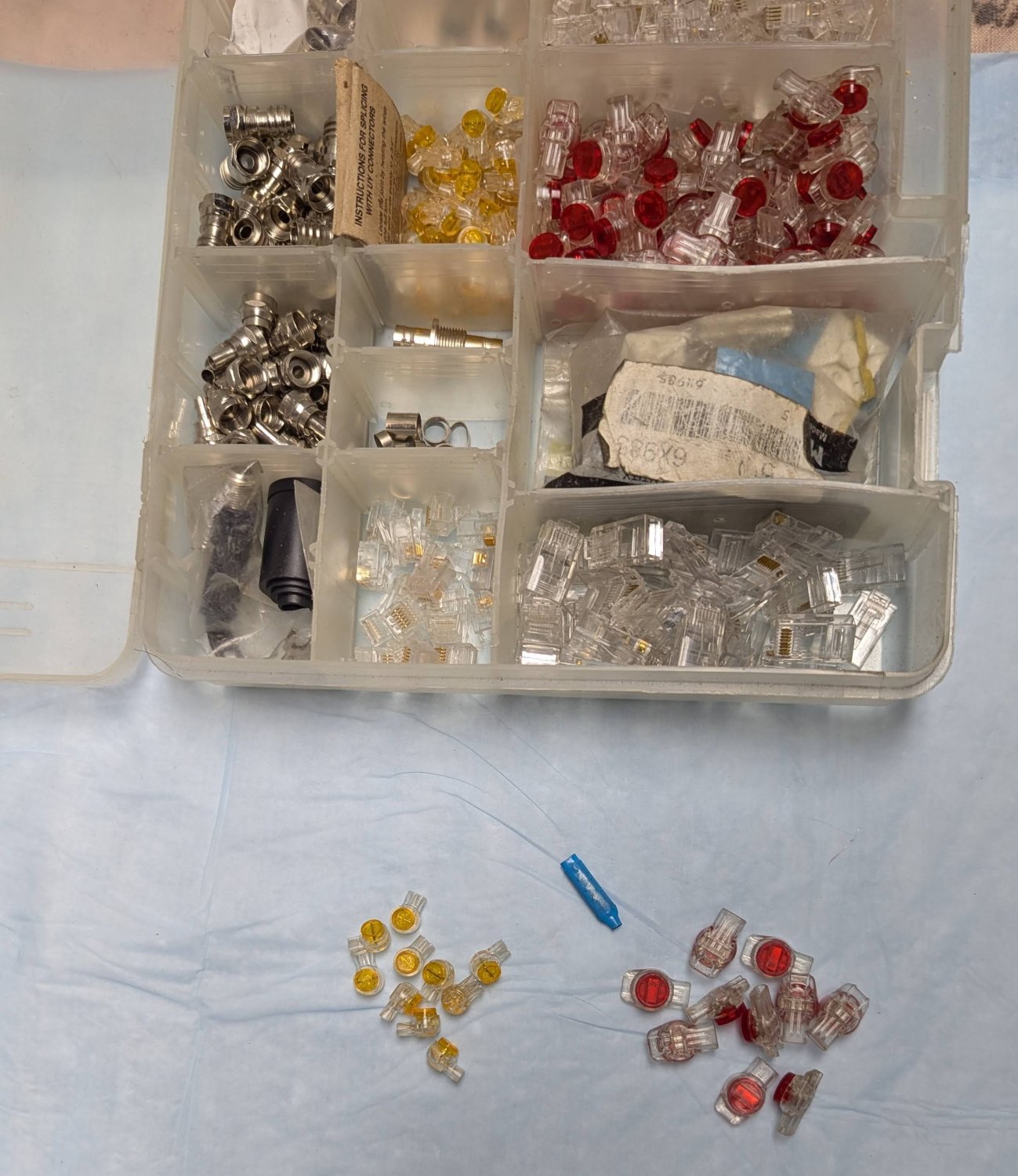

You guys are killing me with these.... "One time at band camp" stories.
Yeah I've used those many times....
... do you know how they work?
Because I do.

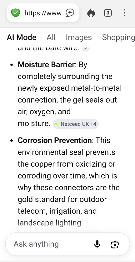

I'll let Google explain as I'm getting bored with you two 🙃
Read the "Why this matters" part twice
Additionally these are permanent connections and you'll destroy the connector and wire trying to disassemble once installed.
So yeah... Exactly the same as the Julet connectors you'all struggling with on your ebike.

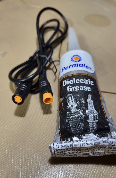

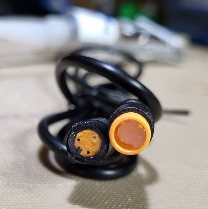

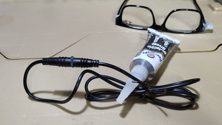

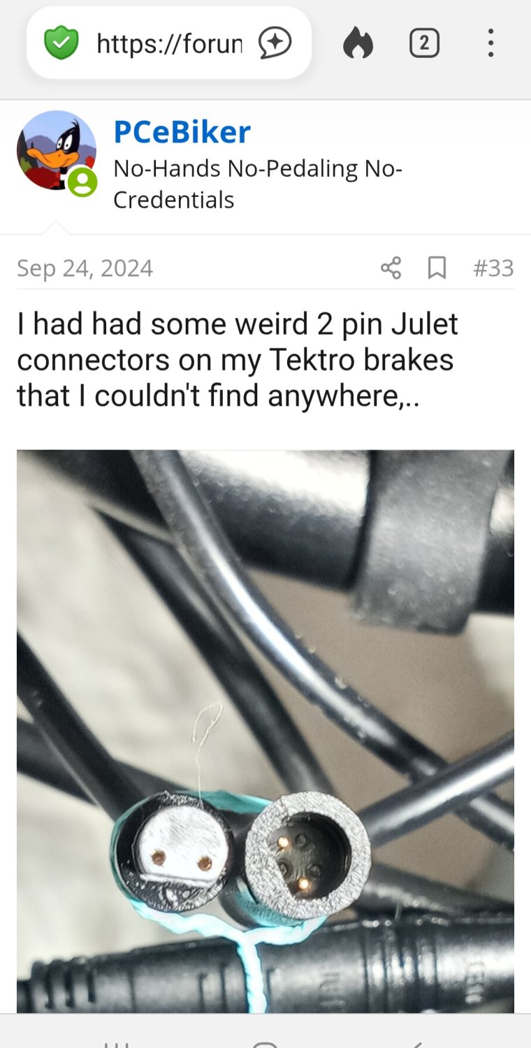

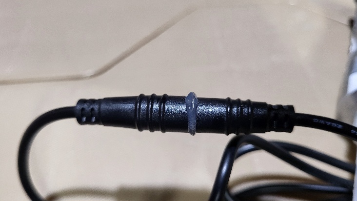

This is how I pack and seal my Julet connectors,..
YMMV 😁
The connector tries to push itself apart while I'm connecting it.
I have to "burp" it by slightly wobbling the connector as I'm pushing.
You can hear the bubbles of air popping.

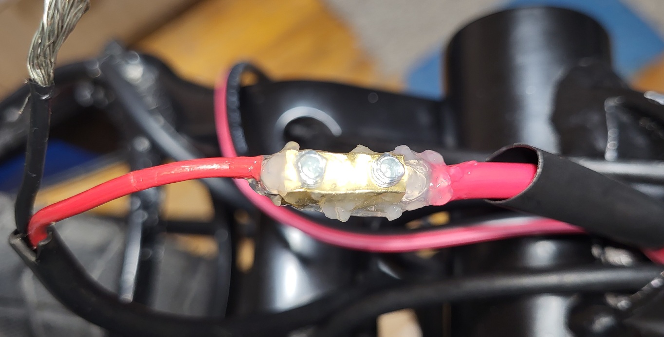

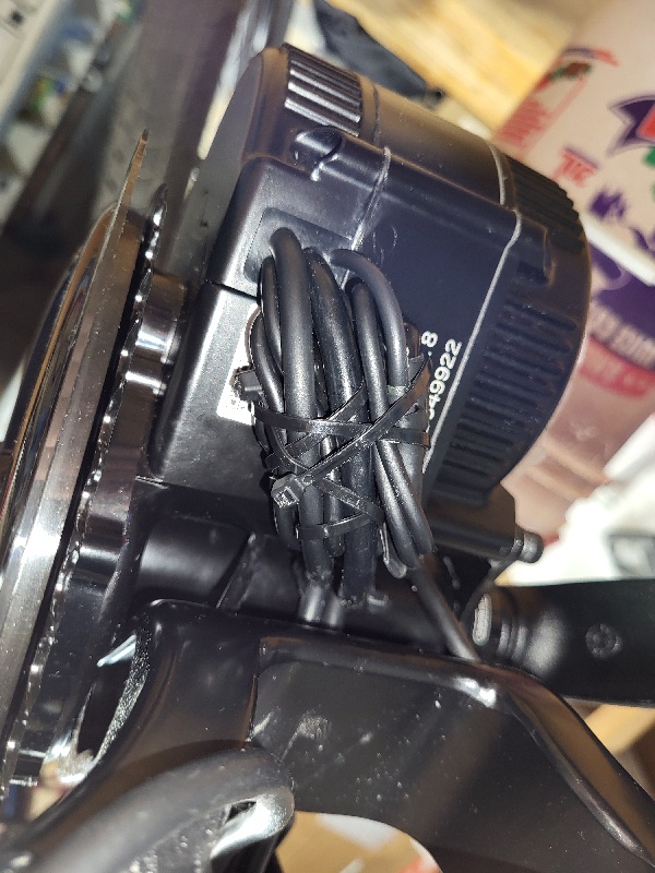

And this is how I pack and seal my battery wires,..

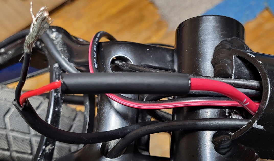

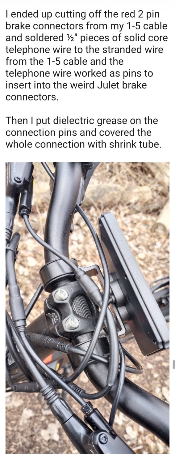

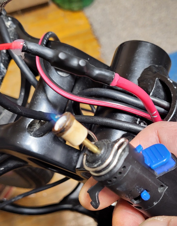

This is how I made a Julet connector.
I didn't want to cut the connector off the brake switch because I only had a few inches of wire to work with and I didn't want to replace the switch.
(screenshots from an earlier post of mine),..

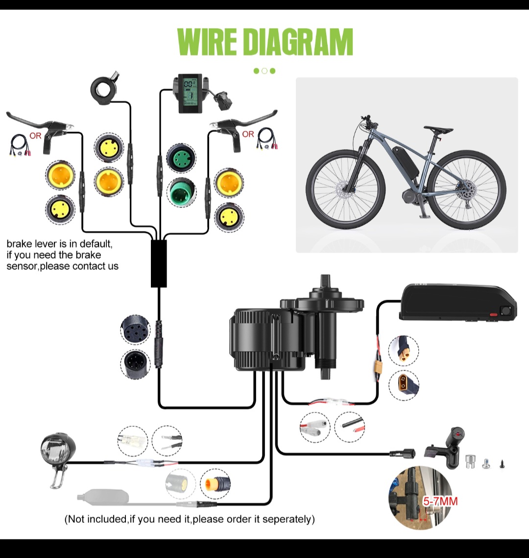

Yeah,.. I deleted and didn't install all kinds of stuff when I installed my BBS02B.
I sealed up all the connectors that I'm not using on the BBS02B with dielectric grease and covered them with shrink tube.
I'm not using the wheel speed sensor, shift sensor, or headlight.
With the hub motor, I'm not using the head light or rear tail light, and I removed my PAS sensor, so I sealed up those connectors and tacked them to my seatpost with hot glue.

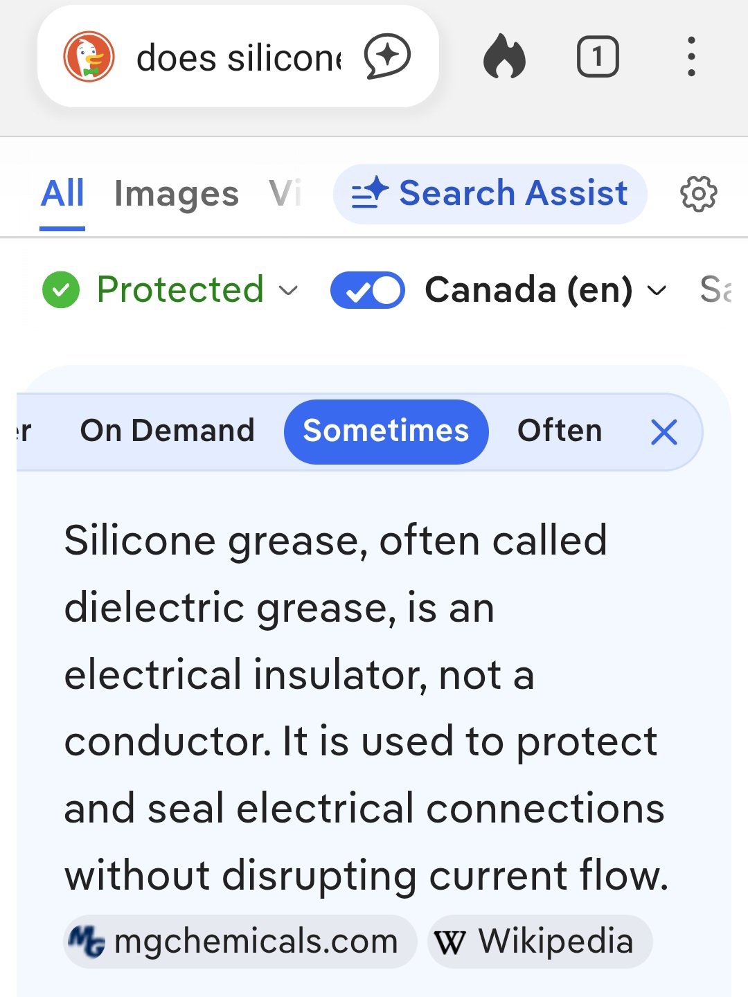

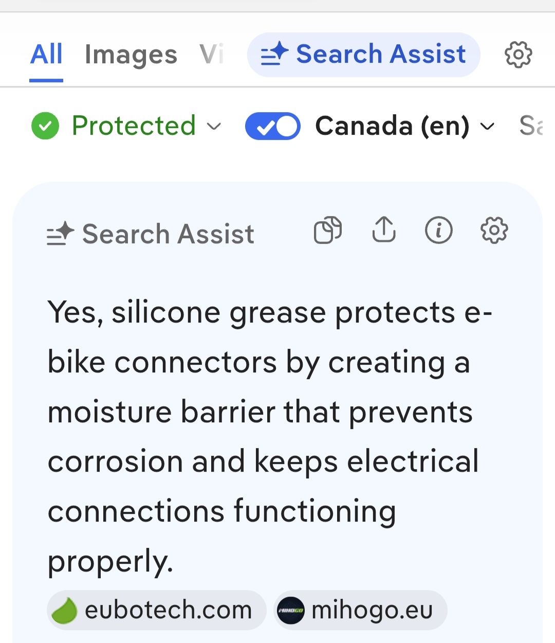

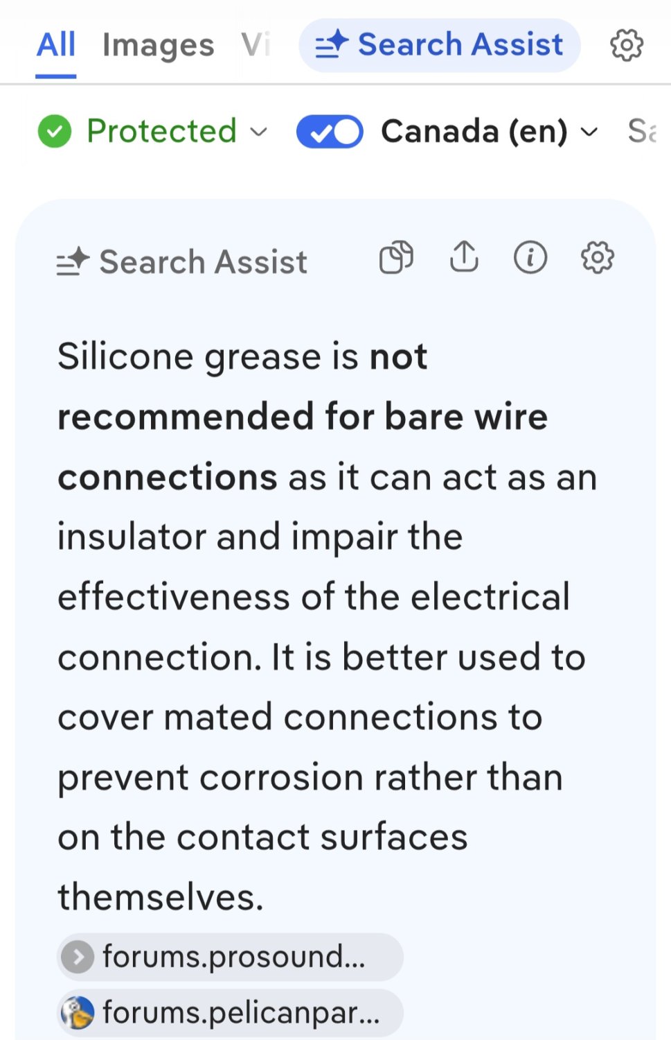

I used to wonder why everyone used to say, "Don't get grease on battery posts or spark-plug terminals!" I'll bet they read it on the internet! And you have Google AI read it on the internet for you. If Google AI read it on the internet, it must be true!

I think it is.
My homemade brake switch connector has been fine for more than four years.
If I felt the need to silver plate a Julet connector, I would cover the outside with more grease and throw a piece of heat shrink over it.
I would just simply solder a connection before plating it with fancy expensive metals.
To gold plate it, maybe use marine grade heat shrink... but that'll be a nuisance to disassemble.
Gold plated terminals covered in dielectric grease is your best option.
At no point would I coat the pins.
F-In Right I Coat the Pins.
Gotta seal out the oxygen and moisture,..
So believe it or not.. you're not smarter than the people that have been doing it for years with success nor the engineers that developed the best practices.
I'm not smarter than nobody.
I've just been dealing with dirty, fouled, bad connections since the 80's.
Preventing an intermittent bad connection by simply protecting the conductors, just makes sense to me.
does silicone grease protect ebike connectors
