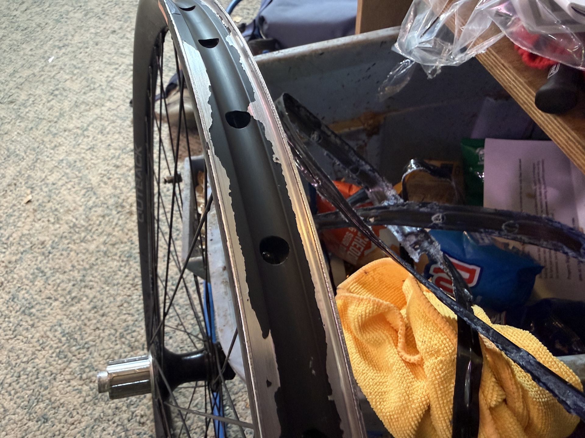

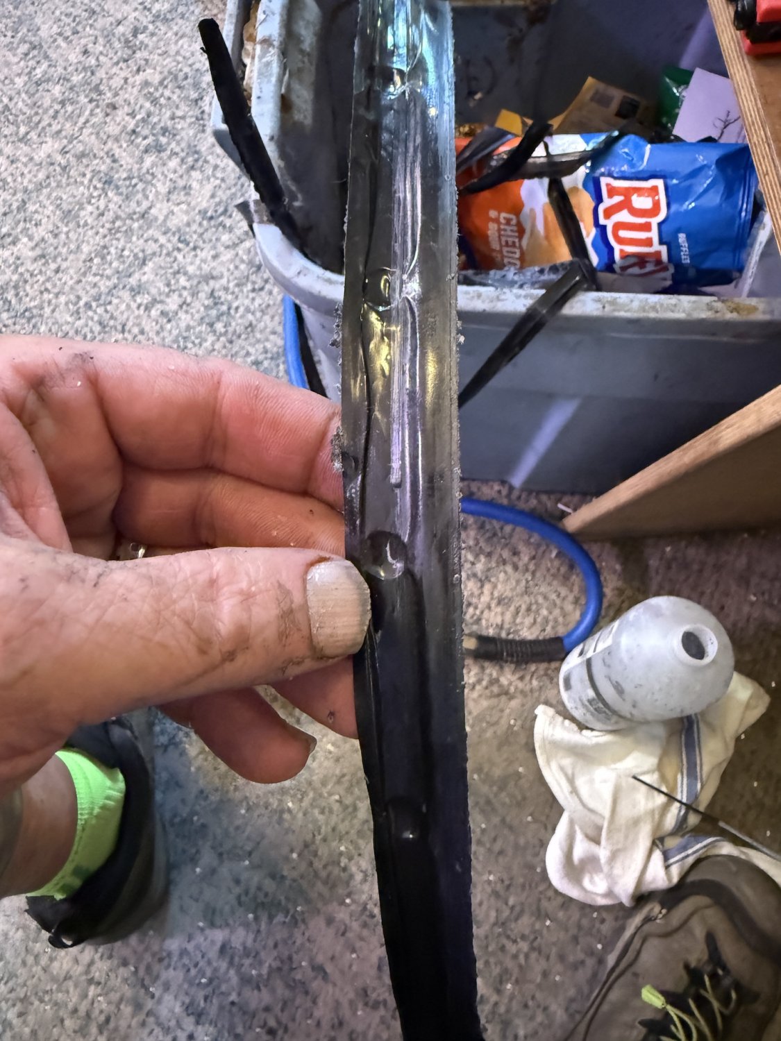

I bought this wheel earlier this year it came pre tapped with tubeless tape. it looked ok but not great. had some leakage for awhile but it settled now. well I had a flat when We went to ride the bike it filled up fine but next day it was a little low. so I added sealent as thats usually the issue. but then I found a cut in the side. so I gook the tire off put another one on and all the air would come ut around the stem. tried a couple of stems. so I finally figured it had to be the tape and man was it over. what I thought was tape was this black paint? not sure really the tape as you see had rolled up a bit but it also wasn't to wide enough it did not touch the rim walls. so I took a soft brass brush and scrubbed it got all the dried sealant off and was left with whats in the pic. I thought it was tape at first but you cant feel an edge to it so maybe the tape peeled it off? well reaped it with some good tape and it seems fine now, for a 750.00 wheel it seems pretty lame. I bought a 150 wheel locally and they had dt-swiss tape on it.
