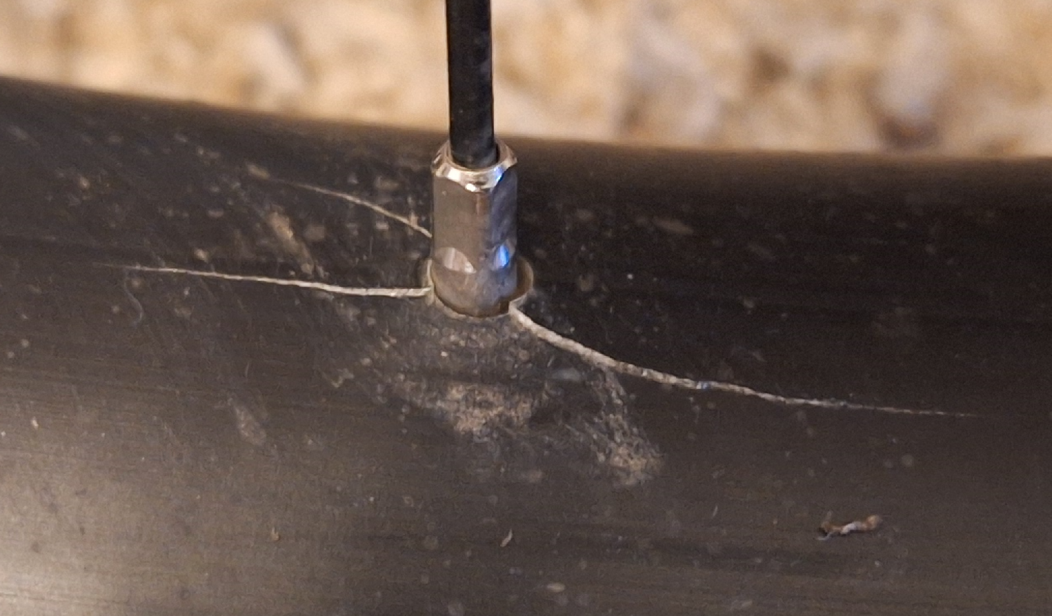

Cracked Allant rear rim

In case you were wondering. I'm taking the 'high road?'. Farming this out is too much work. I'm kinda curious anyway. So, disassembled the wheel, learned a few things along the way.
Next task - determine ERD, order up a rim and a few more tools, and attempt a rim swap. Assuming the hub looks good when I get in there - saving that for tomorrow. Either way, I'm building this.
Among early observations - this rim is poorly built. Not only is jagged machining crust left on the holes, but I found a couple sharp nipples - apprentice marks 🕵️‍♀️
Ever wondered how you got a flat but didn't run over anything?
I almost never use power tools on bikes, but this is one place that it just works. Super slow and low power mode of course.
Almost never use a flathead driver on, uh, anything either. This gets the nipples off pretty easily after a few turns from a spoke wrench to zero the tension all the way around
