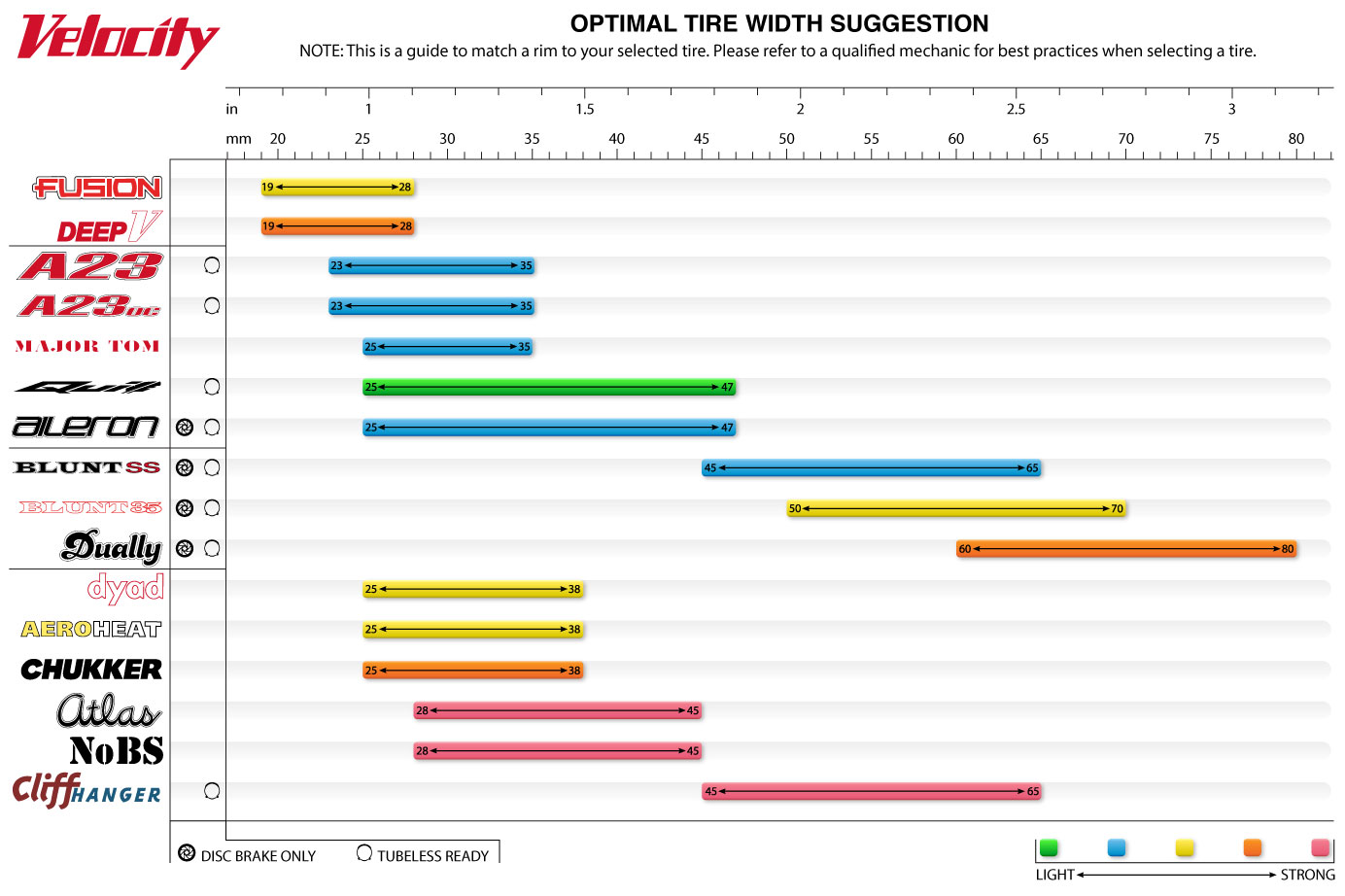

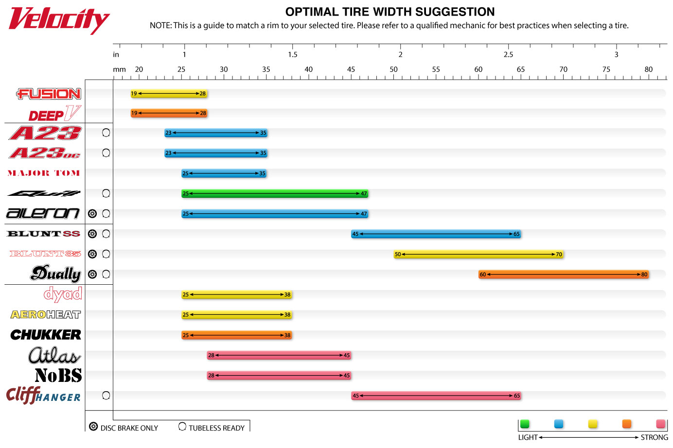

I want that wide of a rim. Those wide tires slow the bike down way too much I gained 3mph going to 2" tubeless tires and 8 extra miles of range. .but buy a cliffhanger rim it will go to a 65 tire.

Yeah those aren't as good as Conti/Schwalbe high end ones. Conti Urban Contact 62-584 is 695g weight, Bontrager is 1280g. You're blaming width when the issue is tire tread quality.
I am blaming them for slow because they were slow. I wanted to use them up and I did not want to go with a larger tire and I wanted to go tubeless. the time I use now is 577 thinking of trying these but they may be too light .

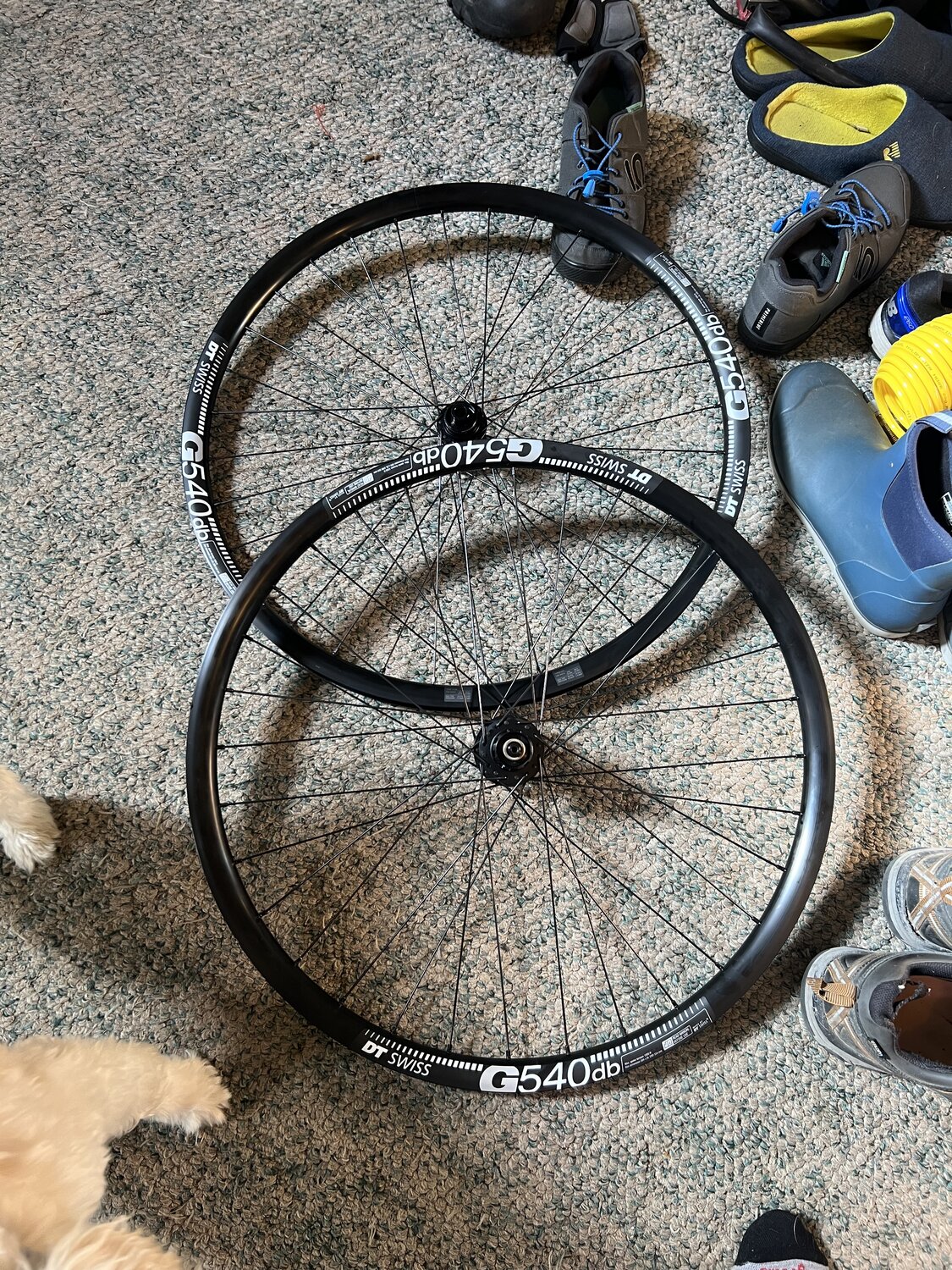

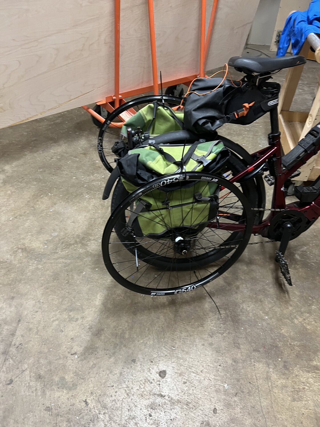

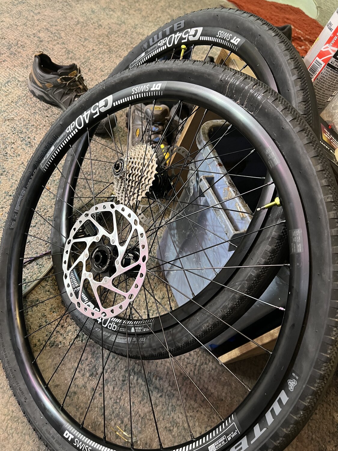

got my new wheels. it was hard to find the dt-swiss 540 hubs with 135 packing and qr endocarps plus 6 bolt disc mount. the front was easy I used the center lock setup there.

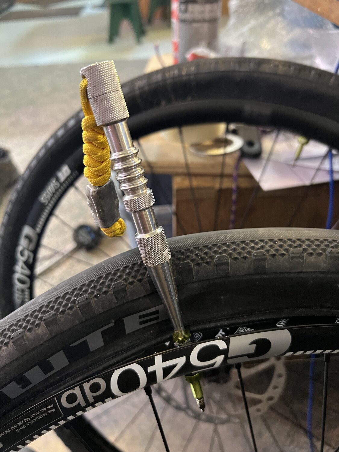

found a great tool for pushing the valve stem in though I couldgetthese tires on the other rims by hand I needed the tire jack for the last part on these rims.

crap I goofed on the front wheel the through axle is 15mm not 12 time to take it back and swap endcaps. uug.
it shows tubeless on the specs. but it cracked before I went tubeless. I ran the stock tires at 50.
You're right - it does. Not much info from Alex, but they do indeed call it tubeless ready.
And strange you didn't get all the endcaps. Every wheelset I've ever bought came with all the adapters.
my builder just swaps them the hub does not come with a full set. he really had a hard time finding the 135mm qr endcaps they are about history. anymore its pointless to make bikes without through axles. my daughters 600.00 trek came with them.
