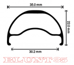

Almost every wheel I have built (9 of 11 so far) have not had eyelets. I typically try to use velocityusa rims but have used WTB rims as well. Due to my weight, I go with max spoke tension of 120-130kg. No issues yet.
Google searches will show that opinions are all over the place on this issue.
A rim like the velocityusa blunt35 as can be seen from the picture is reinforced around the spoke holes. This is a super popular MTB rim.
Seems like eyelets may be a way of being stronger for less cost (not always though)

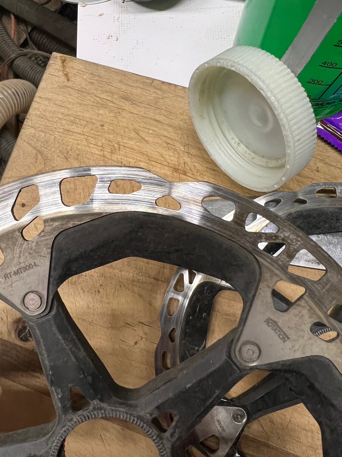

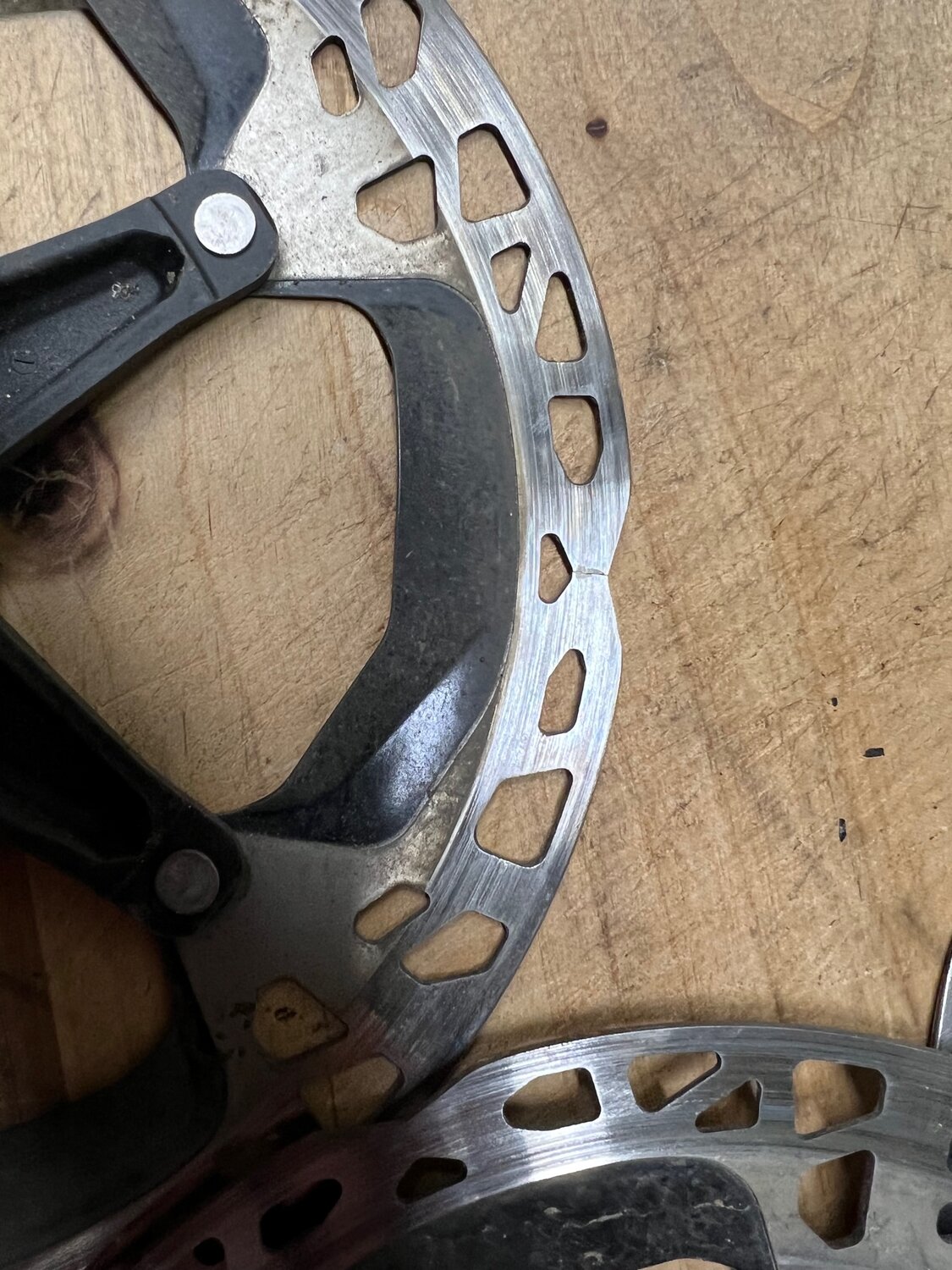

now speaking of cracks this guy is at 1.53 so almost gone but it is overheating and it cracked.
Is that off the tandem? I have never seen a rotor so baked.
ya. I think its baked because its so thin. I never had overheating on the front and we have not done any long descents in months. the worst was a 22% grade but it was only 3 blocks.
22% grade
But that is say, 6 minutes of bake time. Think of how long and how much pressure it takes to light a farmer's match. You had enough heat to discolor the stainless! It must have been glowing. Wow. I do downhill runs much slower than my buddies and I pump the brakes allowing a little air to reach the pads several times each minute. 22% is huge. I have seen the photo. Now I wonder about the wheel rim. Could it have been extreme braking force on the hub and spokes that cracked the rim?
