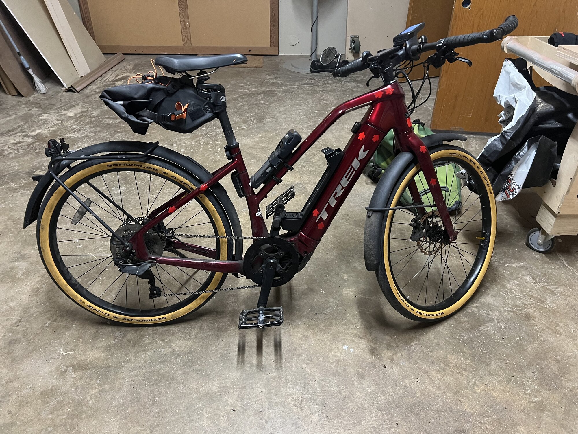

all up and running
just got my new tubeless tires onto my allent 8. a huge difference in ride quality over the stock 2.35" tires. at 60 psi they are as smooth but they are so much faster. acceleration is much better closer to my older bosch power bike with smaller tires.
@fooferdoggie did the shop say anything about compatibility between the 35mm inner rim width and the 2.0” tire? I just ordered the same ones to try it out but am now seeing that 2.0” is on the edge of compatibility for a rim that wide.
no but it seems to work. it is tubes so the side walls are stiffer on the tire. all I can find is for mountain bikes because its a rim for such bikes. hell it seems even the 2.35" tire the bike came with is not bug enough. but since this is not a off road tire it maybe fine. its nice and round as you see. my mechanic did mt say anything and he loved the ride.
Can't wait to hear what you think of them long term. 60 PSI though - that seems lofty for a tubeless setup. Also seems like it would be a harsh ride.

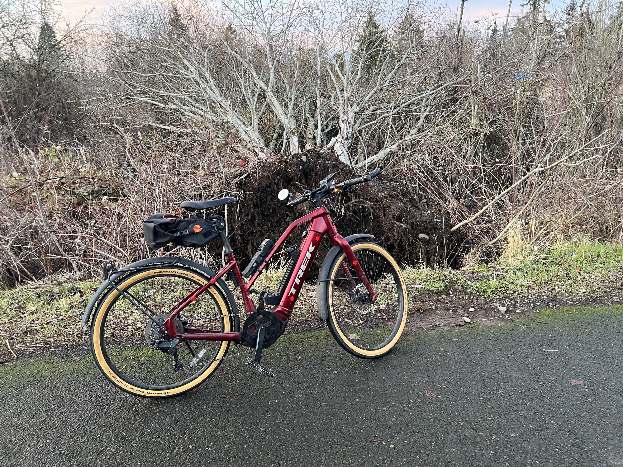

I went on a 30 mile ride at 60 pis they may be the same or a tiny bit stiffer than the stock tires. at 50 they are a little more cushy. I wanted to see how they felt so much more silly and I tended to be about 2mph faster on them. but I think I may go back down to 50 psi. I was so fast I knocked over this tree. they max out at 65 psi.

whoa. please check the max pressure for those rims at that tire size. 60 psi tubeless on a 2” tire seems insanely high. the rim is often the limiting factor for tubeless, not the tire.
I totally agree. Two 2" (tubed) tyres I use (Electrak 2.0 and Marathon Winter Plus) allow to be ridden from 36 psi, still with tubes! I typically ride them at some 40 psi. With tubeless, lower pressures are allowed for the tyre size of 2".
