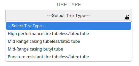

I calculate pressure in my tires based on tire size/width, surface and weight - nothing like
avoid pinch flats
is taken into account. Tires pressure calculators doesn't even separate tubeless and tube setup:
In my particular case the suggested pressure is 10psi higher than the lowest my tires allow. So the limit is not due to the tubes, but due to the weight.

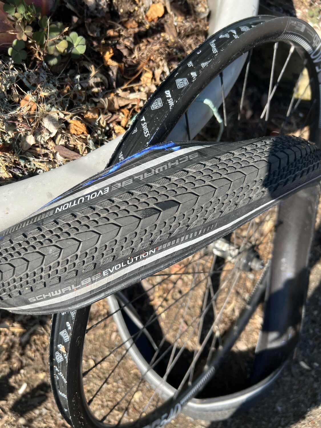

the tires I am getting say 10 psi lower for running them tubeless. my DT-swiss rims are 80 psi for tubed tires 59 for tubeless.
